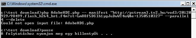

    I have problems with step 4. (I have never used php scripts and cmd.exe, so please be patient...
    I copy the url and...?
    -> paste to notepad: the other words (-- manifest, pause - where are they come from? - should I write them into this txt?
    -> I saved this txt in .bat extension (after I've written down the "extra words")
    with the name that you showed me in the picture: "AdobeHDSdownload.bat"
    -> double click, then I get an error message

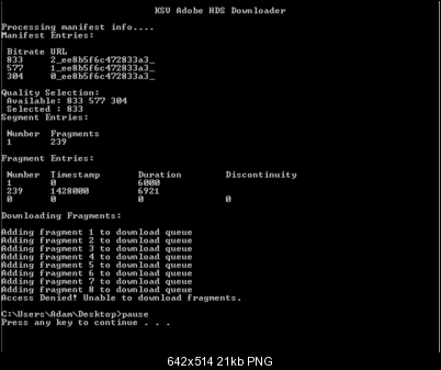

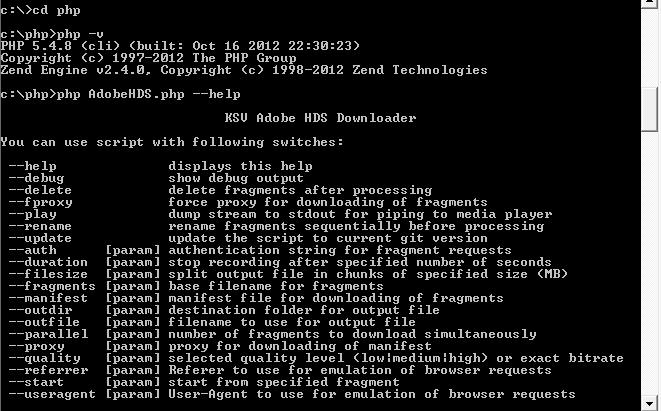

  2. Ok first of all check you have PHP installed correctly and that you've downloaded the AdobeHDS.php script and that it has a .php extension -
    copy the AdobeHDS.php script to C:\
    open a command window (Start > Run > Cmd from Win XP)
    type cd c:\
    type php -v - you should get a result like PHP 5.4.6 etc (or whatever version you're using)
    type php AdobeHDS.php --help - you should see the message "KSV Adobe HDS Downloader" and a list of switches
    These are the steps regarding Notepad:
    1) Open Notepad
    2) Type the following lines -
    php AdobeHDS.php --manifest "your_manifest_url" --parallel 4 --delete
    (replace "your_manifest_url" with the URL you obtained with URL Snooper)
    pause
    3) Save the file as AdobeHDSdownload.bat - note the .bat extension is important - this creates an MS-DOS Batch File which can be executed like a program
    > Notepad > Save As > Save as type > All Files (from drop down menu) > File name: AdobeHDSdownload.bat (note: must be placed in same folder as AdobeHDS.php script)
    Notes:
    --manifest - this is a switch that tells the AdobeHDS downloader script that the following text is the manifest URL (i.e. .f4m)
    --parallel 4 - optional, tell the script to download 4 threads at once (speeds things up a little), can change to whatever you like
    --delete - also optional, this tells the script to delete all the fragments after it's joined the video together (if joining fails for some reason this switch will be ignored)
    pause - this is simply a command that tells the MS-DOS batch file to pause execution - also optional, I usually include it to check that everything has worked ok otherwise the CMD window will close immediately it's finished - if theres an error you won't get a chance to read it. Pressing a key will continue execution (and in this case the window will close immediately afterwards)

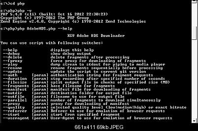

  3. Originally Posted by Chug a Bug View Post
    hope that helps
    It is almost OK…
    I made a c:\php folder.
    I extracted here PHP 5.4 (5.4.8)
    I saved here AdobeHDS.php
    I saved here the .bat file.
    I checked - PHP installed correctly.

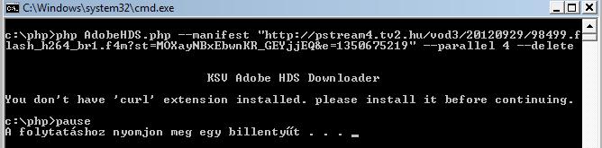

    But when I double clicked my .bat file, I got this error message:
  4. Make sure you're using the PHP.ini as supplied in KSV's post in his thread as it unlocks all the functions. Alternatively theres something missing from your PHP install, check you have a php_curl.dll in your php\ext folder
    If that doesn't work try this, it's my php install : unzip and copy the PHP.ini file from inside and overwrite yours. If it still fails copy everything else inside the .zip and overwrite everything in your PHP folder and try again... don't forget to reboot
    php.zip

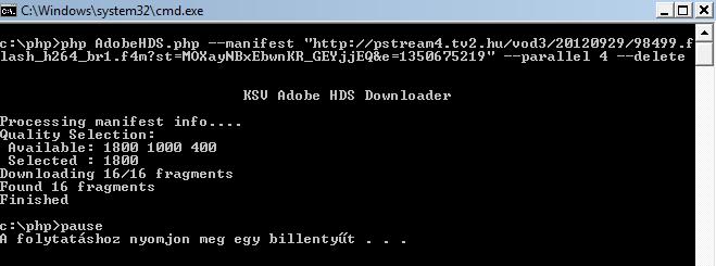

  5. Originally Posted by Chug a Bug View Post
    Yes, I forgot copy PHP.ini to this folder...
    But now IT IS WOKING!!!!!
    Thank you very much!!!!
    Here is my first .flv joined video:
    Name:  adobe ok 02.jpg
    Now I have an extra question:
    If I have more "manifest_url" how can I download them together?
    Can I put all my links to a .bat file?
    (You know it will be faster than one by one)

  25. Is anyone able to get AdobeHDS to work with pluzz.fr these days? I was able to get it to work about a month ago but now every time it says ""Access Denied! Unable to download fragments" It even recognizes the the three different qualities before failing. I've no issues getting the auth, manifest, useragent, etc. Maybe the weirdest thing is that I was able to download the fragments and AdobeHDS won't even join those.
    EDIT: Usually it just stops when trying to select the Quality, but one time I was able to get past that and apparently get a few of the fragments at least queued up.
    Attached are the debugs
  26. Havn't seen that one before, at a guess I'd say the authorisation times out rapidly.
    Probably best to ask the script author over at http://stream-recorder.com/forum/
