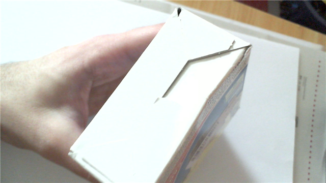

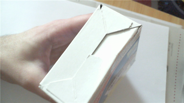

    The colors in the upper shot look more "natural" to me. Are they the "real" ones? I have little way of knowing.
    White balance on the upper tends toward the yellow, whereas WB on the lower tends to either neutral or blue. How was it shot?
    Although, I will say that the lower shot seems to be "blooming" (aka high luma values are blown/clamped).

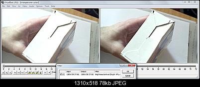

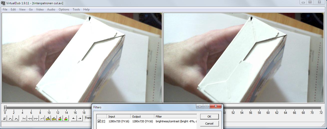

    Gottcha! Tried many things before but not this one: Opened the original in AviDemux and exported as Jpg-Sequence. Result: Nice looking frames! So, again, who is wrong? This is just M-JPEG, so why are the decompression results so different between avidemux and vdub?

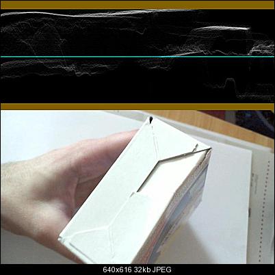

  5. None of the above are necessarily "correct." You're looking at an RGB represetntation of the Y"CbCr data ( your original mjpeg is in Y'CbCr colorspace) . How that software converts to RGB for display, or any filters, will affect what you see on the monitor or any display
    For example, in MPC, change the renderer to vrm9 (renderless) close it, reopen the video . Or try overlay mixer. It will look different, but the underlying video is the same
    Graphics card settings for overlay mixer can affect how it is rendered. For example, if you have directx enabled in the vdub options, the output pane will rely on those settings you specify. If you turn directx off, it will look different.
    Some decoders will clamp or clip to Y' 16-235 (or legal levels) while others will let it pass through. So you lose your superbrights in the former, but not the latter (which then can be recovered) . How the RGB conversion is done might also clip the data
  6. Start VirtualDub and select: Options -> Preferences -> AVI (left pane) -> and enable "Prefer internal video decoders..." and Options -> Preferences -> Display (left pane) and disable "Use Direct X for display...". Exit and restart VirtualDub for the change to take effect. That will bypass the graphics card's video proc amp settings which can cause brightness and colors to be rendered incorrectly.
    Now go to Video -> Color Depth... in the Decompression format specify 4:2:2 YCbCr (YUY2). Save that as the default.

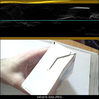

    That pariticular video has luma (brightness) values above the standard max of 235. That is causing the blown out whites. The black level may also be a little to high (it's hard to tell because there aren't many dark areas). In recent versions of VirtualDub apply the Brightness/Contrast filter before any other filter to bring it down. Set Brightness to about -8 percent. That will bring out a little more detail in the bright areas:

    Of course, you can go darker if you want. But that 8 percent will get you into the legal luma range. It's important to do this first in VirtualDub because the Brightness/Contrast filter can work while the video is still in YUV. Once it's converted to RGB (most other filters) the highlights will be lost and irrecoverable.

  8. MPCHC clamping the levels to 16-235 Y' in the output pin (ffdshow and internal mjpeg decoder does this for mpchc) so when the Rec709 conversion is applied , Y'CbCr [16-235] => RGB 0,0,0 - 255,255,255 . Thus you see no clipping, because the decoder squeezes the info to 16-235 Y' before the RGB conversion for display . I mentioned earlier some decoders squeeze to 16-235, others output 0-255 Y' from the output pin.
    Vdub is preserving levels, but you didnt correct Y' overshoots and probably forgot to use fast recompress. This means you incur rec601 RGB conversion (you lose Y' <16, Y' > 235 before you export) . This is a clipping (so data is lost). But even if you used fast recompress, h.264 doesn't get clamped by MPCHC unlike MJPEG (levels are 0-255 in the output pin before the RGB conversion for h.264), but the rec709 conversion to RGB for display causes the clipping h.264. The difference is MJPEG is clamped to 16-235 Y' before the RGB conversion with MPCHC, but h.264 is passed through with levels untouched
    In jagabo's example, he brought down Y' to legal levels before exporting, so when you incur the RGB conversion in MPCHC, you see the details in the box

    There's no such thing as an "untweaked picture". You are dealing with YUV video. It has to be converted to RGB for display. Those YUV values can be converted to RGB in a number of ways. You need to use the right way. And of course, if your monitor isn't calibrated nothing you see will be correct.
    If you don't apply the Brightness/Contrast tweak you will be seeing what properly operating players will display (aside from any calibration issues with your monitor). The yellow cast in your MPCHC image is because your graphics card's video proc amp settings are incorrect. Or you're using MPCHC's internal proc amp to change the colors.

    You need a waveform monitor that operates in Y'CbCr to see what levels the data is at, but even before that, if you choose 1 decoder or another, the levels might be different.

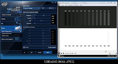

    Video proc amp? It's a screenshot (copy from screen memory), not a photograph of the screen. The screenshot of MPC should only show that it can't be correct what is displayed by vdub. If information was lost, it couldn't be recreated by MPC in any case.
    Since you already know everything I shouldn't have to explain this to you.
    A screen shot is capturing RGB from the graphics card, not the original YUV video. When using video overlay (or the myriad of other video renderers available in Windows) the media player is sending YUV to the the graphics card. It's the video proc amp settings that control how that YUV video is displayed on the RGB monitor. If your proc amp settings are incorrect (and it's very common for the defaults to be wrong when installing graphics drivers) the player will display the wrong colors.
    Beyond that you have other issues. If the YUV matrix isn't flagged in the video most players will assume rec.601 for standard definition video, rec.709 for high definition video. What happens between 720x576 and 1280x720 is player dependent. Some will use one matrix, some the other. (And some player even ignore the matrix flag, always using a particular matrix for the conversion.) VirtualDub always uses the rec.601 matrix to convert YUV to RGB. But that is wrong for HD video or video that's flagged as rec.709.

    No you don't. You usually want to correct levels (bring them into legal range) , so you preserve that detail on any player, any program, all hardware
    The reason is most software, video players, TV's will use Rec601/709 for conversion for display. So even if you have data in Y'CbCr in the "super" range , when it gets converted to RGB for display, it doesn't appear in the display (i.e you don't see it, but that data is there!)
    Rec601/709 Y'CbCr=>RGB conversion means only that data between Y'16-235 will be seen. All that other data Y'<16, Y'>235 will not be seen. But if you bring that data back into legal range, then (almost) everything will be seen
    The reason why opening the native video in MPCHC shows all the detail (for example the lower box folds , ignore the color differences for now), is because the directshow MJPEG decoder clamps Y' to 16-235 BEFORE the RGB conversion. So (almost) everything is seen

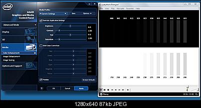

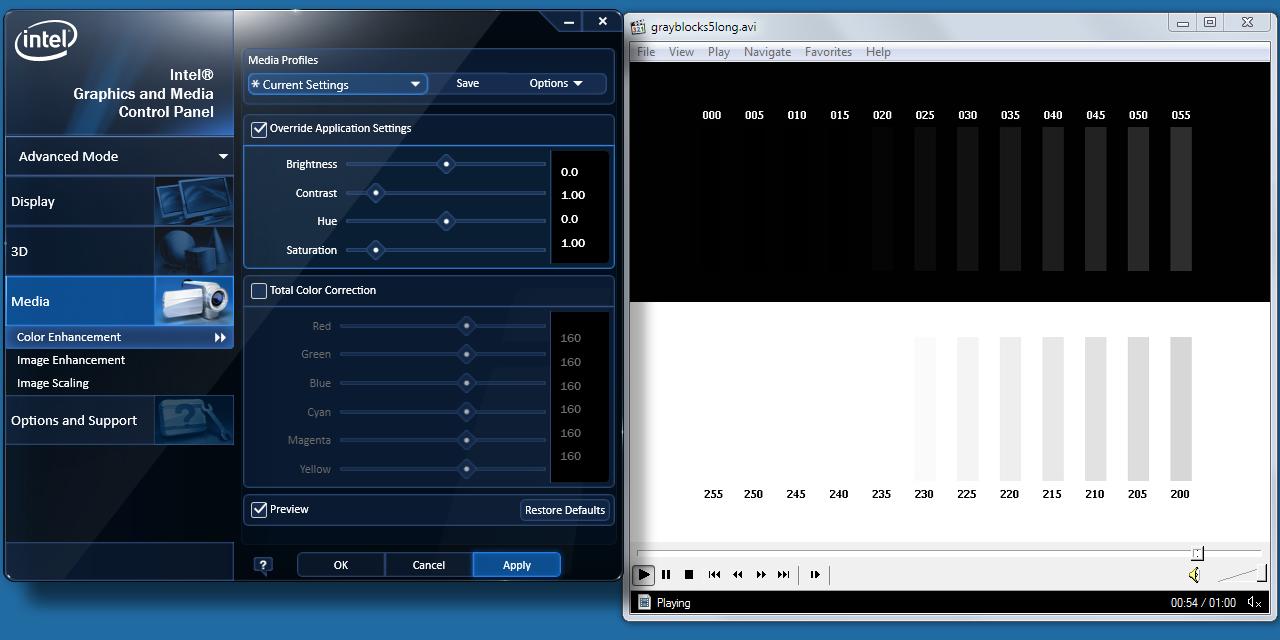

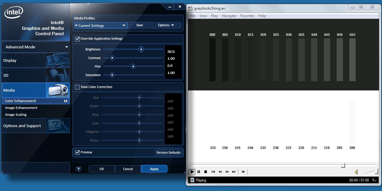

    Sure you can. Just fix your graphics card's video proc amp settings. Your graphics card has two proc amps, one for the Desktop, another for video.
    Normal proc amp settings:
    Way too bright proc amp settings:
    The video proc amp settings have no effect on VirtualDub's display when DirectX output is disabled. Because VirtualDub is performing the YUV to RGB conversion when you do that. If you want another player that's immune to proc amp settings use VLC with the output device set to Windows GDI.

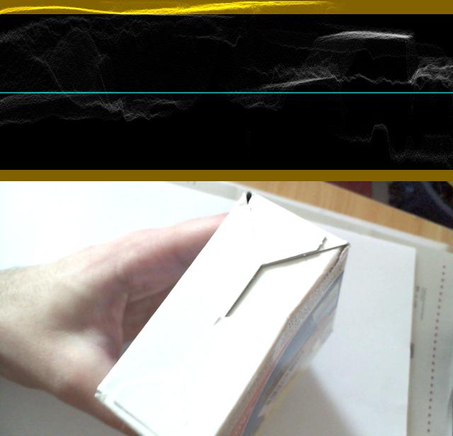

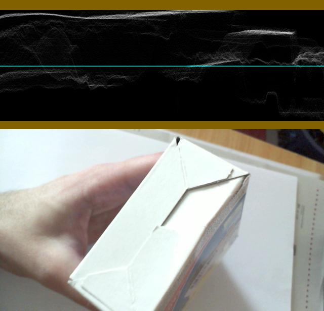

  19. Originally Posted by CryGuy View Post
    At least I can tell by comparing vdub and mpc that vdub obviously does not show the best representation of whats stored in the file. If it would, some information (see the edges in the middle of the box) wouldn't exist in the file. MPC prooves the opposite because it can't recreate what's not there.
    The principal reason for the observed levels was explained earlier, the output pin of the decoder.
    MPCHC, VDub, as "showing a represenatation" - they are meaninless unless you specify what decoder, what renderer, etc... because different decoder choice will output different levels ... but you know this
    In this example, both screenshots were taken with vdub, both using rec601 conversion

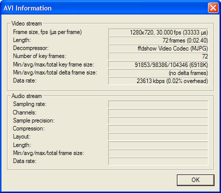

    The difference is different decoder. FFDShow VFW Mjpeg decoder outputs levels clamped to 16-235, but Vdub's internal Mjpeg decoder outputs levels untouched 0-255 Y' - all this BEFORE the RGB conversion (but you know this , I'm just explaining for other people who might have same question)
    Use vdub file=>file information to see the decoder you are using when video is loaded in vdub
    (images resized for display purposes, make sure you view at the same level in the browser, or save images to desktop and flip back & forth)

  20. MJPEG is different than most video codecs. It usually uses the PC.601 matrix because JPEG stills use that. That means that MJPEG should have the luma range compressed from 0-255 to 16-235 before encoding as MPEG, Divx, h.264, etc.
    Some decoders and conversion software account for this, some not.

    Avidemux uses ffmpeg decoder for mjpeg. Translation: Levels are untouched, 0-255 much like the vdub internal ffmpeg decoder in the example above
    So if you encode using something like x264, xvid without any filters, levels will be identical to original, Y' 0-255
    In other words, when you play it back in any media player, you will not see the detail from 0-15, 236-255 (e.g. the box folds)
    But if you "legalize" the levels to Y' 16-235 with a filter, then you will see the details come into view similar to the ffdshow picture when playing the Y'CbCr export in a media player

    The reason for your avidemux bmp observation was explained earlier
    Y'CbCr gets converted to RGB with a Rec matrix , so Y' 0-15 and 236-255 get clipped (i.e. 0-15 becomes all black instead of seeing gradations, and 236-255 becomes all white, instead of "shades" of white) . That's why you don't see a fold
    "Correct" matrix is all relative. If you wanted 0-255 Y' to 0,0,0,-255,255,255 RGB , that would be a PC matrix, not a Rec matrix . Rec matrix converts 16-235 Y' to 0,0,0-255,255,255, so you don't see those values 0-15, 236-255. I feel like I'm repeating myself
    Maybe we have done a poor job explaining this. If it still doesn't make sense I can make some other examples and waveforms
  28. I do believe you, but I'm surprised that a H.264 encoder doesn't always output TV levels. I thought it violates the standard it's made for. Instead, we must adjust the RGB to TV level before encoding to ensure TV level in the target video? Well, in that case, I've really learned something new.
    When you are feeding Y'CbCr material to most encoders, there is no intermediate colorspace conversion (you're not converting to RGB at the encoding stage) . So input = output levels. The difference is most DEcoders will use Rec matrix to convert to RGB for display - so if you don't legalize Y' values, you won't see 0-15 or 235-255. They will be a big black bar, and a big white bar = no details . In Y' => Y' there is no information lost, except when you apply lossy compression. In fact, when you encode using h.264 or xvid, the information is still there, you are just not seeing it when it gets converted to RGB for display. I have a strong feeling you're not understanding what was being discussed earlier. You wouldn't be asking these questions.
    In your original file , you have values that are superwhite. Normally white is Y' 235. But you have values greater than that. If you don't legalize values, they will clipped upon display by the RGB conversion
    BMP's are RGB. So in the case of avidemux you are converting to RGB with a Rec matrix. You don't have control over this conversion in avidemux, but you do in other programs like avidemux. If you wanted to map full range using a PC matrix for example.

    The job of a codec is to reproduce what you give it, not fix your video for you. The super blacks and super bright regions are available for occasional overshoot, to prevent ringing from hard clipping, not for routine use.
    Here's a waveform (brightness) graph of your video:
    All that yellow stuff in the brown bars is not supposed to be there. The brightness should be lowered it below the brown bar:
    Notice how you can now see details on the bottom of the box? You have a color problem too but that's a different issue.
