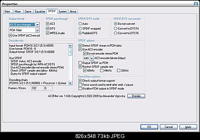

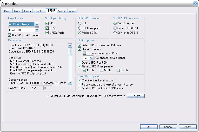

    After a bit of online research, I found that the AAC format needs to be pre-processed to AC3 by the computer, then it will be decoded by the receiver as Dolby Digital. I set this in AC3Filter as shown:

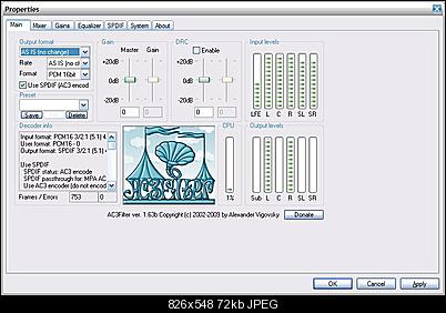

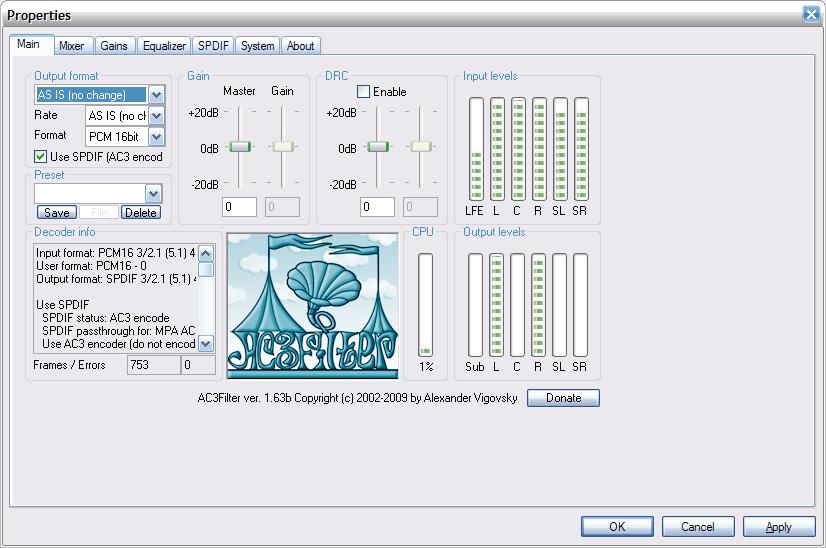

    When I playback a movie with AAC audio, it shows AC3Filter is in use re-encoding the AAC to AC3:
    My receiver says "Dolby Digital" while this is being played back. However, as you can see in the input / output graphs above, it shows the 6 channels going, but only outputting 2 channels. Also sound on my receiver only comes out of Stereo left and right. It makes no difference if I choose 5.1 or "AS-IS" from that drop down menu on the Output part of the above pic, it still only outputs it as stereo.
    Anyone have any insight on this? Why wouldn't AC3 filter keep and output all 6 channels?
