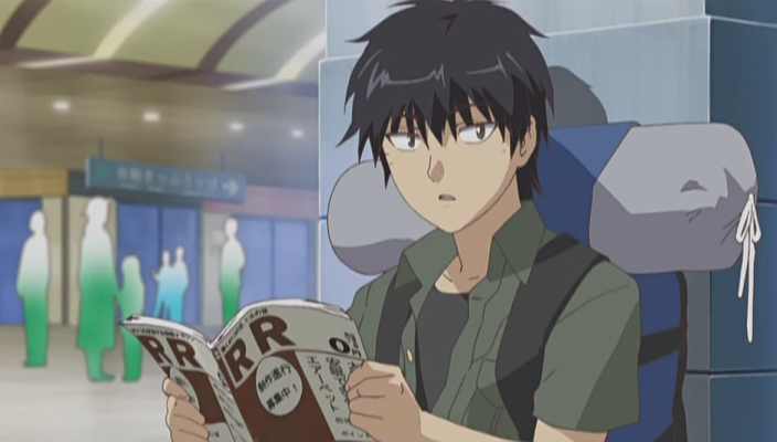

  4. Anime / Cartoons are VERY EASY to compress. Reasons:
    1) very static (eg. mouth is moving but rest is static)
    2) characters and backgrounds are not very detailed (mainly flat areas)
    You should try latest RipBot264.

  5. It also depends on the source material. Things like noise, dirt impair compression. CGI type animation is harder to compress, because there are more details
    If it's "clean" simple animation , then yes, it's easy to compress . If it's older animation or "dirty" , then you often have to do some filtering before encoding
