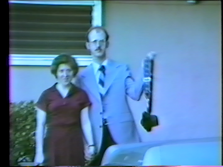

  1. Hi all, this is my first post. I have about 20 home VHS tapes I'm hoping to archive (just on the computer, not to DVD). I just bought a Canopus ADVC-300 and I am borrowing a JVC SVHS HR 4600U (beggars cant be choosers) and I'm using my decently calibrated 1 year old Samsung 46" HDTV as my computer monitor and TV .
    Anyway, I use Adobe Photoshop CS5 and its remarkable how the auto color can fix picture color. Sure I dabble in manual color adjustment but I find the auto color works pretty well 90% of the time and when I'm trying to fix tens of thousands of pictures, I just don't want to mess around with them all if I don't have to.
    I was just wondering if there's any program that's based on similar algorithms that can fix all the frames in a video? I figure with a 6 core processor and the fact that these frames are 2/3rds of a megapixel, it probably wouldn't take too long for the processor to do it, provided there was software available. If it doesn't exist, hopefully some of the programmers can figure out how to make a Virtualdub filter for it or something because that would ROCK.
    USA
    If they all have the exact same color errors, you can just tune one of the filters like Color Mill 2 or similar and process each video, leaving VD running in between. Or note down the filter settings. But generally, unless all the videos were shot with the wrong color setting, florescent instead of incandescent or natural light, I doubt you can do automatic correction. And if you are going to filter, there may be other non-color filters that would help with VHS video.
    Also, a bit more advanced, would be a AVISynth script so you would have full control over the filtering and have it easily repeatable. But someone else would have to advise you on that.
    And welcome to our forums.
  3. Yeah, I think for the most part they're ok, the main one I'm worried about is my parents wedding video which will be 32 years old Jan 18th. It's got all kind of bizarreness going on. The Canopus allows you to fix some stuff in analog before converting to DV, which is nice. It seems like there are certain segments with certain issues so it takes some patience to stop and go and adjust and go back and recapture with the new settings. Even after all that, it's still pretty limited. Plus some segments have double hue problems (ie one side is green and one side is purple) so I'm scratching my head on how to fix that. I'll see if I can try your suggestions for further refinement using lossless transfer I suppose. Avisynth scares me though. I see that there is some stuff I can do in Adobe Premiere although that's going to require a lot of patience too. Oh well, that's half the fun.

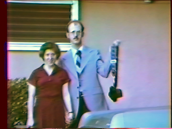

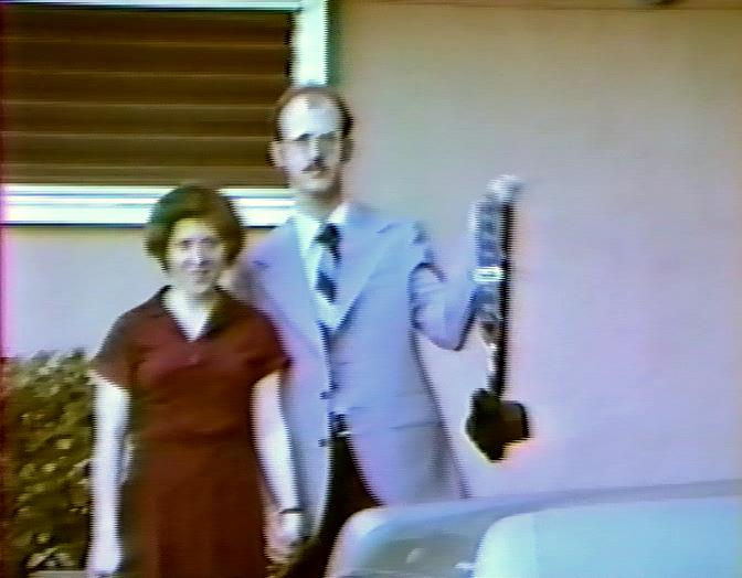

  4. I did about 10 frames just to see what it would look like, this one is nice to fix since it's all blue.

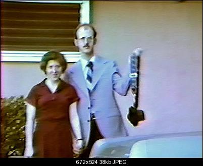

  5. You're looking for an auto white balance filter (and maybe auto gain too). Beware though that automatic filters like that can cause colors to wander as the picture content changes. And you may want to crop away the black borders first because they can confuse the automatic adjustments.
    Your first image after auto white balance and auto gain with AviSynth's ColorYUV():

    If you lose your fear of Avisynth, try
    ColorYUV(autowhite=true, autogain=true)
    As jagabo says, an automatic filter like this is not a wonder cure, but it should get you something acceptable as a starting point for further manual tweaking.

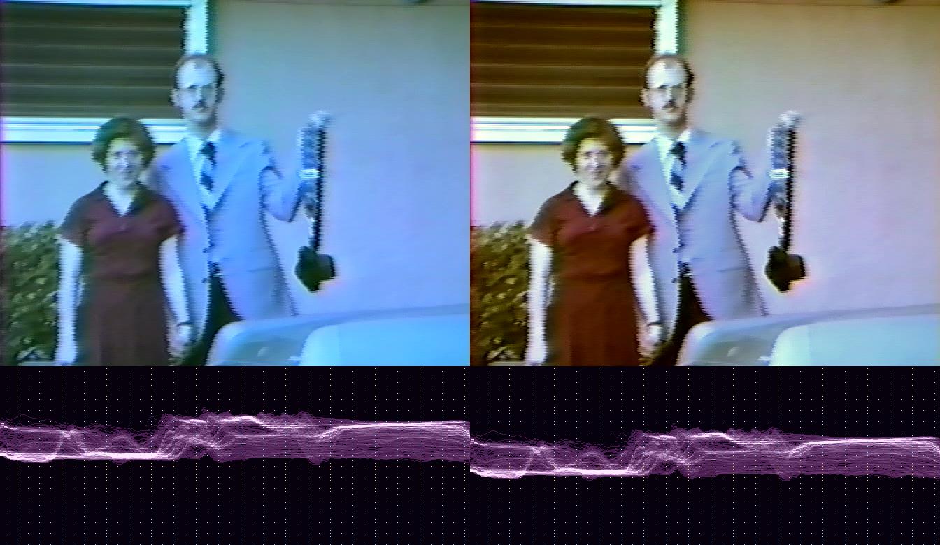

  7. If you find the colors and levels wander around too much you can find a frame where they worked well and analyze what the adjustments where made automatically. Then try using those fixed adjustments for the rest of the video. For example, your sample image had the U channel pulled down by about 24 units:
    It's not shown here, but the V channel was pulled up by a similar amount, and the contrast (Y channel) was stretched.
  8. Member Cornucopia's Avatar
    That's certainly looking better, but note that it looks like you also have timebase errors that need fixing, and that's best done with an external TBC box (in the chain between the VCR and the ADVC300). It nigh impossible to fix that after the video has been digitized...
  9. Originally Posted by Cornucopia View Post
    That probably is the case but... The camera was moving sideways during that frame and the interlaced frame was resized vertically (notice it's 720x540) without accounting for the fact that it was interlaced. That's the main cause of the wavy verticals.

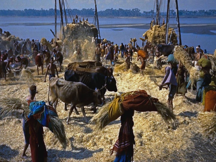

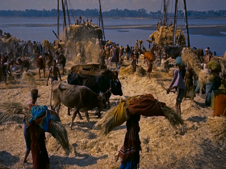

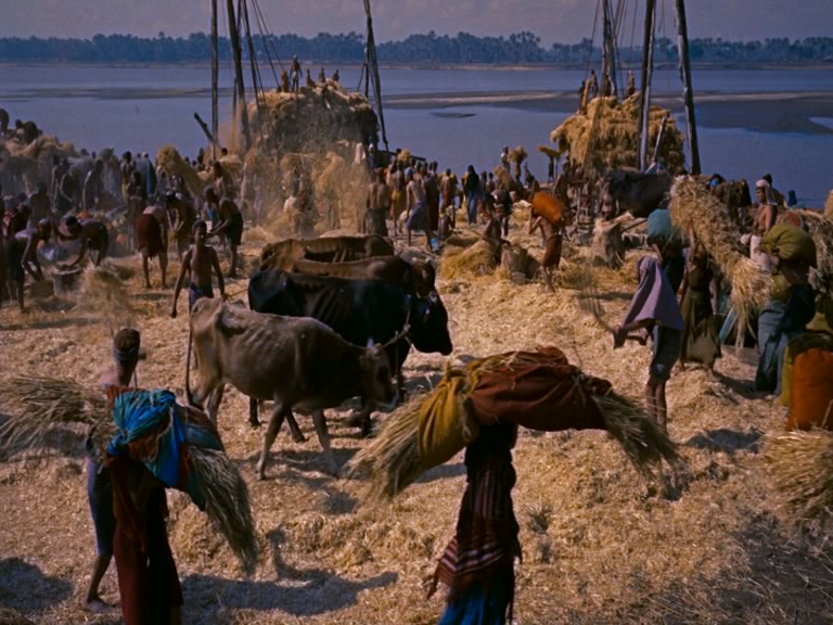

    Viewed with a histogram, your original capture shows more problems than you can shake a stick at. It's not just color balance. There's severe chroma bleeding, chroma noise, magnetic layer damage and fading, etc. Much of this could be repaired in Avisynth, but before converting to DV. A simple Blue gain adjustment with ColorYUV would have helped immensely with Blue and red before going to RGB for more precise corrections. The histogram shows overextended blue, fading green, and crippled red. Keep in mind that AutoColor is also reading the black borders and border stains.
    [Attachment 10399 - Click to enlarge]
    A histogram of the filtered image shows blue is still a problem, but not the only one. As for the chroma noise, bleed, etc., there are Avisynth routines that can help alleviate much of it - though this video is in bad shape, it could look much better worked in AVI. I've used scripts that fixed some similar border stains. Overall, the photo is still too blue. There are no blacks, grays, or clean whites, and skin tones are off. I didn't try fixing any of this: color damage in compressed DV is almost impossible to repair.
    [Attachment 10400 - Click to enlarge]
    One thing you can do with AVi captures is to crop the borders and stains so Photoshop can read the image more accurately. In your fix (above) you'll see that Auto Color made a mess of the left border. The histogram looks a bit different with the borders gone.
    [Attachment 10401 - Click to enlarge]
    Crop the borders, replace the old ones with black borders in Avisynth, and center the image in the frame. There are plugins that can possibly help a bunch to clean those borders and save some image real estate for posterity. A curves filter could do a lot of correcting here.
    [Attachment 10402 - Click to enlarge]
