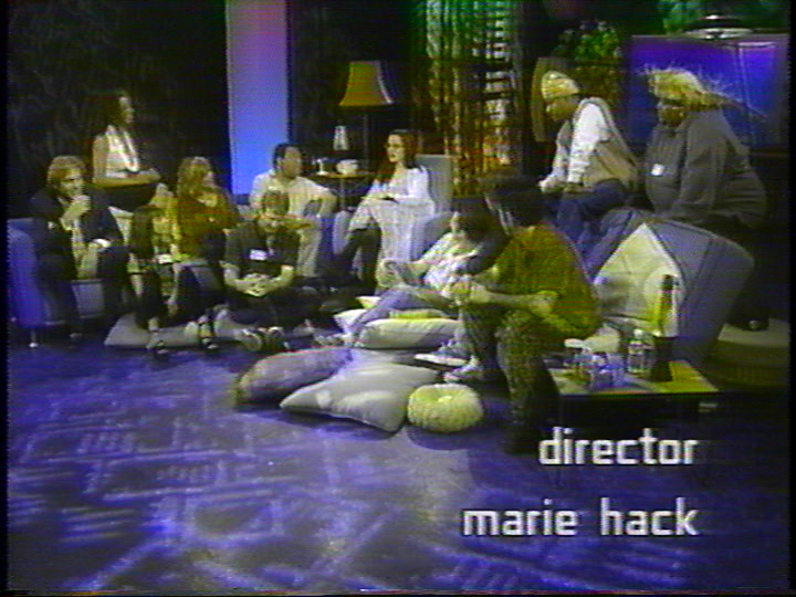

    I have bought a media center device that can record from external sources. I have transfered some of my PAL VHSs (Im from Europe). I also have some NTSC cassettes (recorded from US TVs) and I wanted to transfer them as well. Everything went okay but the colours are off. (I know that transfering of NTSC tapes via PAL device causes troubles like black and white picture but I dont have anything else to transfer these tapes) SO, can anyone help me and tell how to post-process, restore the colours. I can use Vegas. I have attached a screencap of the picture with off-colours. Seems like there is too much green.
ID:	10380Click image for larger version

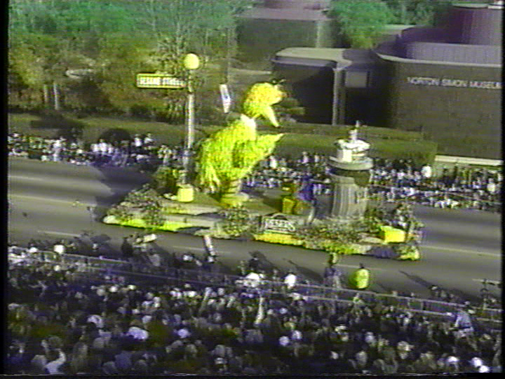

  7. For example, you can use 3-way color corrector or curves in vegas if you feel image has too much green . Or in vdub you can use gradation curves and/or colormill
    You have interlaced chroma artifacts , but that might be a result of the method of taking screenshot (looks like alternating horizontal red/green lines)
    Hard to say definitively from 2 caps, but it looks like the top 20-30 pixels edge is colored differently than the rest of the frame. (There is a demarcation line where trees change color in the 2nd picture). You can use a mask to apply corrective filter

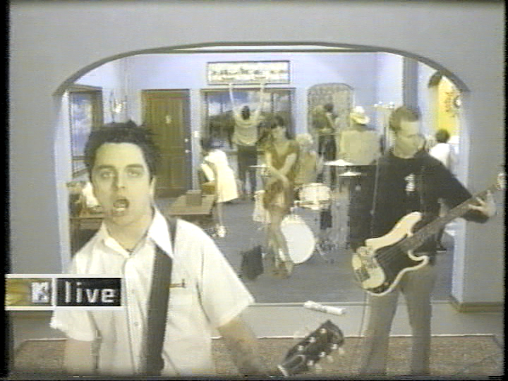

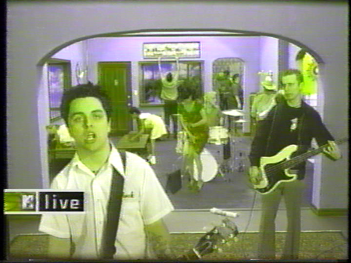

  8. Okay, the line is present only on some of the videos so I would not generalise it.
    Look, here are two screencaps (Green Day music video redundant, the optimal colours can be checked on youtube
    1. The original captured video 2. My On the fly colour/sat correction in VLC
ID:	10383Click image for larger version
    I do not know much about chroma/tint or adding/changing single colours/colours range but it should be possible to tune it better.

  11. I see, If you assume that youtube video is "correct" - and it should be because it's "offical music video" , then you have a guide as to how to apply filters
    Right off the bat you can see it's much more saturated , levels are different, and colors are shifted compared to the "VLC corrected" image . For example, and the "grey" walls are actually more teal or turquoise

  12. Video Restorer lordsmurf's Avatar
    One of the color channels is missing from the tape version.
    The others are screwed up.
    This cannot be repaired. Ever.

  14. LordSmurf is right, the 'v' color channel is missing, which should be fixed in capture somehow. Anyways, there's still a way to fix it to reasonable colors, which will give flesh tones, however some range of colors will be missing.
    cu=utoy
    cv=cu.Invert
    ytouv(cu,cv,last)
    The matching frames from the youtube version are 4645,4646.
    There are better ways to fix this, what you would do is a type of hinted colorization, where luma and U channel give a hint to the true color. I wouldn't want to work on that now, there's hopefully a better fix in capture.
    There's problems with the youtube version as well.
    The hinting I'm talking about would work for color symmetrical about the uv axis.. let me think about this.. anyhow it would be a slightly better version of the simple script I made. It would actually work well for this video which has a limited palette.
