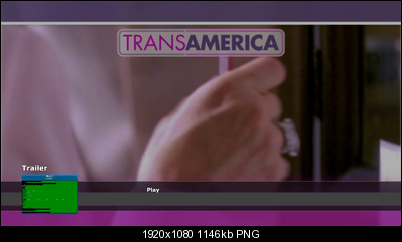

  1. So I'm trying to put together a Blu-ray and am having big problems with the menu.
    The menus are full motion but there are thumbnails for each part of the disc.

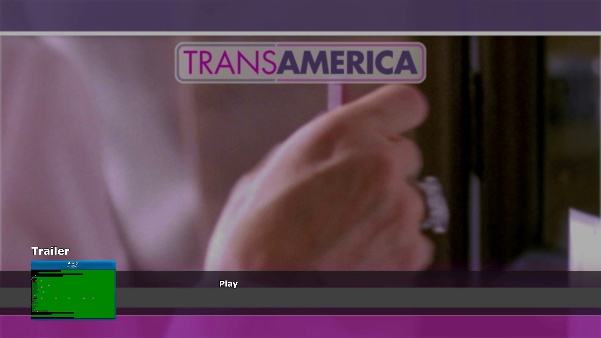

    The film menu item works perfectly but anything that's not in HD has this weird green effect in the picture.
    The items play pefectly fine and aren't re-encoded. Any thoughts?
    Here's an example:

  2. So I'm thinking this is a problem with the way it's processing MPEG-2. I tried reinstalling the codec but it's still having problems. I am going to try and re-encode as h264 and see if that changes it.
    Why would that be it...if it's the codec?

  4. Unfortunately, Dean isn't responding to my emails...
    So it seems I'm pretty much screwed if I ever want to use SD material on a BD.
    I'm currently re-encoding to H264 in the hopes that it will work and it's just an mpeg2 problem. I just have no idea what would have caused this issue.
    ****Looks like there's no problem with it once it's been converted. It clearly has a problem with mpeg2 and I have no idea why. What a pain.

  7. You know what? It's not MultiAVCHD.
    I went into procoder and I got the same look. Now I'm *REALLY* confused. What would cause something like that?
  8. So it's not MultiAVCHD's fault! I updated my video drivers and PROBLEM SOLVED!
