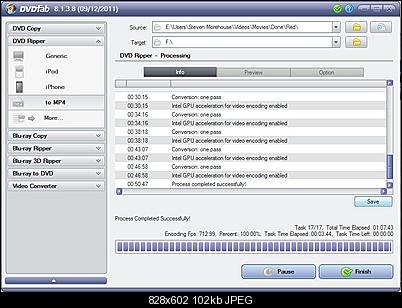

  1. Hi. Sorry for my first post being a frustrated one. I've been at this forever and can't figure out what the issue is.
    I have a DVD collection and I bought an Asus O!Play media player as well as an Asus Transformer Prime tablet. The intention was to rip my DVDs and convert them to a single format that will play WELL on both devices. I don't get what I'm doing wrong.
    First off, I got a 2600K based system so that I could take advantage of Quick Sync so conversions wouldn't take forever. I am impressed with the speed... but the results have been crap. I finally found a setup that seems to work sometimes, but invariably there's at least some part of the movie that goes really choppy - kind of like its stuttering. I'm not being just picky - even the least videophile among us would complain.
    Turning on 2-pass in DVDFab solves this issue. But turning on 2-pass negates the use of Quick Sync! The conversion then takes 2.5 times as long (plus it then feels like a HUGE waste of time and money buying a new system). I can keep QS on and solve the issue if I put the bit rate above ~10,000kpbs but that's ridiculous - the resulting files is 2-3 times the size of the DVD!! I've tried other software packages besides DVDFab, but I'd prefer to use that one AND every other one I've tried has either been the same or worse.
    Is it my settings? Is it my CPU? My mobo? My player? I've very recently been leaning toward the latter - the player - since I have produced some files that play just fine on the tablet but stutter on the O!Play. But the weird thing is, I've downloaded hundreds of videos off the Internet that work just fine on the O!Play, leading me to think its the file itself and not the player.
    Grrr... I don't even know where to begin.

  22. Oh, oddly enough - I have run into another problem now. With DVDFab installed on a drive other than my primary drive... I now can't complete a large encode. Small (8 - 10 minutes) have finished fine, but every single attempt at a full movie has had it stall part way through the process. I've uninstalled and reinstalled several times on several drives (both SSD and HDD) and it always is the case. Put it back on c: drive and its fine. I have NOT yet tried other software programs to see if THIS particular issue is a DVDFab issue.
    - Steven

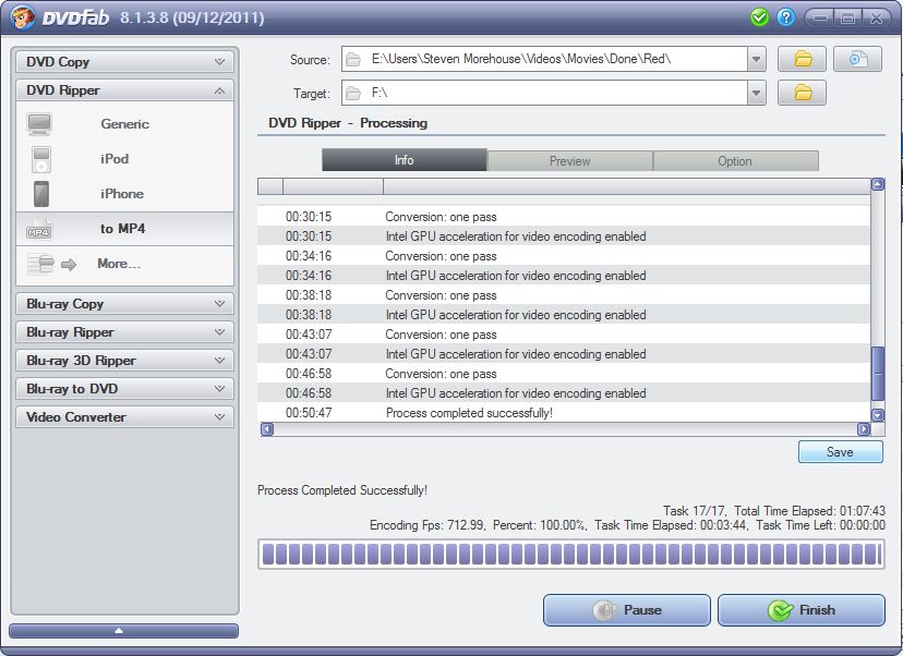

  26. Sweet! I did 17 full length movies as a batch conversion from DVD rips to MP4 (3Mbps, Dolby Prologic @192) and check... it... out! Just shy of 1 hour 8 minutes. That's for all 17! That's short of 4 minutes per movie! And the best news (for me) is that they're all fine!
    I still haven't figured out what's wrong with my MKV settings, but this suits my needs just fine. They play perfectly on the pc, Asus O!Play, and Asus Transformer Prime tablet.
    - Steven
