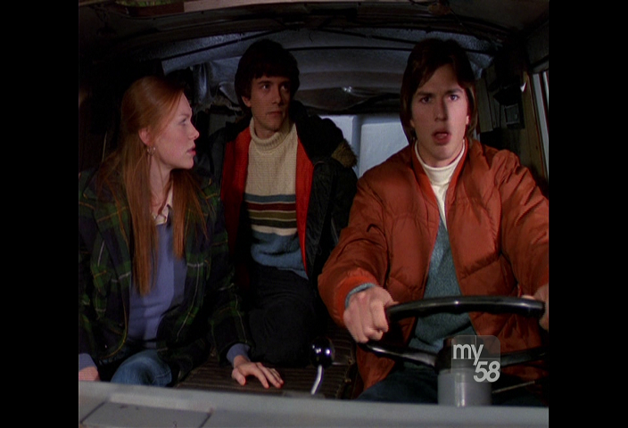

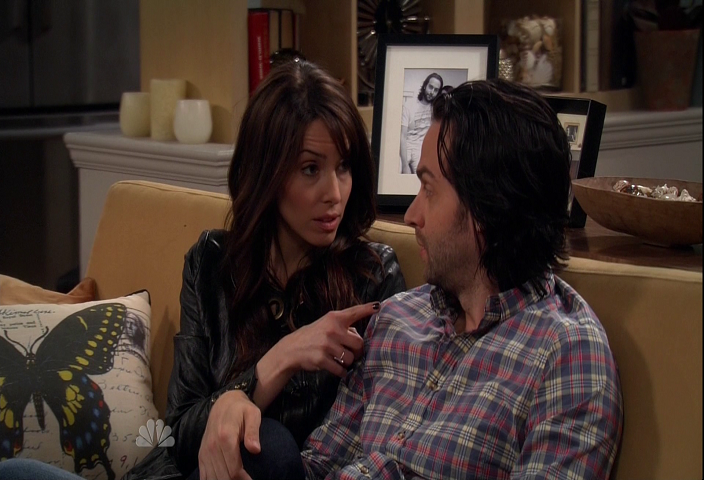

    Note that if you use that device, the video will be recorded horizontally squeezed like it is supposed to but without the wide flag. When you play the DVD, you will need to adjust the TV aspect ratio to wide.
    If you record a 4:3 show that box will output squeezed with side bars like this. It would work better to switch to the cable box direct when recording 4:3 shows.
