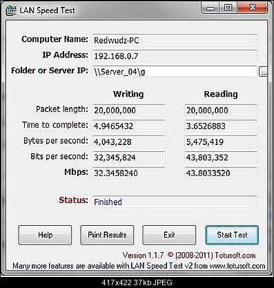

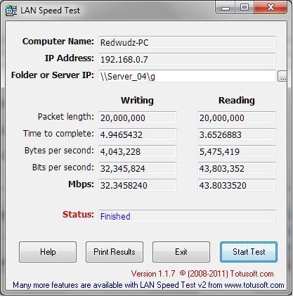

    I'm assuming your NAS is connected via a Ethernet cable? Have you tried to just transfer a large file to the NAS from your PC and check the speed with that in the Windows dialog box? Most times I get about 80MB/s transfer speed, sometimes a little faster, to my video server PCs. That's with a gigabit LAN system with CAT5E wiring.
    I tried ripping a BD to one of my video servers over the LAN a minute ago and the speed was about 8MB/s. Within my PC to one of my hard drives, about the same speed.
    I would check your LAN adapter settings at the computer and the NAS.)
    Here's a simple test program: http://www.totusoft.com/downloads.html The one at the bottom of the list (V1.1.7) doesn't need installing and deletes the files it uses for testing. It's freeware. I did this test with a 20MB file a couple of minutes ago.

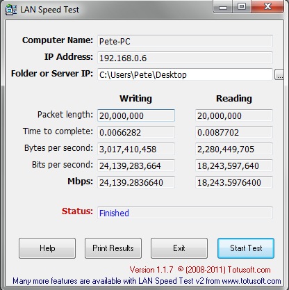

    Ok my results

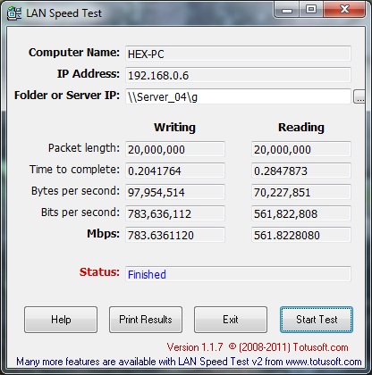

    But here's a test from my laptop to the same server I used with my regular PC for the previous test:

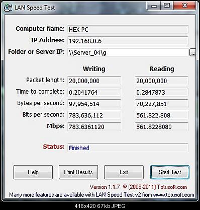

  13. Just as a reference, using LAN Speed Test I get speeds around 700 to 800 Mbps over my gigabit network.
