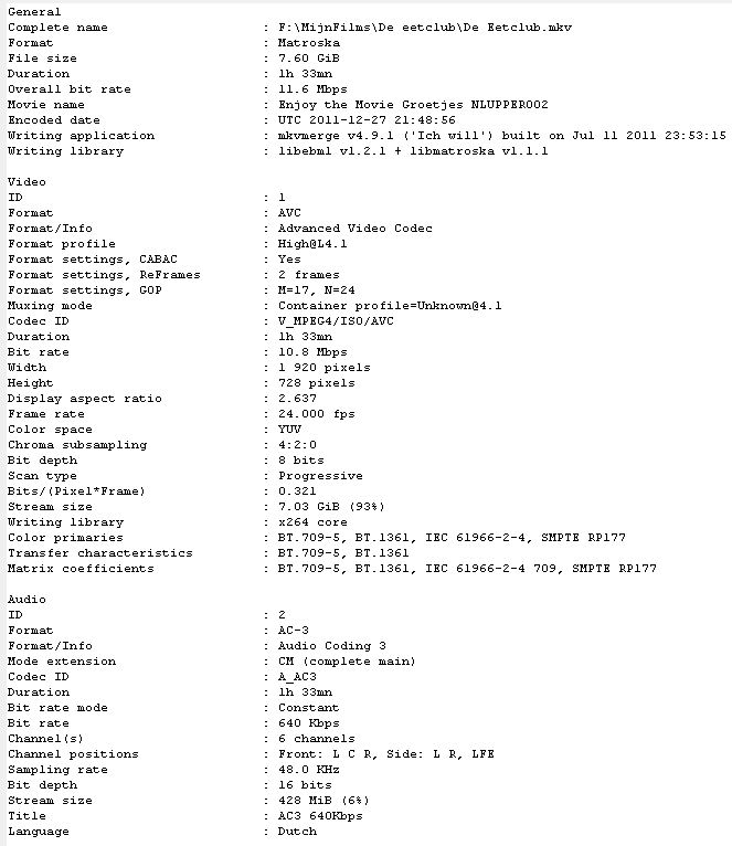

  1. I'm using a WD-mediplayer (WD00AVP, connected to a HD-TV), with several mkv-movies on a attached harddisk.
    I have problems with two mkv-movies:
    1- Movie "Gooische Vrouwen": video but no audio
    2- Movie "De eetclub" : no video and no audio
    Can someone tell me what the problem might be on the basis of the two uploaded MediaInfo-files?

  2. try playing te movies on your PC ... Do thy work?
    Are they incomplete torrent downloads? eg not at 100%??
    They should work as the wftv supports AVC and AC3 quite easily (from the Getgo)
    Try to remux the files with avidemux or suchlike
    How is your wdtv connected to your what TV you have?
    Audio/Video Settings on WDTV?

  3. I could play the movies on my pc without any problem
    I remuxed the movies with mkvmerge by setting the compession to none ( blank is not enough)
    After that I'd no problems.
    Thank you for your support.
