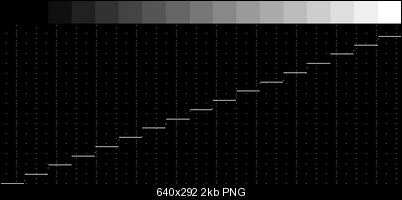

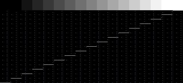

    Levels bars, Y ranges from 0 to 255:

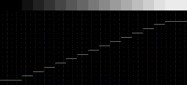

    After Levels(0,1,255,0,235):

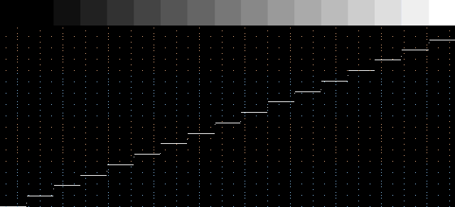

    After ColorYUV(gain_y=-20):
    Notice how you still can't see any difference between the two brightest bars after levels(). But you can see a difference after ColorYUV().
    I wasn't concerned here about what was happening at the low end. But you can see that ColorYUV(gain_y=-20) has caused the Y=16 bar to drop to Y=15, too dark. So you would need to bring it up a bit. Something like ColorYUV(off_y=1, gain_y=-20).
