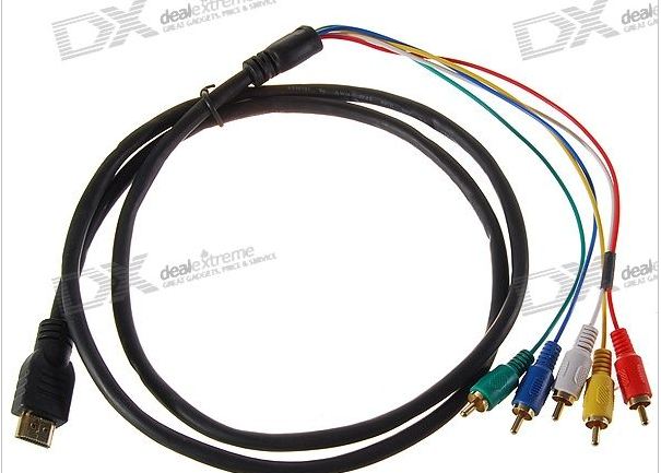

    Laptop solution(?): Laptop has HDMI and VGA outputs. If I simply purchased an HDMI to component video (see attached or something like this http://www.dealextreme.com/p/hdmi-to-component-video-audio-av-cable-13188), and connected the video to the Y, Pb and Pr and the audio to the Audio-R and Audio-L inputs, do you think I'd get 1080i output on the TV? Or, would I need some type of converter in the middle?
