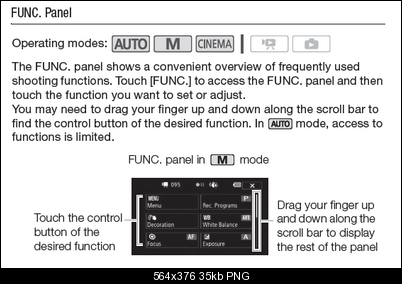

  5. Member edDV's Avatar
    Mar 2004
    Northern California, USA
    I looked through the M40-41 manual but didn't see the manual audio controls (AGC=Off). Check under the "M" menus. If they aren't there, you'll need a different camcorder.

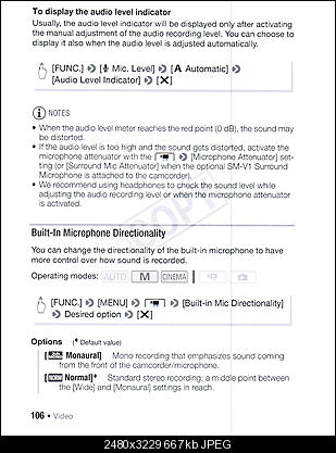

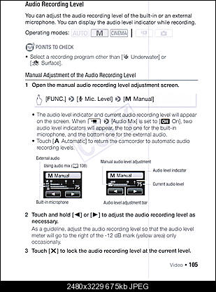

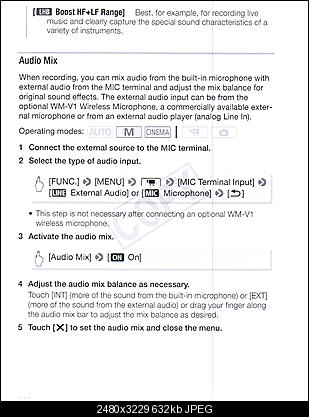

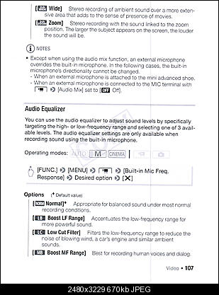

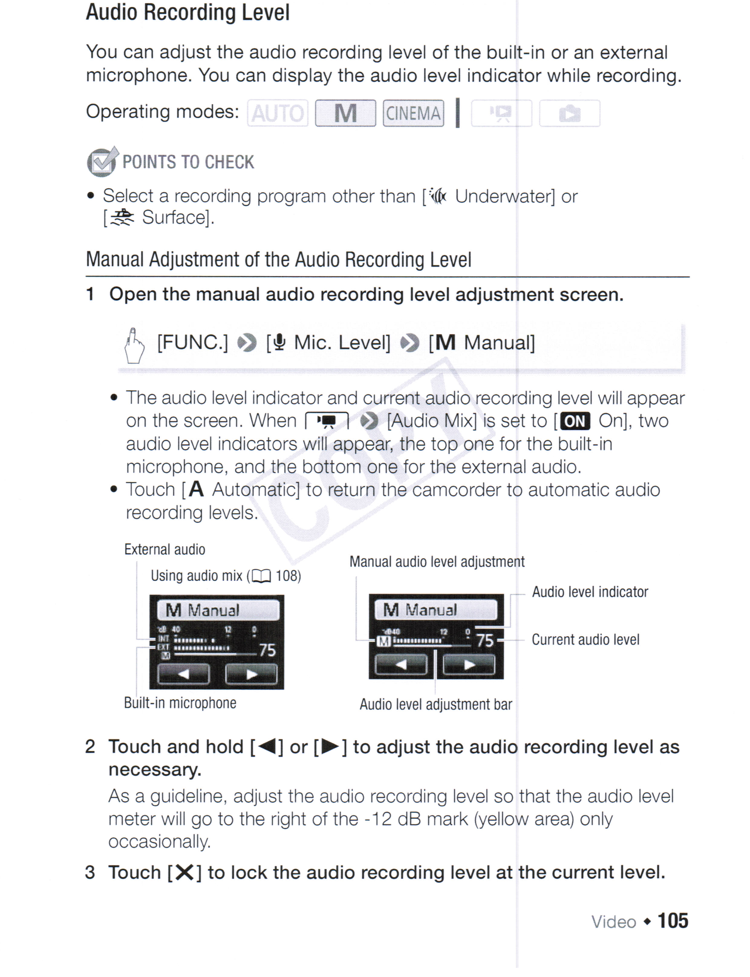

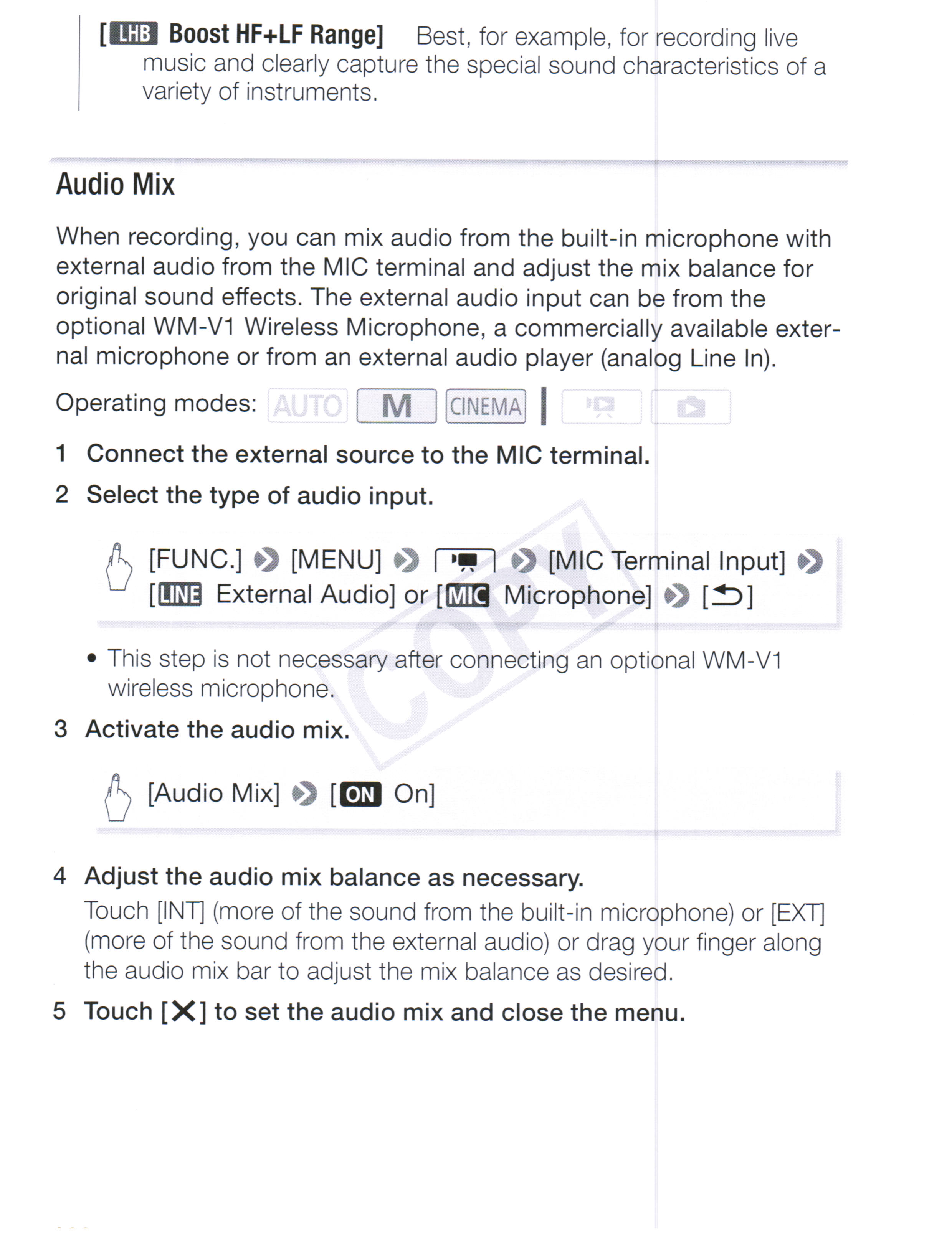

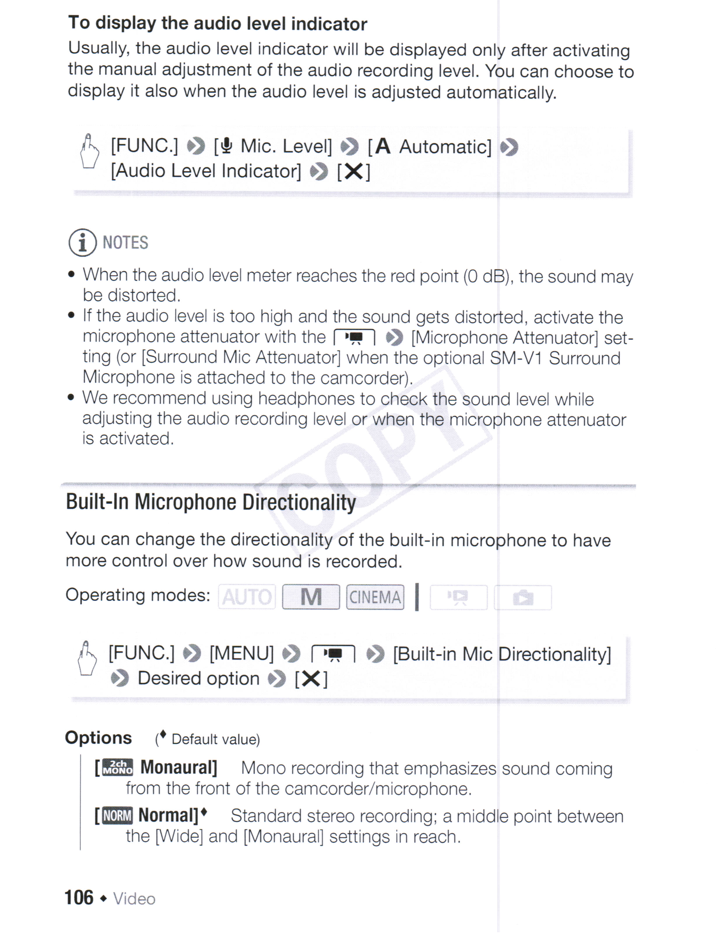

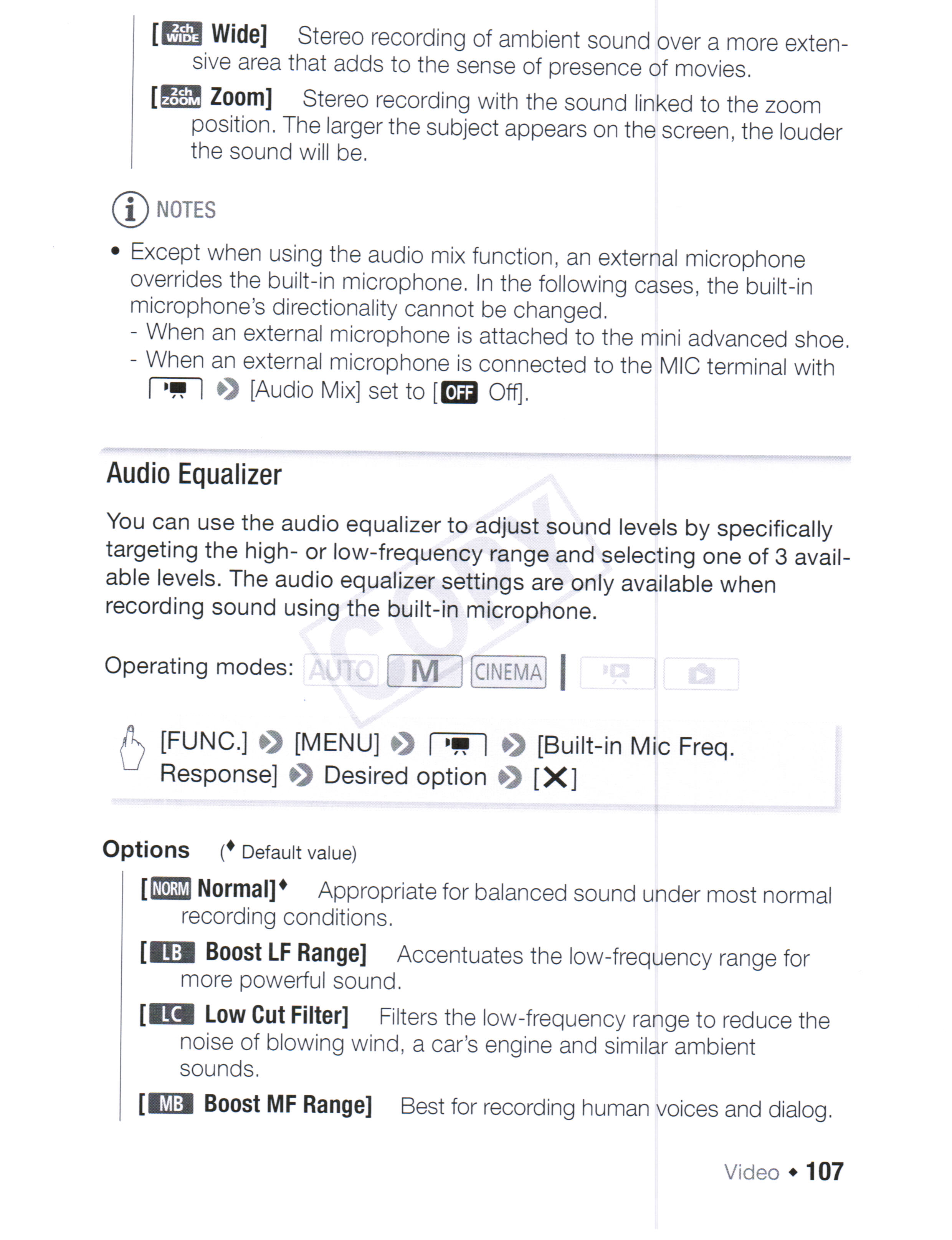

  6. These are the pertinent pages from the Vixia manual for audio. I believe they say I can use an Xlr to 3.5mm converter.
    Does anybody disagree?

  7. Member turk690's Avatar
    Jul 2003
    ON, Canada
    Yes I see there is manual audio control which means you set it at that, no audio mix, then plug in the Beachtek. I use an Azden SGM-1X shotgun (requires battery, which means no need to worry about phantom); I believe middle between the extremes of shotgun microphone costs and capabilities.
