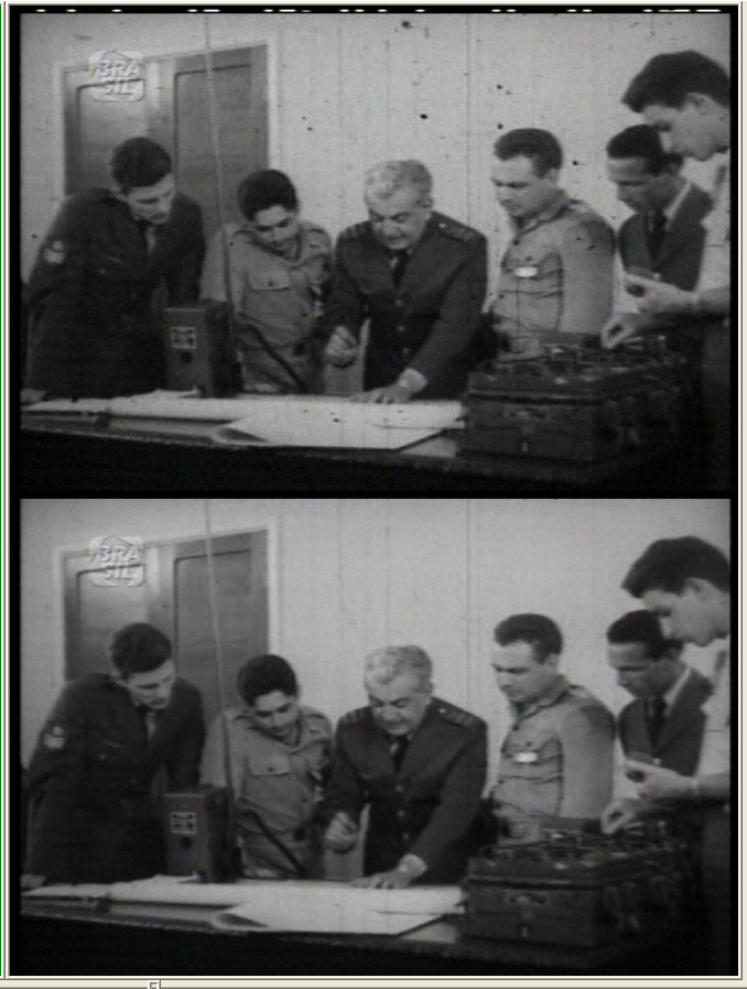

    I applyed 3 time RemoveSpot and the result is starting to get better:
    But I did not understand what you said about decimate.

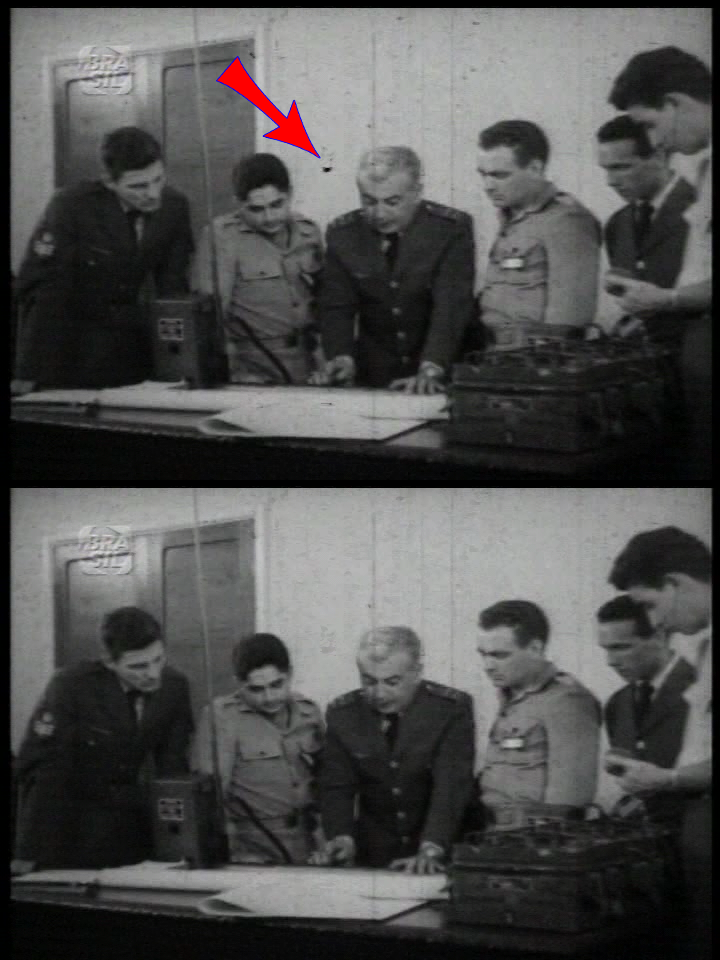

    Applying RemoveSpots with AvsPmod I put some sliders to follow variables:
    repmode, clmode, gmthreshold, noise and noisy.
    I'm looking for the one that could handle the size of the dot. I couldn't get better results altering that values. As it was said before, RemoveSpots have to be applied with default settings. But, if it has parameters, and if each video has its own characteristics, why not try to change them, trying to improve the action of the filter?
    And, finally, what do you thing about to use NeatVideo after RemoveSpots? That's to remove some soft vertical stripes along the video.
    I'm trying to find time to read and understand the RemoveDirt's and RemoveGrain's documentation. Too many parameters and very complex material.
    At overall, I could good results with the suggestions given here, but I'm trying still better ones.

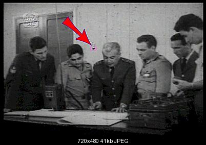

    Thank you.

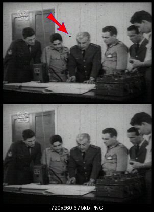

  19. Originally Posted by sanlyn View Post
    Not sure what the Crop and multiple RemoveSpots are doing, but this is what the basic procedure would look like (no cropping or stacking here, just the basic steps):
    Crop is fixing the noise at the top of the video. Look the comparison images at post #7.
    Multiple RemoveSpots is to improve the final result. If I apply the function only one time, some dots still remain.
    First image is the use of the function as you said (one time).

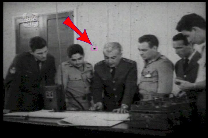

    Second image is the use of multiple functions applied recursively:
    frame #56
    Note the big dot pointed by the arrow. Only one use of RemoveSpot didn't remove it. Several uses did that.
    If I'm misunderstanding the use of the function, let me know. Or if there is another way to do, please, tell me.

  21. Banned
    New York, US
    You probably see that RemoveSpots can leave a few remnants. It tends to fall short during scene transitions, dissolves, fades, and some instances of movement. There's an "MC" version of RemoveDirt that reportedly handles these problems, but I've never seen anyone who can make "MC" load except programmers who understand .NET filter creation. There are tips on making MC work, but it doesn't happen for most users. It isn't developed with the same programming tools used by most Avisynth plugins.
    That said, your iteration seems to work. I haven't seen the video, but judging from your captures the bottom image shows that multiple runs have somewhat softened the video and removed some detail. The method I used to clear remaining spots is explained in the link to the thread I referred to earlier. It's somewhat complicated. But it doesn't re-filter the whole video or the change the entire frame. Here it is:
    Apparently you've measured where the spot is located in the frame. My method would replace only the cropped portion instead of the whole frame. In playback the cleaned spot would be difficult if not impossible to detect. Using the "before" frame that you posted, I would isolate a portion of the frame with these coordinates:
    top left corner: x=322, y=166
    top right corner: x=334, y=166
    bottom left corner: x=322, y=174
    bottom right corner: 334, y=174
    These x,y coordinates define a rectangle that is 12 pixels wide by 8 pixels high. The image below has a small pink rectangle (not the exact size measured here) that outlines the portion to be covered up.
    If you crop the 720x480 frame to make a small frame that isolates that rectangle, the statement would be Crop(322,166,-386,-306). This statement crops 322 pixels from the left, 166 pixels from the top, 334 pixels from the right, 306 pixels from the bottom.

    #  Required AviSynth plugin: RemapFrames.dll
    #  Required AviSynth plugin: BadFrames.dll
    #  Works in YV12, YVY2, RGB
    AviSource("enter path to AVI previously run with RemoveSpots\filename.avi")
    a1=last    # <- original source
    a2=a1      # <- temporary clip for cropping, discarded later
    # -- As a naming convention, "Out" clips are accumulated cleaned frames from "a1"
    # -- example of operation on 1 spot in 1 frame (frame 100).
    # -- b0 = temporary copy of accumulated frames overlaid with cleaned frames
    # -- b1 = temporary clip that is a rectangle taken from a CLEAN frame using Crop()
    # -- b2 = temporary clip that will be overlaid with the clean rectangle
    # -- Out1 = clip that will contain the cleaned-frame version of a1
    b0=a1
    # ----- BadFrames() replaces 100 with blended clean frames 99 + 100 -----
    b1=a2.BadFrames(100).Crop(322,166,-386,-306)    # - (replace 100, then crop clean rectangle)
    b2=Overlay(b0,b1,x=322,166)
    Out1=ReplaceFramesSimple(a1,b2,mappings="100")  # - Out1 = all of a1 with 1 frame replaced
    # -- example of operation on 5 bad spots that appear on 4 consecutive
    # -- frames.  "Out1" below is clip of accumulated "clean" frames from
    # -- previous steps. The frames are consecutive, so FrezeFrame is used
    # -- to move clean frames into 2 areas, then BadFrames to slightly blur
    # -- the remaining 2.
    # -- First get 4 clean frames, then get 5 clean rectangles.
    b0=Out1   # <- start by re-setting b0
    # ---- First, use b01 to contain 4 "cleaned" frames ----
    b01=a2.FreezeFrame(1136,1136,1135).FreezeFrame(1138,1138,1140).BadFrames(1137,1139)
    # ---- Now save 5 clean rectangles from b01 -----
    b02=b01.Crop(162,246,-522,-212)
    b03=b01.Crop(198,254,-508,-206)
    b04=b01.Crop(212,268,-474,-206)
    b05=b01.Crop(246,258,-418,-152)
    b06=b01.Crop(312,338,-360,-128)
    # ---- Build a clip that replaces 5 "bad" rectangles with 5 "clean" ones ----
    # ---- Note that this replaces every respective rectangle in the entire  ----
    # ---- "work copy" of the video. So the last step is to accumulate clean ----
    # ---- frames into B11, which is used to replace 4 frames in Out2 output ----
    b07=Overlay(b0,b02,x=162,y=246)
    b08=Overlay(b07,b03,x=198,y=254)
    b09=Overlay(b08,b04,x=212,y=268)
    b10=Overlay(b09,b05,x=246,y=258)
    b11=Overlay(b10,b06,x=312,y=338)
    Out2=ReplaceFramesSimple(Out1,b11,mappings="[1136 1139]")
    Return Out2   # <- new copy of a1 with 5 bad frames replaced, all others intact.
    No doubt this can be time consuming (but doesn't take as long as one would think). I'm also absolutely certain there are better ways to do it. This is a clip with spots:
    http://dc426.4shared.com/download/PqmKlPjf/Sample_Spots.mpg
    This is the first few seconds of that clip after RemoveSpots, RemoveDirt, and 3 or 4 added routines like the script above. Note: this isn't the IVTC'd version, it's the original telecine.
    http://dc234.4shared.com/download/_feM7ikb/Jackie_fix.mpg
