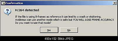

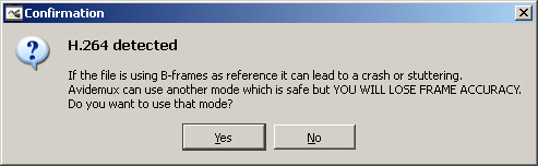

    I get this message when I load it into Avidemux:
    I'm not sure whether I need "frame accuracy"; I will not edit it, I only will recode it's video and audio (to an Xvid .avi with mp3 audio for greater compatibility with standalone DVD players).

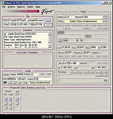

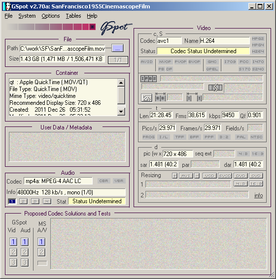

    I got it from here; here's it's GSpot:

  6. If you are just re-encoding it, it doesn't matter for frame accuracy, that's only for seeking and making cuts
    You can use nightly build (2.6 beta builds) , it handles h.264 much better
    http://avidemux.razorbyte.com.au/
    So much better, it didn't even give me that warning about "frame accuracy".

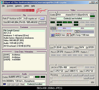

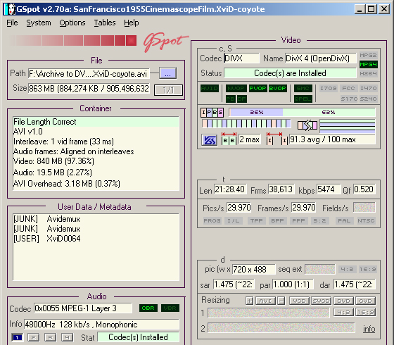

    With the recode, all is well with the video, and all is well with the audio with VLC. However on my standalone players* I get no audio. Here's the Gspot:
    The only thing that differs from the audio of other files that work on those players, is that it's "Monophonic". I can't see a setting to copy to a pair of stereo channels, so all I can offer is that the recode setting were:
    Audio output: MP3 CBR 128k Quality=0
    Output format: AVI Muxer (AUTO)
    Video Output: xvid4 (I was surprised that didn't output an XVID, but instead gave me a DIVX)
    No filters
    ASLevel4, B-frames 2, Gop 100, CQ3, Type=MPEG, Qpel8, Full, Trellis, Auto threading
    Can anyone please provide me with my missing clue?
    Thank you very much!
    *Philips 5992 and TViX M6500A, both with idea firmware
  9. Look at post #5, your gspot information on the mov says original audio is mono AAC
    I think you can make fake stereo by using the audio mixer options (not sure if they are available in 2.6 or avidemux)

    Originally Posted by coyote2 View Post
    With the recode...on my standalone players I get no audio
    Oops, sorry, it turns out the issue was with my TV. Because today that recode with mono mp3 audio has sound from both standalone players.
