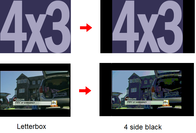

  1. I am curious about some of the TV shows that have a black bars on all four sides. I noticed this on "Frosty Returns" when it was broadcast earlier in December. I also noticed this same thing on "The Forgotten Toys" and "Mr. Magoo's Christmas". I notice it on the odd commercial as well. I was hoping someone could explain why there are black bars all around the video. I understand widescreen letterboxing with the black bars at the top and bottom.
  2. Member edDV's Avatar
    Mar 2004
    Northern California, USA
    This happens when 4:3 SD letterbox is displayed on a wide screen HDTV which adds side pillars to the 4:3 picture. This is a display issue not a broadcast problem.

  3. edDV: Thank you for the explanation and the picture. This same box all around happened our tube standard definition TV as well.

    They're airing 4:3 content but it would appear they're now only sending an HD feed to providers. So you get 4:3 -> pillarboxed for 16:9 HD -> downconverted to 4:3 SD with letterboxing added.
