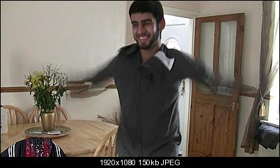

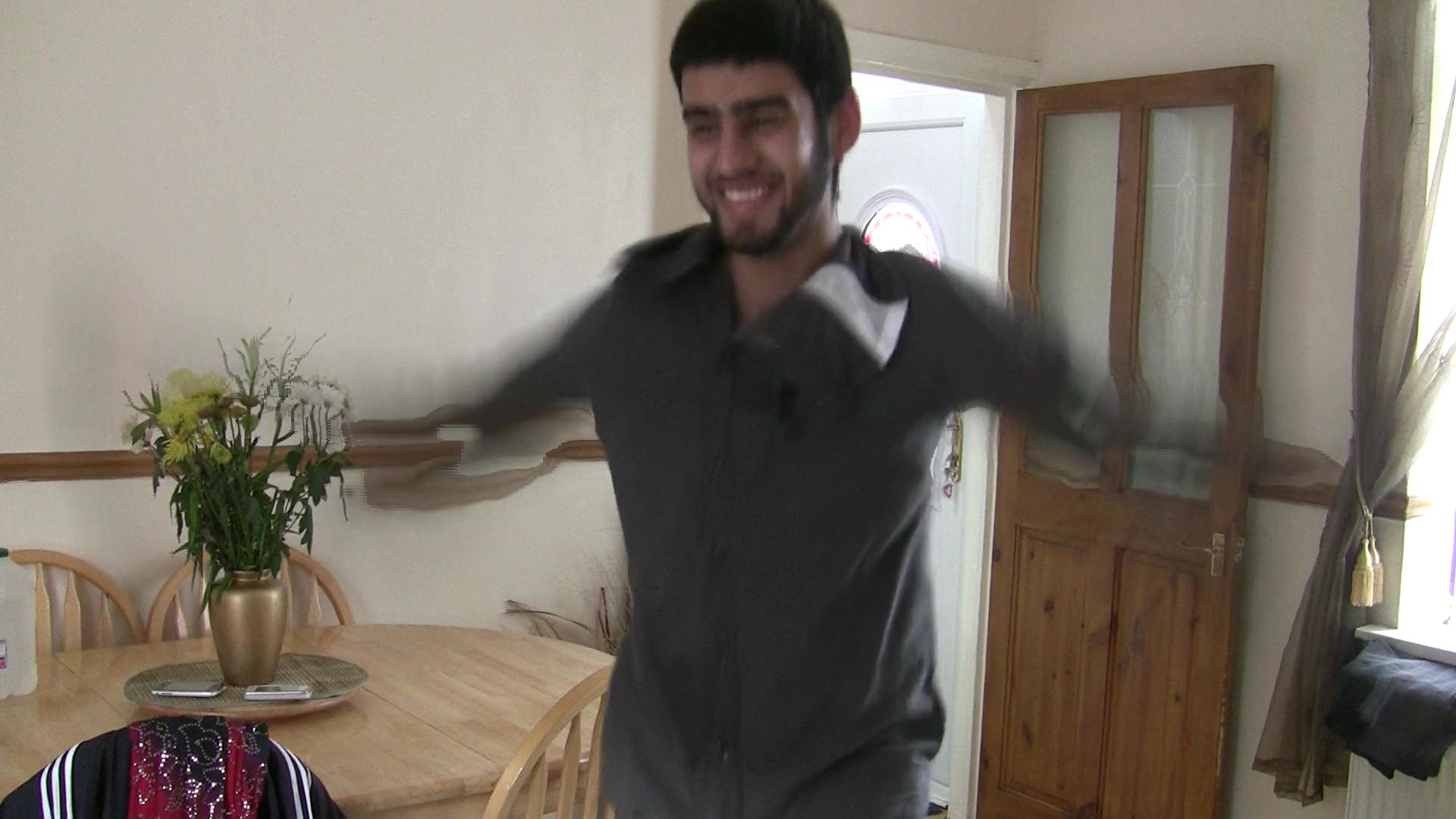

    Here are 2 test clips I shoy today (ok, a lot of movement for exaggeration):
    [Attachment 10277 - Click to enlarge]
    [Attachment 10278 - Click to enlarge]
    The shutter in these clips matches the framerate:
    Each frame = 1/25sec and the shutter is also 1/25sec
    Comparing neighbouring frames, there's no gap in the motion blur.
    The shutter speed on the other clip you posted was twice as fast, so there's less motion blur and gaps in the movement. It looks like the Cine mode doesn't use a fixed shutter. I've just confirmed similar behaviour with my HFS21 (I've not used Cinemode before), and there's a thread discussing the issue with another Canon cam - the HV20, here.
    It's possible the camera might increase the shutter speed even more under bright light - to 1/120 for example. Coupled with a hand-held recording and low frame rate, this would cause a lot of judder.
    I almost always shoot Shutter Priority.
    As has been said, unless you want to shoot 25p for a specific effect; shoot 50i AND use Shutter Priority with the shutter set to 1/50. I don't know of an easy way to reduce the judder of the footage you've already shot other than using motion interpolation.
