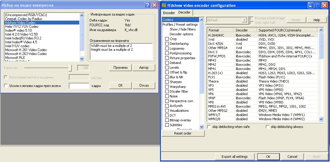

  13. Name of codec used by me is ffdshow Video Codec. I have no idea what decoder is used:
  14. Use File -> File Information in VirtualDub. It may tell you what decoder is being used. You didn't answer the question about what you saw in VirtualDub's preview windows before saving your file.
  15. In preview window no dark bar and everything in it seems normal. Dark bar appears in the recorded file. I use the internal Motion JPEG decoder (MJPG).
  16. Try using a different codec and see if the problem happens with that too.

  18. Try updating ffdshow? Otherwise, if you need all i-frame encoding, use a different MJPEG encoder. Or use Xvid or x264vfw with only i-frames.

    Using the FFDSHOW MJPEG codec, I see the problem.
    The PICVideo codec works.
  20. I'm not having that problem with ffdshow here. The build I'm using is about a year old, rev4149. 32 bit. I just checked the 64 bit version -- no problems there either.
    Dec 2005
    Canada
    My version, showing the problem, is 2011-06-29 rev 3914.
  22. The latest build hosted at videohelp.com (rev4206) doesn't have the problem.
