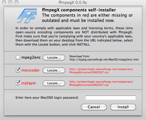

  5. Member jgcalifornia's Avatar
    Dec 2011
    Los Angeles Ca
    well, upon rebooting, the first thing i noticed that the components self installer keeps telling me these 2 files are missing. ive downloaded them several times, rebooted, and it still shows me this, so maybe that would explain for a failed conversion?
    (attached pic)

  8. Explorer Case's Avatar
    Feb 2004
    Middle Earth
    (attached pic)
    Some users have tried to point the installer to the .zip file, which shouldn't be done. One should browse to the unzipped binaries. (But the log clearly shows that the correct mencoder is successfully used.)
    Some users have tried to manually move the binaries, which shouldn't be done. Just leave them in the download location, and let the installer copy them to their special location. (After a successful install, the downloaded binaries may be deleted or archived.)
    I don't know what else could go wrong.
