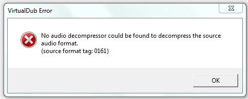

    So I though I would get Virtualdub a try to edit some videos that I have. I used mediainfo to get the info from one of the videos

    I read bout plugins and installed the correct x64 plugins for WVM called WMV64.vdplugin and I also installed WMV9VCM (Windows Media Video 9 VCM) and also ffdx64show.
    I'm running windows 7 x64 SP1. I can play the video using VLC and I get audio with out any problem, but just get this error.
    Any ideas?

    Description of the codec:
    Windows Media Audio 9.2 - 48 kbps, 44 kHz, stereo (A/V) 1-pass CBR
    IF MediaInfo is correct, THEN
    VirtualDub cannot play the audio part.

    If you're using the 32 bit version of Virtualdub, it can only use 32 bit codes. Similarly, the 64 bit version needs 64 bit codecs.
    Are you running the 64 bit version of Virtualdub?
    In general, it's better to run the 32 bit versions. You'll get much less trouble in the long run.

    So you must have missed that part after the output from media info because that is where I stated that I was using x64 version of everything (plugins, virtualdub, etc.)
    BUT will say that I also tried the 32 bit version of everything and came up with the same problem.

    You could always try the directshow input plugin if the other fails.
    http://www.virtualdub.org/beta/DShowInputDriver-0.91.zip
    quote :
    "So you must have missed that part after the output from media info because that is where I stated that I was using x64 version of everything (plugins, virtualdub, etc.)"
    I reread your post, and unless I've been looking at the screen too long, it does not explicitly say which version of Virtualdub
    you're using.

    @ nzdreamer55: Apologies, I really should have taken the time to explain what I said
    Unless you feed VirtualDub through the mentioned DShow Input driver, or through an .AVS file, it will require VfW and ACM codecs for working properly. Until now, there is no ACM decoder for WMA 9, WMA Pro and WMA lossless. Even when using the WMV / MKV / FLV input plugins, you'll still need the VCM codecs. Besides, possibly there will be troubles if an MKV file was NOT muxed in the so-called "VfW-compatible mode".
  10. As was pointed out, VirtualDub needs an ACM WMA2 decoder to read that audio. ffdshow does not provide ACM decoders and the 32 bit version of WMV9VCM doesn't supply one for 64 bit programs. Is there a 64 bit version of WMV9VCM? I haven't seen one. VLC uses its own built-in decoder for everything. So being able to hear the sound with that only means VLC has a built-in decoder for WMA2. No other program will be able to access that. Just use the DirectShow source filter.

    Does what Jagabo said mean that the 32 bit version of WMV9VCM has ACM decoder but the 64 bit does not?
    No, it means there is no 64 bit WMV9ACM -- as far as I know. If you need WMV9ACM you need to run 32 bit softare.
    Originally Posted by nzdreamer55 View Post
    Could that mean that I could get this working if I use the 32 bit version of everything?
    Yes. 64 bit VirtualDub isn't significantly faster than 32 bit VirtualDub anyway.

    Figure out what audio codec you need with MediaInfo. Download and install an ACM decoder.

  19. Assuming you're using the WMV source plugin for VirtualDub: Install WMV9 VCM. That will get you the VFW video codecs and ACM audio codecs that VirtualDub requires.
    Or switch to using the DirectShow plugin for VirtualDub. Then DirectShow will do all the A/V handling for VirtualDub. Windows comes with DirectShow source filters and codecs for WMV. DirectShow isn't always frame accurate though.

    Did you install the divx wma audio codec as poisondeathray suggested? It's a known problem for missing codec 0161.
    https://forum.videohelp.com/threads/295962-WebEx-WMV-file-can-t-open-in-VirtualDub-says-missing-codec
    http://www.free-codecs.com/download/divx_mpeg-4_audio_compressor.htm
    Since I installed it, I have no problems with this error in VirtualDub. You might also reference:
    http://www.brilliantcode.com/virtualdub-is-showing-missing-codec-when-i-play-a-wmv-mov...gins-directory for setting VFW codecs if you have ffdshow installed.
    Pay particular attention to the line in red to be sure you set the VFW decoders not the regular video decoders.
    If all else fails, I would use the directshow or ffmpeg plugin (in the VirtualDub/plugins32 folder for 32bit VirtualDub) as jagabo suggested.
