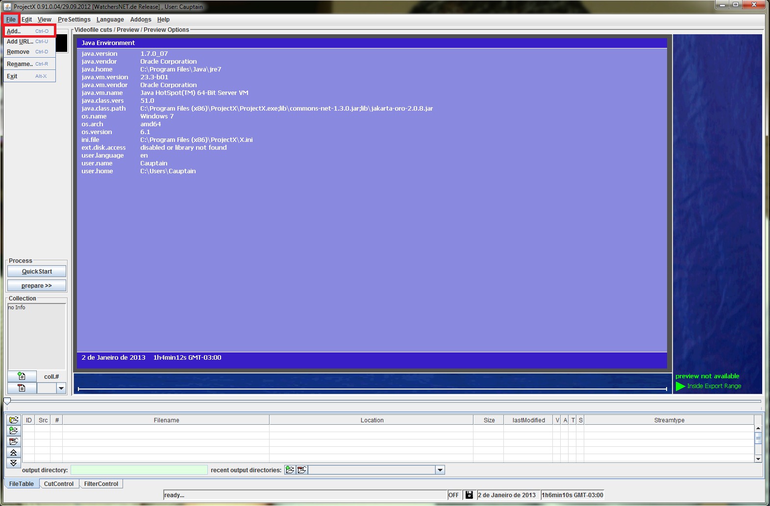

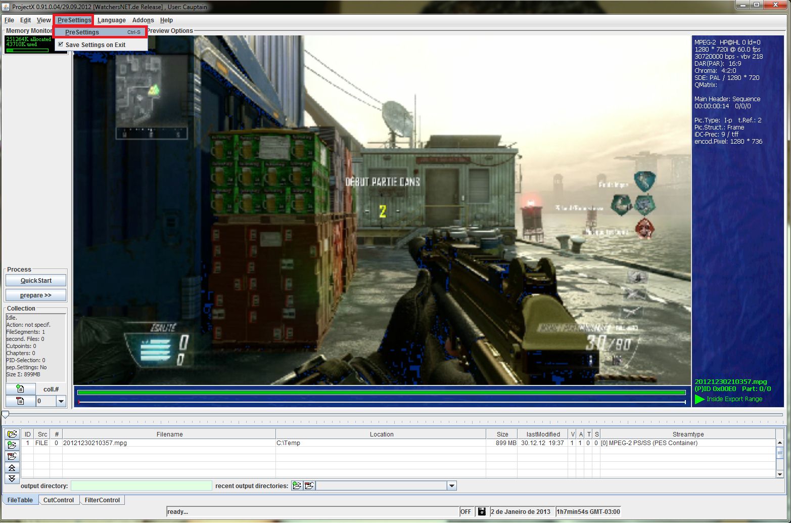

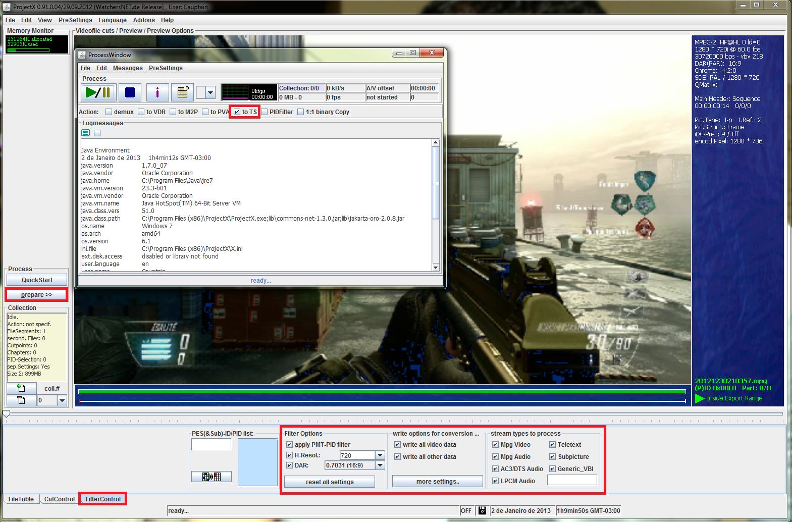

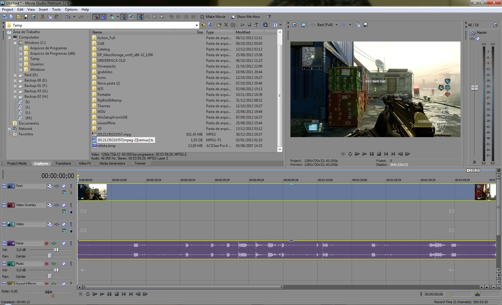

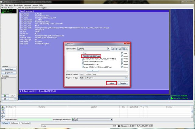

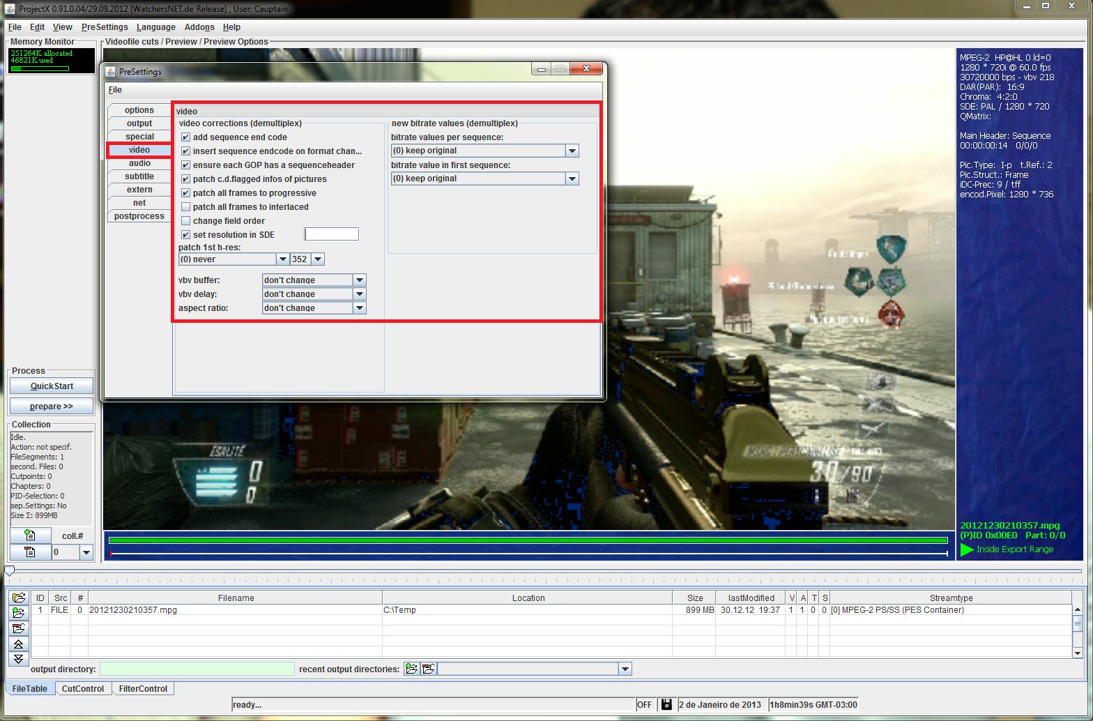

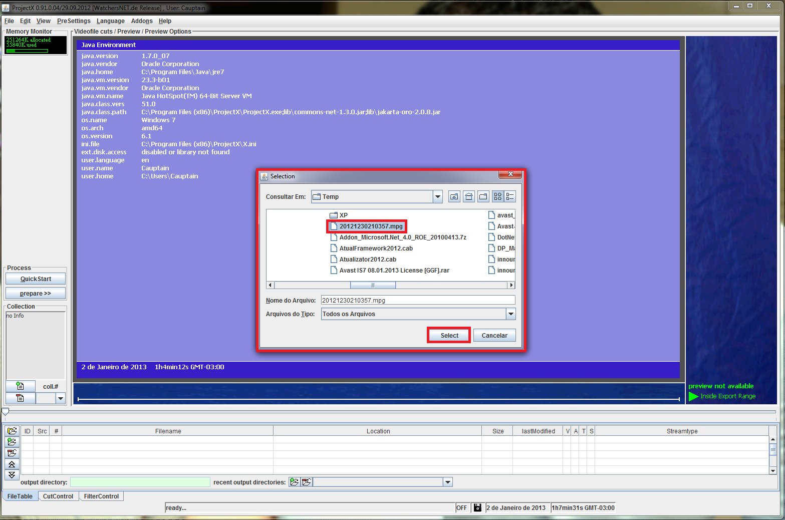

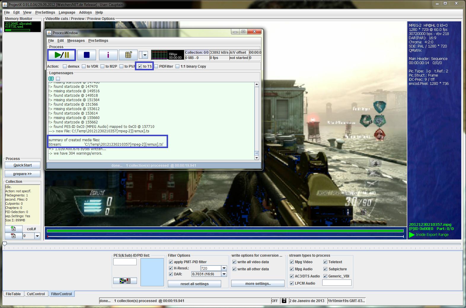

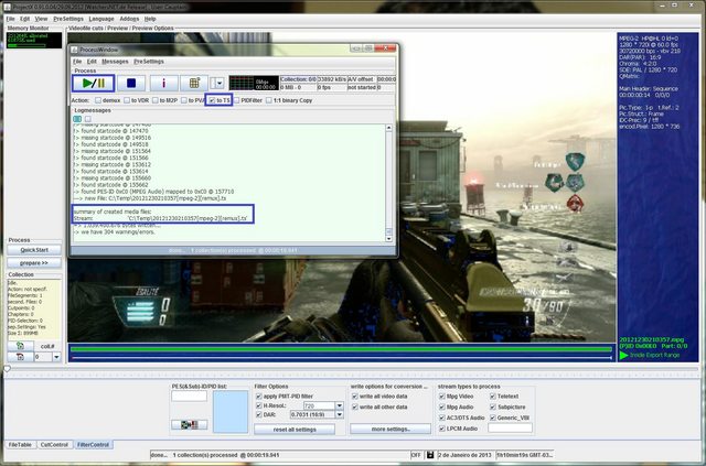

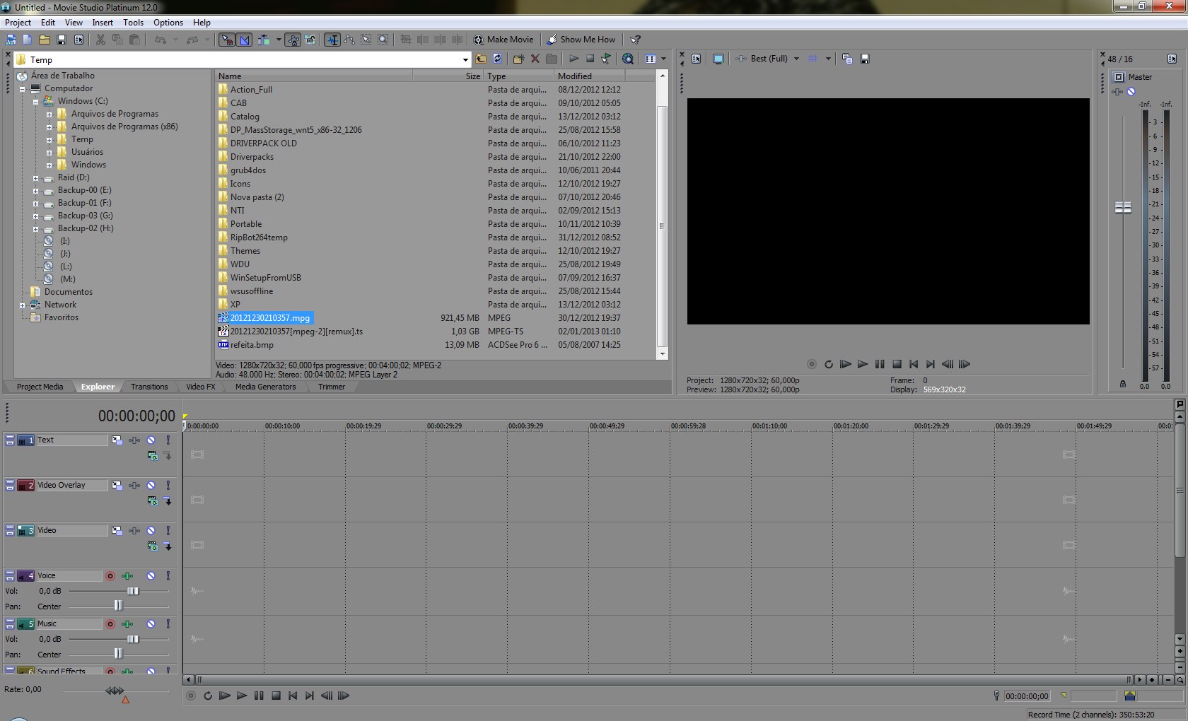

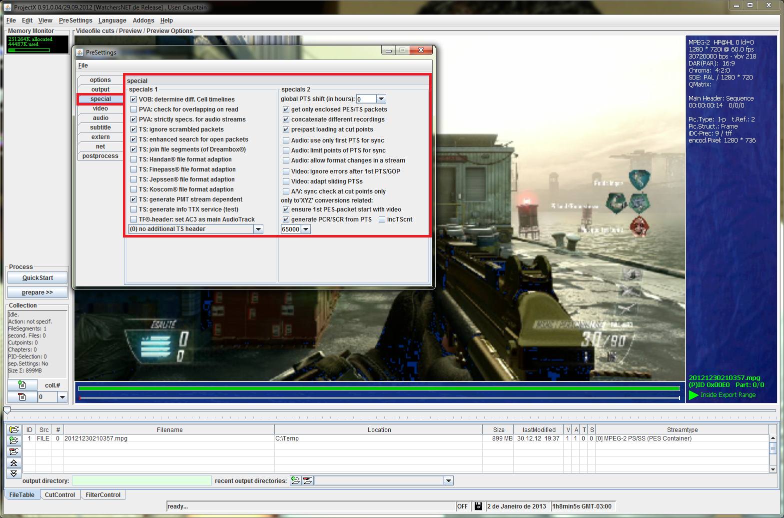

    Many users/peoples asking me via email and PM about MPEG2 files recorded on the Avermedia Center HDCP not be recognized on video editors like Vegas, Avid or Premiere and others.
    Below a simple tutorial to show how to solve this problem using the tool ProjectX.
    Just set pictures and resolution
    according for each video, of course.
    Any doubt just reply.
    Claudio
