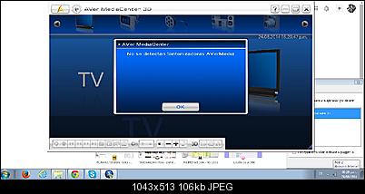

    Hi, what happens is that a few days ago I miss my pc detect the video capture avermedia c027 receive this message, be obliged if someone help me if you know how to fix it greetingsgreetings https://fbcdn-sphotos-d-a.akamaihd.net/hphotos-ak-xap1/v/t1.0-9/10613118_1020476854784...09e7c7132e7b4aClick image for larger version

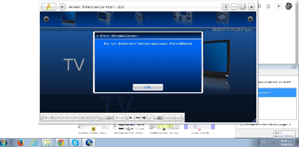

    Hi brianmanga,
    Sometimes Aver C027 get problem in Windows.
    The easy way to solve this is:
    - Uninstall all avermedia driver/software.
    - Reboot.
    - Run any registry clean, my fav is CCLEANER.
    - Install only driver and check in Virtualdub or AmarecTV
    - If work, install Avermedia software. Enjoy.
    Tell me if work.
