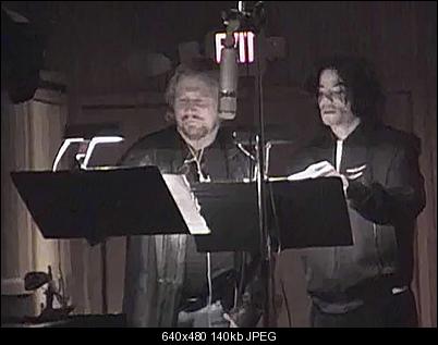

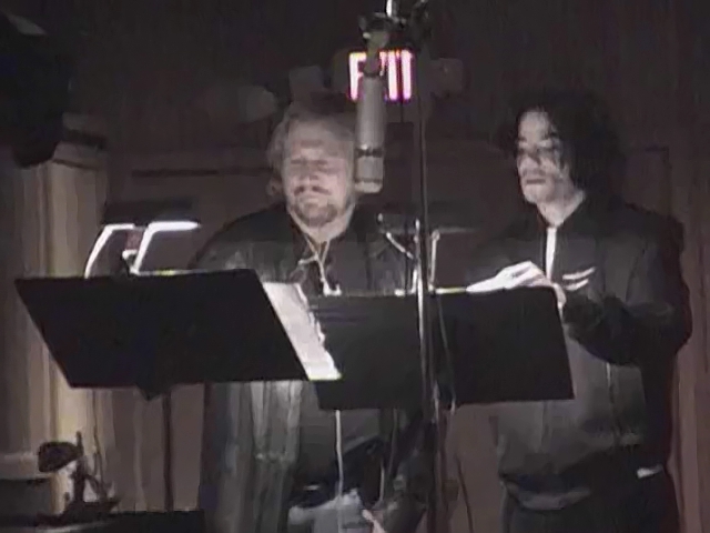

    While you're trying new tweaks, I'm testing each step of your script. The thing that makes me curious is RemoveDirt().. I compared carefully but I can't see its contribution Please check the following frames:
    before:
    after:

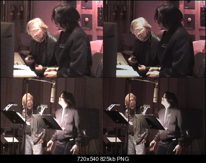

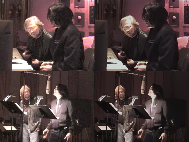

    Be careful about comparing subtle detail with the lossy compression in jpeg images. Use PNG, which is lossless. The jpeg images have artifacts that aren't in the video.
    RemoveDirt is being used to address noise issues, not grain or sharpening. It also does a little work on chroma noise, which you can see on the music stands (red blotches on black). In the first image below ("With_RD") what RemoveDirt is doing isn't very apparent from still images, which can't be used effectively to analyze what motion-block processing is doing. I'm looking at various mode switches in RD to see what will happen on motion, but it is doing some cleanup as-is. These images are PNG's made from the latest effort before NeatVideo (it's Step2, folks) and without a couple of small plugins I'm trying from the anime world. The best way to compare very similar images is to mount them in Photoshop or PaintShopPro (or some graphics app that uses layers and will let you turn layers on and off to see the differences), and enlarge them with bucubic resize (do NOT use "Zoom" controls). But you can click on them to enlarge slightly in the forum, then click the back and forward buttons. In the capture that uses RD, the music stands look cleaner and some of the blotches are smoothed.
    If anything, RemoveDirt softens a bit (look at the fine mesh in the microphone). That's easy enough to fix. Watch the moving video to see what happens to noise. In the scene that follows this one, look at the music stands, the components against the wall in the background, shadows in MJ's hair and jacket.
    With Remove Dirt:
    [Attachment 11546 - Click to enlarge]
    Without RemoveDirt:
    [Attachment 11547 - Click to enlarge]
    You're right. Not much difference in the stills. No motion.

    Glad I let it bake overnight. A couple of shots need color work. This one is still a toughie, but It's getting there:
    Top: Scene 4, original video
    Middle: After denoise and SmoothLevels.
    Bottom: Today
    [Attachment 11830 - Click to enlarge]
    [Attachment 11831 - Click to enlarge]
    [Attachment 11832 - Click to enlarge]
    Yes, the middle and bottom are different. It's in the way the scene displays.

    Okay, it's been a long haul . Many interruptions, including the Easter bunny. The result isn't a quantum improvement, but it's...well, an improvement but not of quantum class. At least most of the horrible grainy gunk is gone.
    version 8 preview (NTSC MPEG2 AC3, 127-MB, 2-min 44-sec) 23.976 fps progressive - Not DVD compliant.
    The Whole Thing (NTSC MPEG2 AC3, 262-MB, 5-min 38-sec) 23.976 fps progressive - Not DVD compliant.
    The scripts are in 3 steps. I used 3 scripts to avoid freezing-up my pitiful 2.4GHz PC. Steps 1 & 2 are saved as YV12. Step 3 is simply a conversion to RGB24 for VirtualDub and NeatVideo. NeatVideo used mostly as a temporal filter. RemoveDirt() not used, but I think I should have kept it in anyway for some green chroma noise. I ran NeatVideo (Step 3) by itself. There's really a "Step 4" for the color filters.
    The video has 20 scenes, each color-fixed individually in VirtualDub. How you break up the AVI into 20 scenes is up to you. I used Avisynth and Trim(). Each scene was encoded to MPEG with TMPGenc Plus 2.5, which allows me to cut each AVI so that the first frame in each scene is a key frame, with some 30 frames of the foloowing scene retained for audio sync with the next shot. The scenes were assembled into one continuous video with TMPGenc MPEG Editor v3. How you want to arrange this edit/join is up to you, but TMPGenc made it very easy assemble the 20 MPEG's.
    Scenes 3 and 4 were joined with a dissolve in Avisynth. If you start counting frames from frame 0 in scene 3, the dissolve begins at frame 391. My version of Scenes 3 and 4 had extra frames, but basically the trick is to trim Scene 3 from frame 381 + 50 extra frames. Trim Scene 4 from the frame that starts the dissolve. The dissolve is 50 frames (about 2 seconds). Here is the script I used. You'll have to fiddle with the frame numbers. I used an Excel spreadsheet to figure it out. In a folder called sc3_4 I joined scene 3 and scene 4 = "sc3_4":
    sc3c=AviSOurce("J:\forum\AllIn\post8\sc3_4\sc3.avi").Trim(0,-465)  # <- second number is negative so the trim will include frame 0)
    sc4=AviSource("J:\forum\AllIn\post8\sc3_4\sc4.avi").Trim(28,0)
    Sc3_4=Dissolve(sc3,sc4,50)
    Return sc3_4
    The attachments include a .zip with NeatVideo .dnp and .nfp files and VirtualDUb .vcf for all 20 scenes. There is no scene 13. Another .zip has the avs scripts.
    Later I'll make a 3:2 pulldown 29.97fps version -- Which means I'll have to join all these AVi's in Avisynth to avoid interrupting the 3:2 pulldown sequence. Gimme a little time on that.
    Still not satisfied. Check back in a few weeks after I learn more about mvtools and masktools.
