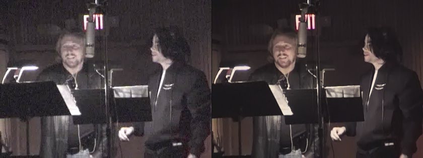

  8. Banned
    New York, US
  9. Originally Posted by sanlyn View Post
    There's still much to do. Worked color/levels a little. Made a mistake, forgot I had an extra call to RemoveDirt, made some parts look a little raw. Will fix it later.
    Shirt trial run: NTSC MPEG2/layer2 54-MB 1-min 2-sec
    http://dc239.4shared.com/download/GDWglJnH/V6_Short.mpg
    first 2-min 45-sec, NTSC MPEG2/layer2 127-MB
    http://dc430.4shared.com/download/LxWMPFLO/m4v_TrialDenoise.mpg
    Will post documentation tomorrow.
    [Attachment 11267 - Click to enlarge]
    [Attachment 11268 - Click to enlarge]
    [Attachment 11269 - Click to enlarge]
    This is very nice, I like how you corrected the skin color. Their faces look way more natural. However, the walls look too pink in my opinion.. I'm eager to see you color settings.
    And it seems you reduced the sharpening in MCTemporalDenoise().. which strength did you set?
    And then, did you apply other additional filter ? Why do you want to use RemoveDirt()?

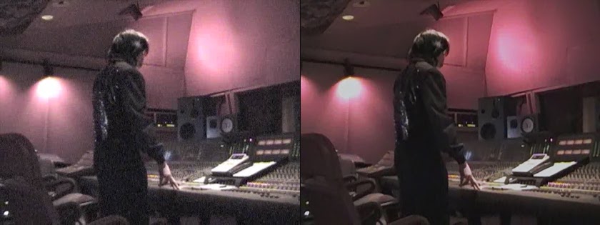

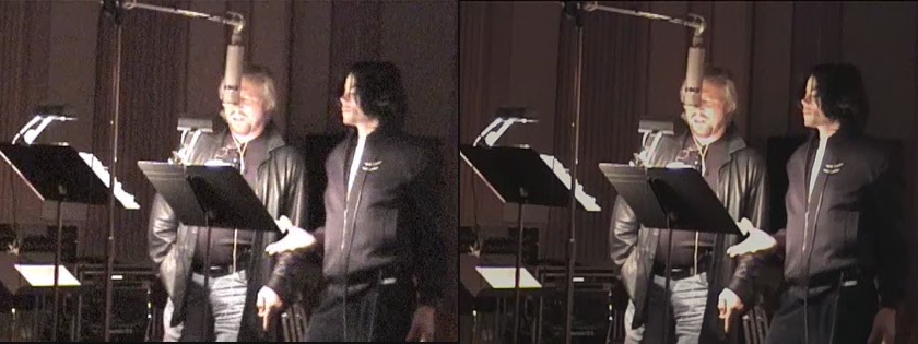

  11. Banned
    New York, US
    The video has 19 camera shots from 5 scenes. The Avs scripts for the full-video AVI have basic level adjustments to avoid clipping. Some clipping came with the source and can't be fixed. After running NeatVideo in RGB, the 19 shots were levels&color-corrected separately. Some shots that were the same lighting, angle, etc., used common corrections. Each scene was worked in AVI, rendered separately to MPEG2 in TMPGenc Plus, then assembled with TMPGenc MPEG Editor v3.
    One problem was the dissolve between the end of scene 3 and start of scene 4. Scene 3 is too bright and green (apparently shot thru layers of glass). Scene 4 needed different corrections. If you correct scene 3, the dissolve-in to scene 4 looks horrible. If you correct scene 4, scene 3 looks horrible. Thus, each scene was corrected as needed in AVI, then dissolved together over the "real" dissolve for 35 frames in Avisynth, then made into a single MPEG.
    The images below show the problem if you simply patch in the two scenes, without separate corrections for each scene. the corrections for one will screw up the other:
    (left) scene 3 - no correction, before dissolve. (Right) scene 4 - no correction, after dissolve.
    [Attachment 11279 - Click to enlarge]
    Same frames with scene 3 corrections for both: (left) scene 3, (right) scene 4.
    [Attachment 11280 - Click to enlarge]
    Same frames with scene 4 corrections for both: (left) scene 3, (right) scene 4.
    [Attachment 11281 - Click to enlarge]
    from the mpeg, showing separate corrections and an Avisynth dissolve over the "real" dissolve (12 secs, 9-MB).
    http://dc473.4shared.com/download/xlEQaMto/Dissolve_V6.mpg
    RGB color correction and NeatVideo: these areas are usually subject to personal preference, and they're difficult to describe step by step. Describing the steps usually takes longer than doing it. The attached Version6_settings.zip has the NeatVideo noise patch and noise settings I used after running script #3 and going to RGB.
    Version6_settings also has the VirtualDub .vcf settings files for scenes 3 and 4. These two shots are of Gibbs and MJ at the microphone (scene 3 is the head-on shots). They make up most of the video and used common settings, each tweaked now and then. A .vcf lists filters and their settings. It loads these into ViurtualDub using the "File -> load processing settings..." menu. The controls were gradation curves and ColorMill. If you don't have these in your VirtualDub plugins, VDub won't load the controls and gives an error message that you can ignore. There are two instances of gradation curves in each scene.
    The three separate .avs scripts are attched below. I'll do more Frankenstein experiments with the video, and start learning more about SmoothAdjust().

    New York, US
    I have to give up on QTGMC as a fix for comb effects. It did smooth combing but caused other problems (smearing). This crappy video is in constant motion even when nothing moves, especially in darker areas.
    Meanwhile I tried the O.P.'s suggestion of running MCTD with twopass=true. DIdn't solve many new problems, but retained detail looks much better. I added these settings to MCTD's parameters: twopass=true,limit=1,limit1=1. Slowed processing by about 10%, not bad. Will keep on tweaking til it looks better.

    Making progress, mathmax, QTGMC not withstanding. MCTD with two-pass retained more detail (what there is of it to begin with).
    I agree with poisondeathray, this clip must have been interlaced at some point -- which might explain how STEP 1 seems to work when "forced" to look that way, even if it's a renegade method. Apparently there is some slight loss of information doing it that way, but I think most of that loss is noise. I kept trying step 1 as pure progressive, but what a mess. Tried Step 2 as interlaced, just as in step 1, but no gain there and the clip started looking somewhat denuded. I also modified the other filters, but I'm going back to step 1 again to see what to do with those "wiggles". Every attempt to smooth them over just wipes out detail, with little gain otherwise. I even tried reversing field order (!); the results in step 1 looked exactly the same. But things are getting visibly cleaner and more stable, with detail is improved. I'll work more tonight.

    Hi, mathmax, sorry I had to leave a while, had two PC repair customers and a very elderly father-in-law in his 2nd childhood who will not behave! Pretty much shot the weekend.
    Making progress, even if it is a tweak of the earlier routines. Stiil, visible improvement. I'm rebuilding a PC but will hop back and forth between these two projects, so it will take a day or two.
