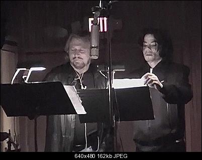

    I processed the whole video, you can download it here.. that poor texture is the main problem I wanna fix now: http://www.mynetdomain.de/mathmax/All_In_Your_Name.mpg

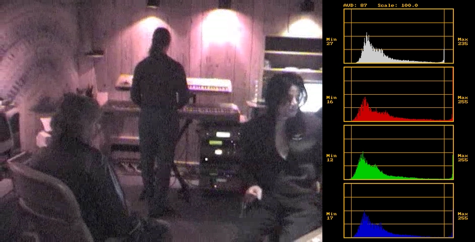

    I played with SmoothLevels v2 this morning. Haven't used it in a while. Had the old version on my PC. I didn't use it much in the past because it's clamping at RGB16 and 235. But I see new settings that might alleviate that. Will try it later. The main idea is to adjust levels to prevent clipping the illegal brights and darks. More than one way to do that. I had set up a "safe averaging" quickie with ColorYUV, to be tweaked later.

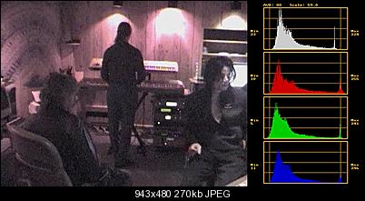

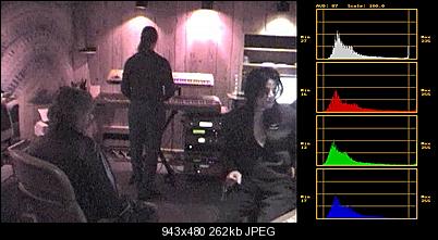

    The way many observe levels in YUV is with Avisynth's "Levels" histogram (YV12 only). The images below show frames 1162 and 5016 with that histogram. Adjust luma (top white part of the histogram) to stay inside the colored side borders. In these scenes you can see luma creep into the right-hand margin.
    [Attachment 11213 - Click to enlarge]
    [Attachment 11214 - Click to enlarge]
    Originally Posted by mathmax View Post
    Moreover, if you compare the histograms, the one with ColorYUV has some vertical strips that are not present with Smoothlevel(). I don't really know the reason for that..
    By stripes, if you mean the luma "peaks" in that scene, it would indicate mild luma banding. But I didn't get to that scene in processing, as its levels are completely different problems from the other sequences. I would have made a separate ColorYUV setup for those shots.
    But I wonder why the histograms in RGB have high intensity around 235 whereas it was around 220 in the simple histogram (for smoothlevels). And some values in the RGB histogram even get higher than 235... I don't understand this difference between the two histograms. And could you remind me why DVD should be between 16 and 235?

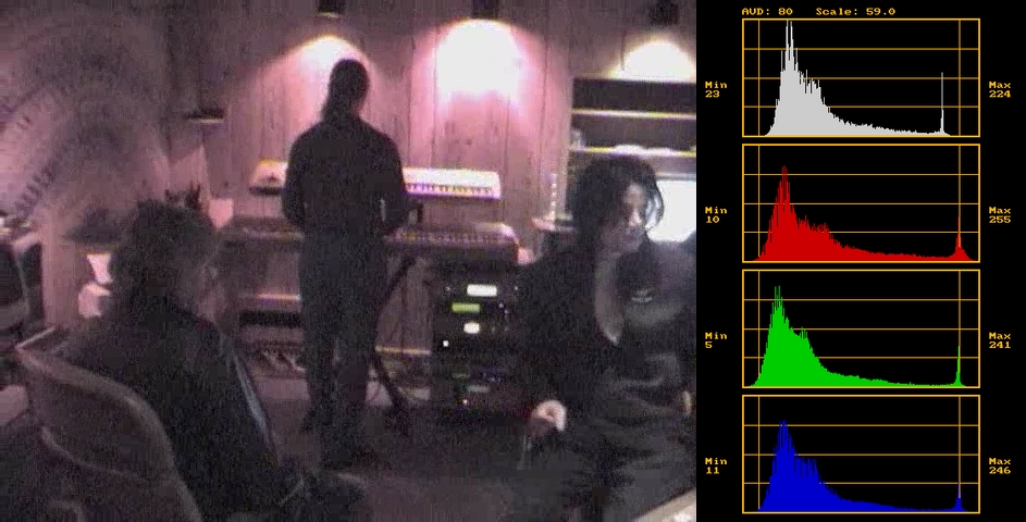

    When YUV is converted to RGB (either in your PC or on your TV, brights will fall outside the legal Rec601/Rec709 standard and will look too "hot", if not washed out. With some encoders that attempt to adhere to broadcast/DVD standards, those brights will often start to change color, usually turning cyan. RGB histograms below show how those uncorrected YUV scenes will be translated into standard RGB matrices.
    [Attachment 11215 - Click to enlarge]
    Where you see parts of the histogram climbing up the right-hand wall, those elements are being clipped on conversion to RGB. YUV and RGB are two different matrices; the former is for video data storage, the latter is for display.

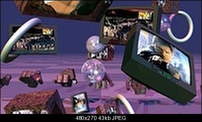

    I spent most of the night trying to discover why mosquito noise sparkling around some highlights in some scenes has suddenly appeared. Really annoying because it's not everywhere and won't go away. It appears right after running MCTD on this rebuilt PC - it's not that it shows up after later routines like QTGMC or NeatVideo, it's there from MCTD on. It's not in my mpg posted earlier, and it's almost entirely cleaned up in yours. Bummer.
    Meanwhile, I came up with a fix for some of the false contouring and posterization you objected to. I think that's what you meant earlier when you used the term "texture". The problems come from the overload of compression artifacts in the source. I tried two changes that made visible improvements:
    a) after running QTGMC, try running gradfun2dbmod(thr=2,str=0.9,mask=false). Helps with blocking and color banding.
    b) Increase NeatVideo's temporal setting from 2 to 3. Also helped to smooth that long zoom shot a bit (I really hate that shot. Zoom lenses should be removed from all amateur cameras!).

  15. Thank you for the links, sanlyn.
    However there are some shadow points that I don't really understand:

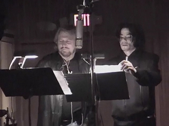

    • First, I observed the RGB histograms for the frame 6211
    original
    smoothlevels(0, 1, 255, 0, 235, limiter=2)
    I wonder why on the first histogram the luma is clipped to 235 whereas the colors are up to 255. This difference remains on the second histogram. The peaks are just shifted by 20 to the left. Could you explain this difference between luma and colors? Does that mean I should still reduce the luminosity until all colors are under 235?
    • You said that you would correct the midtones by editing the gammas. But I don't really see how you can see this problem from the histograms. And I have no idea how you would tweak the gammas for each color.
    • By stripes, if you mean the luma "peaks" in that scene, it would indicate mild luma banding.
      yes.. isn't that luma banding annoying? At least SmoothLevels() produce a smooth histogram..

    • The main problem remaining is that the video looks like a cartoon after denoising. If you look their faces, this is very clear on the following frame. It looks like the skin is chipped.
    I tried gradfun2dbmod(thr=2,str=0.9,mask=false) but it doesn't seem to help... I'm now wondering if our settings on MCTD() were a bit strong..
    original
    I posted a set of YUV and RGB histograms for the same scene, showing what happens when no corrections are made and YUV gets translated to RGB. I didn't use any corrections for the scene shown because I never got that far into the video during processing. But the corection shown would have brought everything down to a manageable level. I wouldn't have handled YUV in that scene in that same way. I would lower red and raise blue, with less luma correction.
    You're thinking in terms of RGB (because that's the way we "see" things", but not the way image data is stored in YUV. I'll look for a web page that describes the difference, but consider this:
    Let's say you're walking down the street at night and you see a blue neon sign. When you're standing right in front of it, the blue (its color or HUE) is very bright (luminosity). It's so bright it hurts your eyes to be so close to it. Now, walk down the block a while and look at the neon again. It's still blue (HUE), but not as bright (luminosity). The farther away you get, the darker (luminosity) the neon looks, but it's still the same blue (HUE). Now, most neon signs have a certain characteristic: within limits, you can turn down the brightness, but it's still the same hue.
    Reduce luma to get everything lowered? Eventually it would, but you'll have a very dark image. You'd reduce luma and color both, if needed. SmoothLevels does a bit of that. The luma indicates overall contrast in the dark/bright range. Luma refers to the intensity of LIGHT. Chroma is stored separately as an intensity of HUE. We humans don't store image information with brightness and hue separated. In YUV The colors won't necessarily agree with luma in shape: a scene could have lots of very dark reds in the range of Red 30 to 128 (YUV doesn't use "RGB" numbers. Those are interpreted later). You're dealing with two color spaces that store values differently. YUV stores chroma separately from luma. RGB stores luma and chroma together. In both a YUV and an RGB histogram, that darkish to medium red line would go only halfway across the graph, assuming no other higher hues of red are in the picture.
    Those peaks aren't major, more difficult to see than they look on a graph. This particular scene has lighting problems, to an extent that I wouldn't use the same ColortYUV setting for any of the scenes shot in that room. The camera's auto exposure meter didn't do that scene any favors. A pro would have used fill lights for a scene like that. Yellow (Red + Green) is oversaturated. You could adjust some of that in YUV, but it's easier in RGB.
    If you look at the YUV histogram with no corrections, you'll see little peaks elsewhere in the video. The objection I have to SmoothLevels is that it doesn't reduce overbrightness, it clamps it. Not the same operation. Lowering high contrast means gradually lowering the high range of luma/color to lower values; clamping means changing the overbright values to lower values at a cutoff point. IF you see a value higher than 235, you reinterpret it as 235. 254 becomes 235. 248 becomes 235. 240 becomes 235. Lowering a high range by gradually compressing values from the midrange on up and making them gradually lower keeps the information, it just makes it "darker". If you lower "Contrast" in color YUV, you compress that range without discarding the information. That's a difficult concept, I know. In SmoothLevels' favor, the clamping seems to be more gradual than the usual method, but it's still clamping.
    That "shift" of 20 points to left that SmoothLevels was doing: not the perfect way, but it did save some detail in Red. I posted YUV and RGB histograms of the same two uncorrected scenes to show what happens when YUV gets translated into RGB without prior adjustments.
    You asked about autogain...? Autogain tries to make everything look like an ideal histogram in broad daylight. That won't do for dimly lighted rooms (look at what it did to those listening room shots). Try it in a night scene and see what happens, or in a scene where someone moves from a bright or darker area into a different one.
    In general I don't think so, but MCTemporalDenoise can be modified. I'd cut its sharpener a bit and increase TTempSmooth's softening. The MCTD document shows how. I'll be trying that later. gradfun2dbmod did make a difference. It evened out some banding lines in shadows and cut down posterization and even a little shimmer in many shadows.

  25. @sanlyn: Regarding the first point, I didn't formulate well my question. I was wondering why the colors' peak were around 255 whereas the luma peak is around 235. If the three colors have high intensity around 255, the resulting luma should be intense around the same value, shouldn't it? And then, I wondered if all the colors should be under 235..
    You're right about the yellow oversaturated on bright areas.. and it's all along the video. Is that why you want to lower red and raise blue?
    I understand well why it's easier to work on RGB because we can tweak each color individually.. but don't you lose quality with YUV->RGB conversion? And I thought, Colormills or such plugin allows to work on each color individually and then convert the settings in term of YUV... this approach, as far as I understood it, would allow to have RGB logic for the user and keep the YUV format for the video itself.
    You say SmoothLevels() clamps the value to 235 but I think that is not the case if the limiter is set to 2. If you look a the 2 histograms posted at the top of this page, you'll see that they both preserve values above the vertical white lines. If the values were clamped, there shouldn't be any white above these lines, right?

    I looked again gradfun2dbmod.. but I still can't really find where it makes a difference. Could you illustrate with some screenshots?

  27. Originally Posted by mathmax View Post
    I think this is from your color tools setup. If you set source attributes to 16-235 in the configuration, you will see it go to RGB 255
    Actually, limiter=2 clamps Y' 16-235 , and CbCr 16-240 . By default, limiter=0 (no clamping)
    What I think sanyln was talking about is the hard white line - that's hard clipping from the camera - it goes beyond the lattitude of the capability of the sensor
    "clipping" is different than "clamping". Clipping suggests everything is cut off beyond a certain level. Clamping suggests everything is "squished"
  28. Originally Posted by poisondeathray View Post
    ah ok.. but why are the scales of the RGB colors not altered by this attribute?

  29. Originally Posted by mathmax View Post
    I'm not sure, and it really doesn't matter, it's just a monitoring tool, it doesn't affect the actual video. I don't even know why it's there as an option. The actual RGB values are governed by how the Y'CbCr => RGB conversion was done. If you didn't specify, and let vdub do it, then it will use Rec.601 matrix . Eitherway it would be reading off the RGB values (not the original video) and applying the equation to get the luma, not reading the luma directly.
  30. Banned
    New York, US
    This is getting into good color stuff, especaially the techy part of how YUV and RGB display color info. The progressed video has 1.3 hours to go, but it's getting late. Thanks, jagabo for"ulliminating" us (sorry for that) on more about YUV.
    To answer mathmax about why the color peaks at 255 but the luma peaks at 235: the luma peaks lower because the HUE might be, say, a very reddish red or a very bluish blue, but it's not giving off 255 bucks worth of light. Recall the neon sign: the farther away you get the more it loses brightness, but it's still the same blue.
