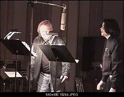

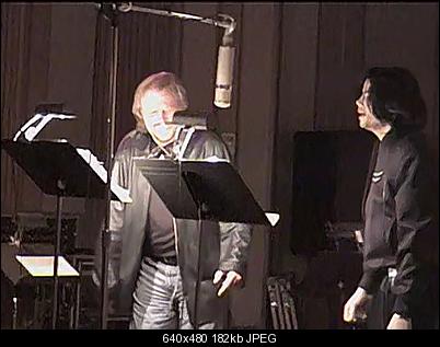

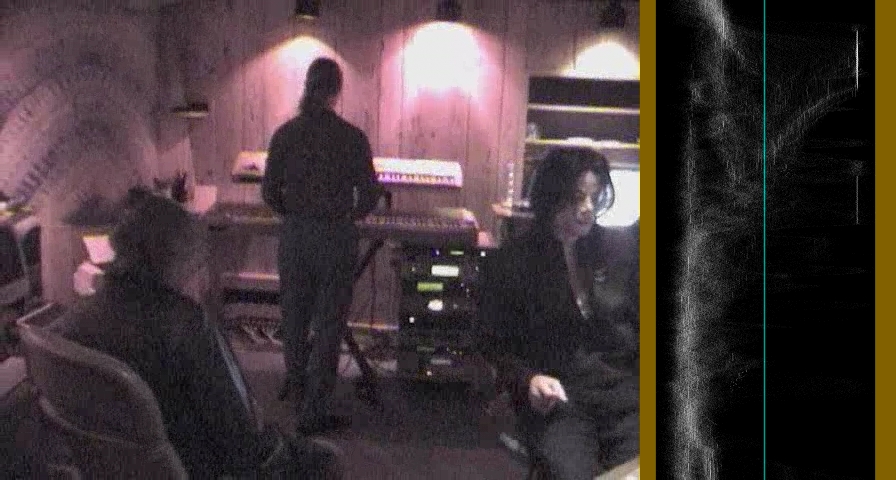

    I have a video that suffers two problems. It's badly compressed and it has a lot of noise. I could use Deblock() from Manao but I wonder which denoiser to use... also I wonder in which order should I process: first denoise and then deblock or the contrary?
    Here are two screeshots (the blocking is irregular, very present on some frames and not so much on other..)
    You can download a sample of the video here: http://www.sendspace.com/file/glg6qo
    I know the compression doesn't help to denoise.. and I don't expect a miracle. But I hope I can enhance even a bit..
    Thank you in advance for any advices

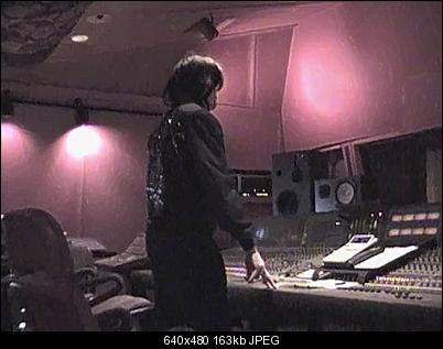

    I tried with these parameters:
    loadCplugin("C:\Program Files (x86)\AviSynth 2.5\plugins\ffms2.dll")
    FFMpegSource2("D:\Bureau\all in your name\AllinYourName.m4v")
    MCTemporalDenoise(radius=3, sigma=16, twopass=true, limit=0, limit2=0, bwbh=8, owoh=4, blksize=8, overlap=4 )

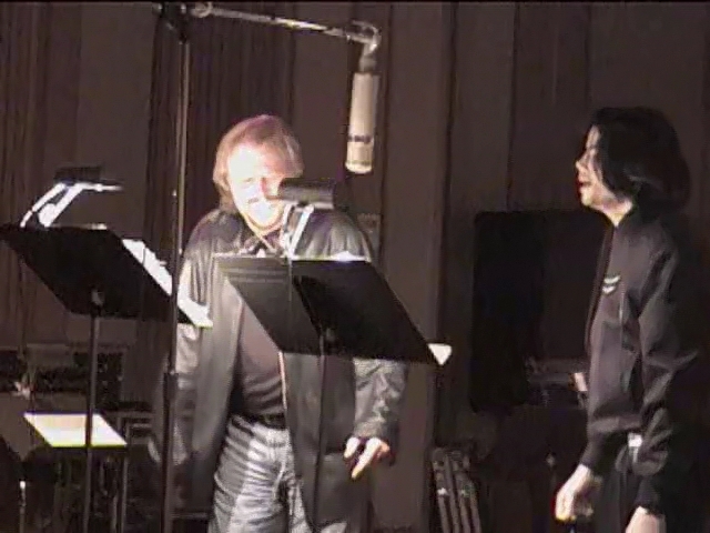

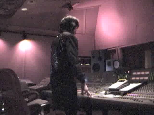

    However, there is a problem this filter.. suddenly, some frames becomes dark. Please watch the following clip:
    http://www.mediafire.com/?dyu11p29fxe6ei2
ID:	10231Click image for larger version

    It's an improvement, anyway. In MCTemporalDenoise you might be giving values to parameters that by default are already set according to the general mode settings (low,medium,high,etc.). You might try MCTemporalDenoise's default mode, as they usually run some very sophisticated routines automatically. Try this one:
    MCTemporalDenoise(settings="very high")
    It will slow it down, but don't expect to find "fast" filters to do all the work this video needs.
    The frames don't darken, they flicker. Several experiments using the vDub Deflick filter called into AviSynth have been done in this thread recently with a script by jagabo: https://forum.videohelp.com/threads/341188-Still-have-flicker-after-Denoising-with-AviS...=1#post2128405
    Since this video is already progressive, you won't have to bother with IVTC, etc., but DeFlick and MCTemporalDenoise are called this way:
    To load DeFlick in Avisynth:
    LoadVirtualDubPlugin("[path to VirtualDub folder]\plugins\deflick.vdf","DeFlick")
    Thyen, inside the avs script call DeFlick and MCTemporalDenoise in this manner:
    ConvertToRGB32()
    DeFlick(8, 0, 0, 10, 0) #window size, softening, interlaced, sc threshold, show sc
    ConvertToYV12()
    McTemporalDenoise(settings="very high")
    The colorspace changes aren't that critical here, as the video9's not in such great shape anyway, but apparently there's little harm going on in the videos we've used these lines on.
    The html documentation that ships with MCTemporalDenoise has a chart showing the default values and procs called for these mode settings.

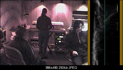

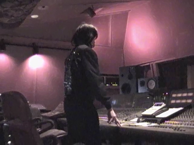

    Here are screen caps comparing the two filters. Ignore the NeatVideo logo on lower right, as I said this is an older demo-only version. The major difference is in motion noise and edge smoothing. NeatVideo looks cleaner in some respects, MCTD in others. Both filters require more tweaking. My past experience with noise like this is that, ideally, a combo of a lower-power MCTD followed by a lower-power NeatVideo (or some other temporal smoother) gets the best from both filters and yields better results.
    MCTemporalDenoise (frame 222). Edges show more remnants of artifacts, but interior detail looks sharper.
    [Attachment 10279 - Click to enlarge]
    NeatVideo (frame 222). Fewer artifact remnants, cleaner edges, but better noise sample needed to maintain detail.
    [Attachment 10281 - Click to enlarge]
    MCTemporalDenoise (frame 486). Problem cleaning lines/edges with camera motion, especially on the left.
    [Attachment 10282 - Click to enlarge]
    NeatVideo (frame 486). Cleaner edges and motion, but poor noise sample softens fine detail.
    [Attachment 10283 - Click to enlarge]

    Some frame captures show progress, if nothing else. Below, left: Frame 32 has very little camera motion, and Frame 228 (below right) is similar. Not images like "real" DV or DVD, but much cleaner -- as long as the camera doesn't move!
    [Attachment 10389 - Click to enlarge]
    Below, frames 474 (left) and 1137 (right). Frame 474 is a fast zoom-in with the background objects wiggling like wild salmon, while everything else fares OK. You'll see faces change shape a bit as the camera gets closer. The next few scenes look relatively normal. So, while detail is comparatively stable and grain and stuff are manageable, motion noise is what I'm after now.
    [Attachment 10390 - Click to enlarge]
    Shots like frame 2866 (left) play tolerably well, considering the source, and even people motion looks OK. But as soon as the camera moves or zooms in (frame 3125, right), Michael and the music stands are OK, but everything in the background turns to simmering mush.
    [Attachment 10391 - Click to enlarge]
    A .zip file of the six 640x480 frame images is attached below.
    I ran other plugins, but it was soon apparent that camera motion is the big bugaboo. IMHO it should be fixed before any further treatment. Using more smoothers is out of the question; they don't fix much of anything past this point, and they make people look as if they've pulled stockings over their heads. After about 4 hours of searching Doom9's endless thread about mvTools (and managing to stay awake most of the time), it seems some form of compensation/object rebuilding should be possible. I haven't the slightest idea how to do that using mCompensate, and the documentation is somewhat obscure (to me, anyway). As for more denoisers and degrainers, they're a waste of time. If anyone has any idea on how mvTools could help calm some of those wiggles, we'd all appreciate hearing about it. Meanwhile, I'll keep looking.

    Step 1: I ran this script in avisynth. It is really slow (45 minutes to get the first 3647 frames). Not unsual for MCTD at highest setting, but gets even slower if you fiddle with individual settings -- which I did, but with no advantage that I could see. A copy of the avs is attached to this post as well.
    DirectShowSource("G:\forum\AllIn\AllinYourName.m4v",fps=23.976)
    ColorYUV(gain_y=-30,off_y=-4,cont_y=-10)
    in1=last
    e=in1.AssumeBFF().SeparateFields().SelectEven()
    o=in1.AssumeBFF().SeparateFields().SelectOdd()
    eMC=e.MCTemporalDenoise(settings="very high")
    oMC=o.MCTemporalDenoise(settings="very high")
    new_clip=interleave(eMC, oMC).weave().ConvertToRGB32(matrix="Rec601",interlaced=true)
    return new_clip
    I'm bound to get comments about SeparateFields(). Yes, this is non-interlaced YV12 (allegedly, anyway). I find that separating fields with YV12 sometimes helps some filters in rare cases. My guess is this: at some point in the criminally clumsy pre-processing of this video, field order or field dominance got shifted in YV12 (whether it was interlaced back then or not is anyone's guess), and YV12 chroma got screwed up. That's the least of the problems, but that's my minimally-educated guess. Anyway, if anyone balks at the use of using SeparateFields, let them explain this:
    Same script, without SeparateFields():
    [Attachment 11146 - Click to enlarge]
    Same script, using SeparateFields():
    [Attachment 11147 - Click to enlarge]
    Try it yourself for a few frames and see the difference. I'd be very interested in seeing an explanation. Seriously.

  29. So.. I finally followed your steps and here is my feedback
    step 1
    - first, I'm a bit surprised the way you corrected the luma range. I already asked about that earlier in the thread, but I still don't get exactly how you chose the values gain_y, off_y and cont_y. I'd rather edit the levels out of fear to distort the scale. Moreover, I feel that you decreased a bit too much the upper limit. But I might be wrong about that... I admit I don't know well the reason why you chose this way. I uploaded below samples for each methods. Please don't hesitate to examine them.
    smoothlevels(0, 1, 255, 0, 235, limiter=2)
    - I'm also surprised of the difference with and without SeparateFields(). As you advised, I checked several frames carefully and I could notice that the noise is more reduced and the edges are cleaner when working on separate fields. However, there is a comb artifact, which I think might come from frame averaging in MCTemporalDenoise(). So I applied QTGMC() to get rid of this artifact and the result amazes me. Please compare the following frames by switching in separate tabs:
    MCTemporalDenoise() on progressive frames:
    MCTemporalDenoise() on separate fields:
    MCTemporalDenoise() on separate fields + QTGMC():
    The last ones really looks clean.. I even wonder if that is needed to apply neatvideo on the top of it..
