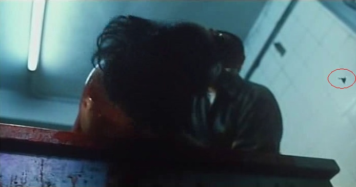

  4. k.
  5. Banned
    New York, US
    I think that's more like a spot than a scratch.
    Try the RemoveSpots() function mentioned in this thread: https://forum.videohelp.com/threads/341188-Still-have-flicker-after-Denoising-with-AviS...=1#post2129254
    Note that RermoveSpots works far better if your video is IVTC'd as in the script in the above link. All most all scratch and spot filters require IVTC, deinterlace/reinterlace, or at least SeparateFields() to work properly.

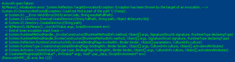

    If you refer to RemoveSpots(), it doesn't use RemoveDirtMC. It uses the simpler version of RemoveDirt() which is a script, a dll, and several support files, some of them also used by MCTD. The "MC" version requires users to get fancy with some Microsoft .Net support files that are almost impossible to get straight, which is why it doesn't load for many users.
    I believe I acquired all dependencies, but I'll let the error speak for itself. See attachment.

  11. Banned
    New York, US
    NLMeansCL is the problem for everyone. Everything I've read sez Avisynth doesn't recognize the commands that load some .Net support files. If anyone has a solution for it, I've never found it. Avisynth can't load AvsFilterNet.dll, or its partner NLmeansCL .net plugin. The author's official command for loading this stuff is:
    LoadPlugin("[path to Avisynth plugins]\AvsFilterNet.dll")
    LoadNetPlugin("[path to Avisynth plugins]\NLMeansCL_netautoload.dll")
    The plugins aren't your usual .ddl. They were written with .net c+ and require special loaders. I have yet to see anyone make it work. I'd like to see the solution myself. As far as I can tell, the only users who can make this thing work are those who have the full and latest Microsoft .Net development package on their 'puters.
    As for RemoveSpots: it works on spots, freckles, sometimes scratches or "strings". It doesn't work on anything else. You should do your other denoising first, before using it.
