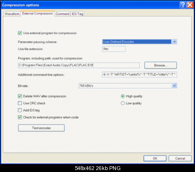

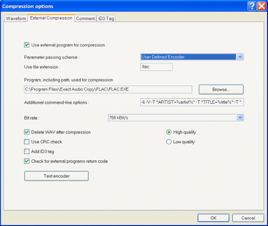

  5. Member Cornucopia's Avatar
    Nah, I'd use ExactAudioCopy and fine tune the mp3/Lame settings by hand to what you want. The ripping is cleaner (the best there is, IMO) and you always get exactly what you asked for automatically.
    Here's an example of mine (though I am currently using FLAC in compression settings, not mp3):
