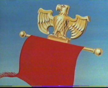

	1. The default video size is: 352 X 288.
 2. I have included sample video screenshot at this resultion, showing also the bottom line
 I am having problem with.

	It's highly unlikely you will see those lines on your TV once you get that to a DVD. If you do see them...it's better to mask the lines (10px of black - but do it on all 4 sides to make it look better). Masking the lines does not alter the image size(when done correctly) which is crucial for DVD specs.
