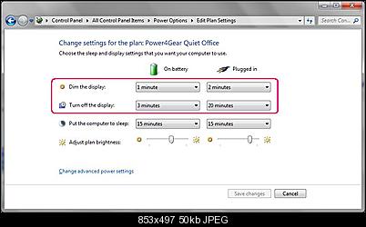

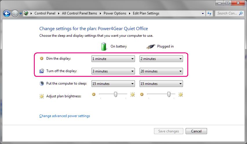

    This is for my laptop with W7, but similar to XP:
    Your monitor may have internal settings that apply to this also, but that would be unusual. I would go with the suggestion to try a different monitor. If it's not the PC or monitor internal settings, you may have a failing monitor.
