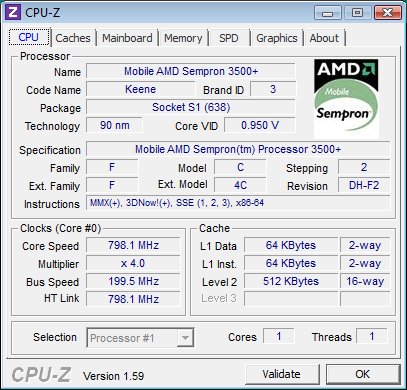

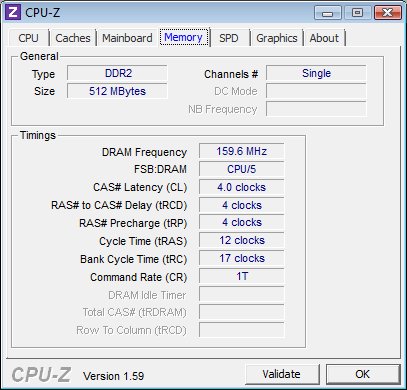

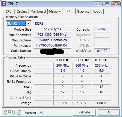

    I have a Dell Inspiron 1501 laptop that I would like to add some memory to. I am only using it to "do internet" occasionally since I keep it at my GF's house and I don't want to use her MAC (I hate 'em).
    The issues with it are the following:
    It has Windows Vista, perhaps the only thing I really need to so is wipe the hard drive and install XP. XP drivers are available for this laptop.
    I really don't know if the BIOS settings are correct.
    I think it has PC4200 memory, and only 512MB of it. It has one open memory slot that can take up to 1GB more memory in that as per the manual (it's unclear to me as to if the BIOS update I did allows for more memory, but I'm not planning on going past the original 2GB limit anyway).
    It's rather slow (probably has something to do with the Windows Vista comment above).
    My CPU-Z's screen shots are attached.
    Do the speed settings for the memory look correct? Does it really have PC4200 memory in it (the listing for PC4300 implies that). Will another 512MB stick of memory do me any good if I still have Vista installed? It's seems to be cheap and easy enough. 512MB DDR2 laptop PC4200 or PC5300 sticks on eBay (used) sell really cheap. I actually tried to install Fedora but it would not install, saying that I did not have enough memory.

  4. Member edDV's Avatar
    Mar 2004
    Northern California, USA
    Crucial has a good memory scanner that will display upgrade options.
    http://www.crucial.com/systemscanner/
