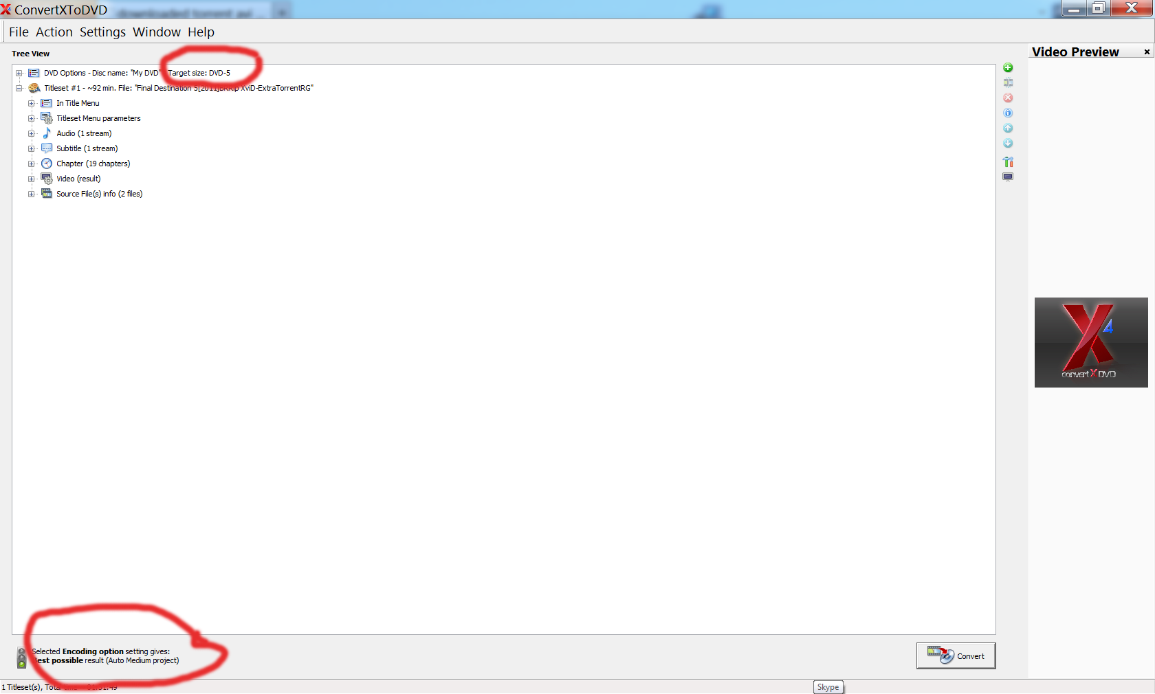

    That being sad you must specify the target of the dvd ( dvd5 or dvd9) like on the picture
    and no mater what the size ( its the duration that maters) it will fit the targeted size, one thing that will change like in the bottom of the picture is the quality ( regarding the bitrates necessary to squeeze the files to the dvd
