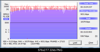

    see, here is the original:

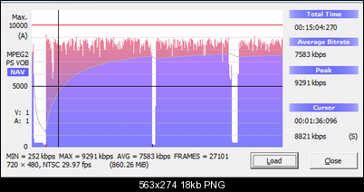

    and here is the re encoded file:
    why can't AVStoDVD encode up to 10500k like the original?
