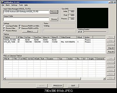

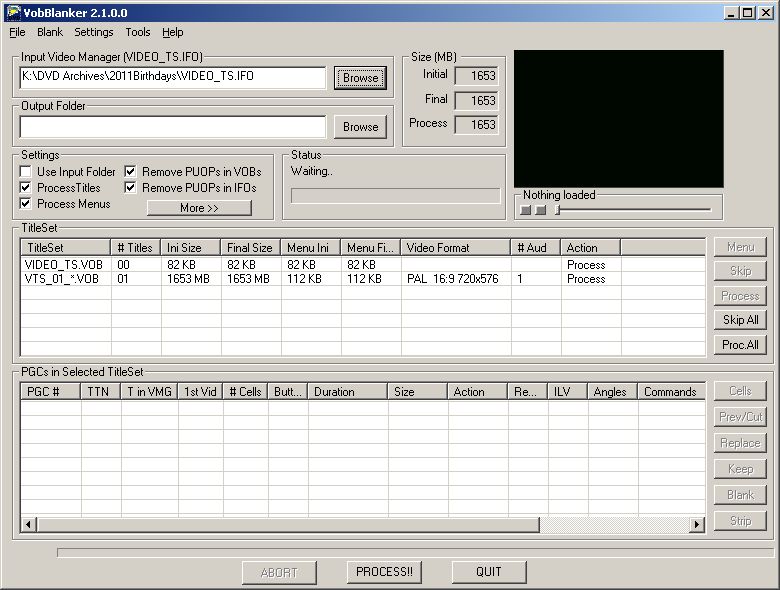

    Now I've tried VObBlanker. I loaded it. It wasn't obvious, but I assume I did the correct thing by using the Input Video Manager section to open the IFO of my target DVD, giving this:

    What now? The only thing I could think of was clicking Process. That gave this obscure message:

  7. Assuming that the menu to be edited is in the VTS_01_*VOB in your picture above, highlight that line. Then the menu button to the right will become black and clickable. Click on it and in the new menu screen will be your menu. I guess there's only one, but highlight it so that it also appears in the lower window. Highlight it there and hit the Preview button to the right. In the new Preview screen hit the BMP button to save out your menu as a BMP. Edit it to fix the text and then replace it by following the instructions in The Easy Way part of the guide.
    If you have any problems doing the replacing, come back here.
