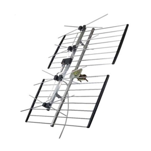

    My antenna is on a pole mounted on my chimney ... its a bowtie type of antenna. It's 1:30 AM and I can't take a picture of it at this time ... but I will but here is a picture of sort of what it looks like ...

    When I post the actual picture it will be quite different. I do want to say I added extra insulation where the plastic was placed between the elements. The section where the electrical connectors made contact ... I made a solid connection and then wrapped black tape all around that area.
    Going back to the 80s ... I've seen what the Wind ... Sun ... weather ... can do to antenna wire and back then it was 300 OHM twin lead. And so I beefed up everything in the area of the antenna ... on my patio cement floor and then hoisted it up and mounted it.

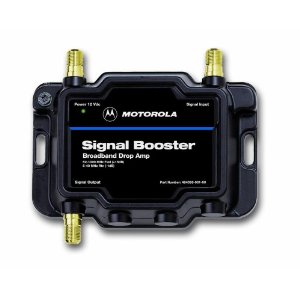

    Anyways ... cable comes down from antenna ... goes to a Motorola Signal Booster 484095-001-00 Amplifier

    And then to a splitter ... one cable goes to the living room setup and another cable goes up into the attic where another Motorola Amplifier is connected ... and then goes to another splitter ... which one cable goes to my bedroom setup and another cable to my PC in the bedroom.

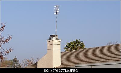

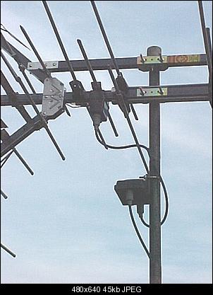

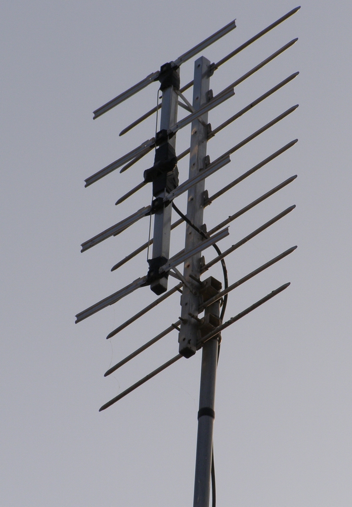

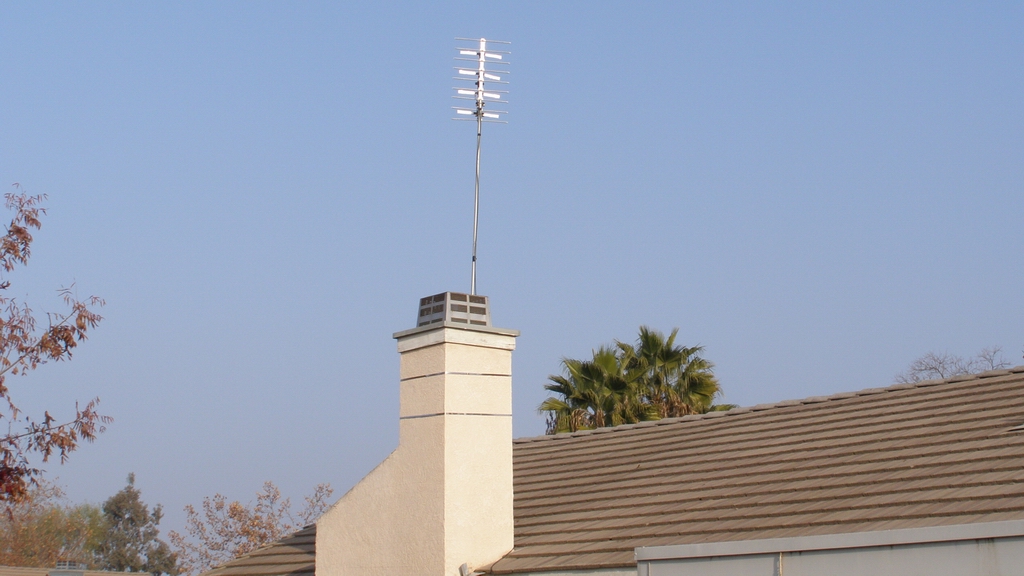

    Okay ... here are two views of my antenna ... as you can see ... I dont have any obstructions ... to the North East.
Name:	My Antenna Closeup - 1.jpg
Name:	TV Antenna - 1.jpg

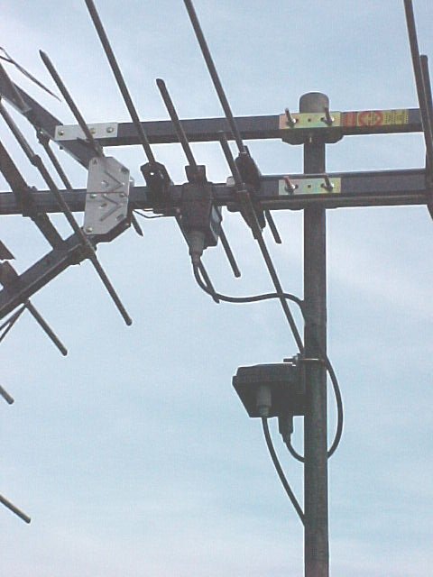

    OK my first take is back to signal quality at the antenna. The antenna must be pointed to the transmitting antennas and the antenna itself needs to provide adequate directive gain. Explain your proximity to the transmitters using the TVFool tools.
    Second, in fringe areas with little multi-path issues, a pre-amp might help. What you are using is not a pre-amp. The pre-amp sits up on the pole at the antenna to boost signal to noise before more noise is added in the coax coming down and the rest of the distribution system.
    This is a typical antenna pre-amp
    http://www.google.com/#q=TV+antenna+pre-amp&hl=en&prmd=imvns&source=univ&tbm=shop&tbo=...w=1020&bih=851
    The model used depends on your local need for VHF/UHF or just UHF reception.
    The mast mount pre-amp can increase signal to noise. Distribution amps later in the path just compensate for gain losses from splitters. They don't improve signal to noise they boost signal and noise equally and may add noise themselves and/or favor some channel frequencies over others. They are only needed if the tuner lacks adequate input gain.

    The antenna has been up since at least 2006 and HDTV Digital was not in my card deck yet. I remember when I got my [summer of 2005] Sony 51 inch "HD Ready" TV ... I didn't know what HD was ... the guy at Sears did a terrible job trying to explain what HD was. We left [my wife and I] and went to Circuit TV and got the same TV there. The lady salesperson did a better job of explaining.
    My idea of recording TV signals was based on ATI AIW cards back then.
    Anyways ... The antenna signal going to our Directv HR10-250 has no problem [except for not being able to record to the harddrive inside since Directv has shut off our service ... we still can watch what our antenna can pull in.] Our Panasonic DVRs can pull everything in but the ATI 650 PCI cards are having problems ... including the one in my PC.
    I haven't done a decent diagnostic ... mostly because ... Christmas decorations are being put up ... leaves on our front yard are being raked up and moved to the back yard ... I am going to spread the leaves around the area where we have our garden each summer and give the dirt / soil ... some new life.
    I kind of think I posted this thread before being able to answer the questions being asked.
    I really dont want to take down the antenna ... and redo it. Money wize ... I dont have it for adding a preamp on the mast. If I do it the way of "your" picture ... I would have to take it down and man it was a pain in the butt doing it by myself.
    I find it peculiar that I'm having problems with ... "weak TV signal" on my setup in the garage. This problem was not happening a month ago.

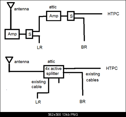

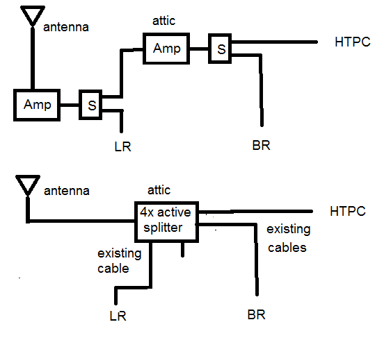

    The top drawing is my understanding of your existing system. Cascading amps and splitters causes signal falloff due to noise buildup.
    Instead, bring the antenna cable into the attic to a single 4x active splitter. This would use your existing cables and give an equal quality signal to all.
