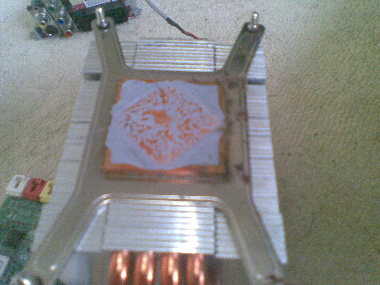

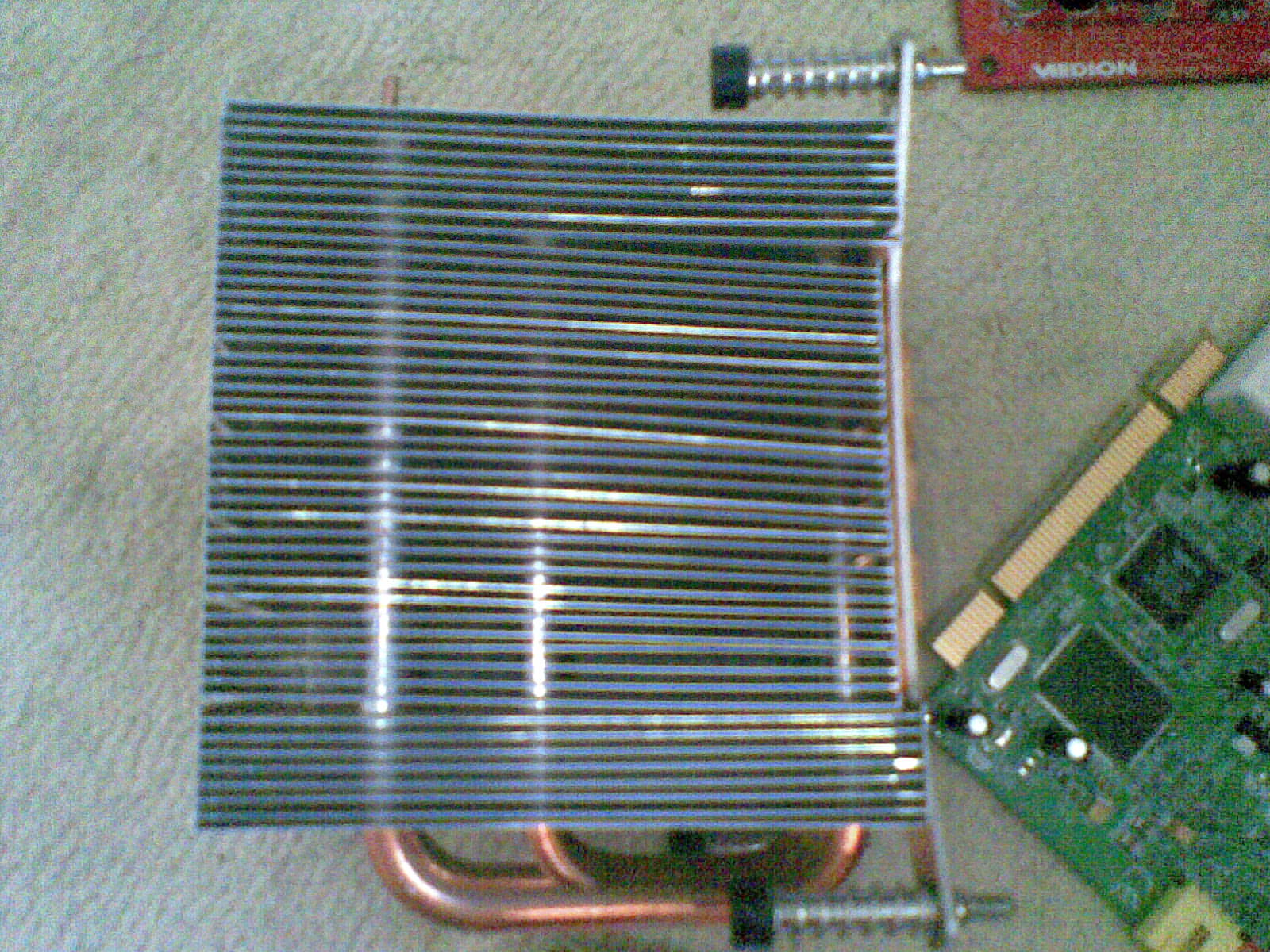

    A slight concern though... the CPU has a heatsink i have never seen before. A great big finned aluminium block instead of a fan.
    took off the block and noticed that the blue glue has turned to a powder and it does look like its got incredibly hot.
    Ive done all those isloation tests such as removing ram hard disks, video card, etc etc and still its the same issue.
    I think it could be a fried CPU. Looking at the mess on the block protecting the CPU it does look like at some stage its got very hot.

    I've heard of fanless heatsinks, but only ones made of copper. I wouldn't use one but if you are insanely sensitive to noise and you don't have a really powerful CPU I guess you could consider it. Sounds like you don't know anything about this PC since you didn't put it together, so it could just be some numbskull's project that went horribly wrong because he didn't know what he was doing.

    Aah i got ya maybe it is copper actually then and not aluminium! It's huge though!

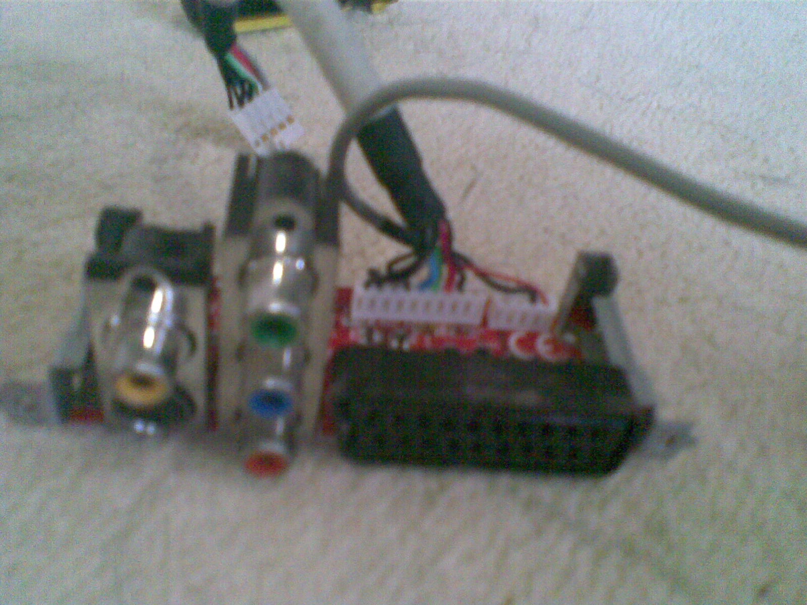

    I have never seen a MOBO quite like this one infact it has a board going form the video card with a scard connector and tv out on it etc along with a load of other internal boards which ive never seen before.

    Sounds like the thermal compound between your CPU and heat sink dried up. That's pretty common but now you have to make sure you replace the thermal compound before replacing the heat sink and turning the computer back on.

    Was there originally a hood/shroud with an attached fan located above the CPU and heat sink? I have seen some older pre-built machines which had that kind of cooling system.
    Anyway, as was already stated you will need to clean the old thermal paste off of the CPU and heat sink and apply new thermal paste to the CPU before re-assembling them. There are some video guides available on YouTube and some retail websites specializing in computer parts that will demonstrate how to do that.
  9. Lots of Dells used a heatsink like that. LOTS and LOTS of them. Some had some copper, but many were just plain aluminum. Usually with a shrouded fan on the back of the case. Got six or eight of those heatsinks in a drawer.

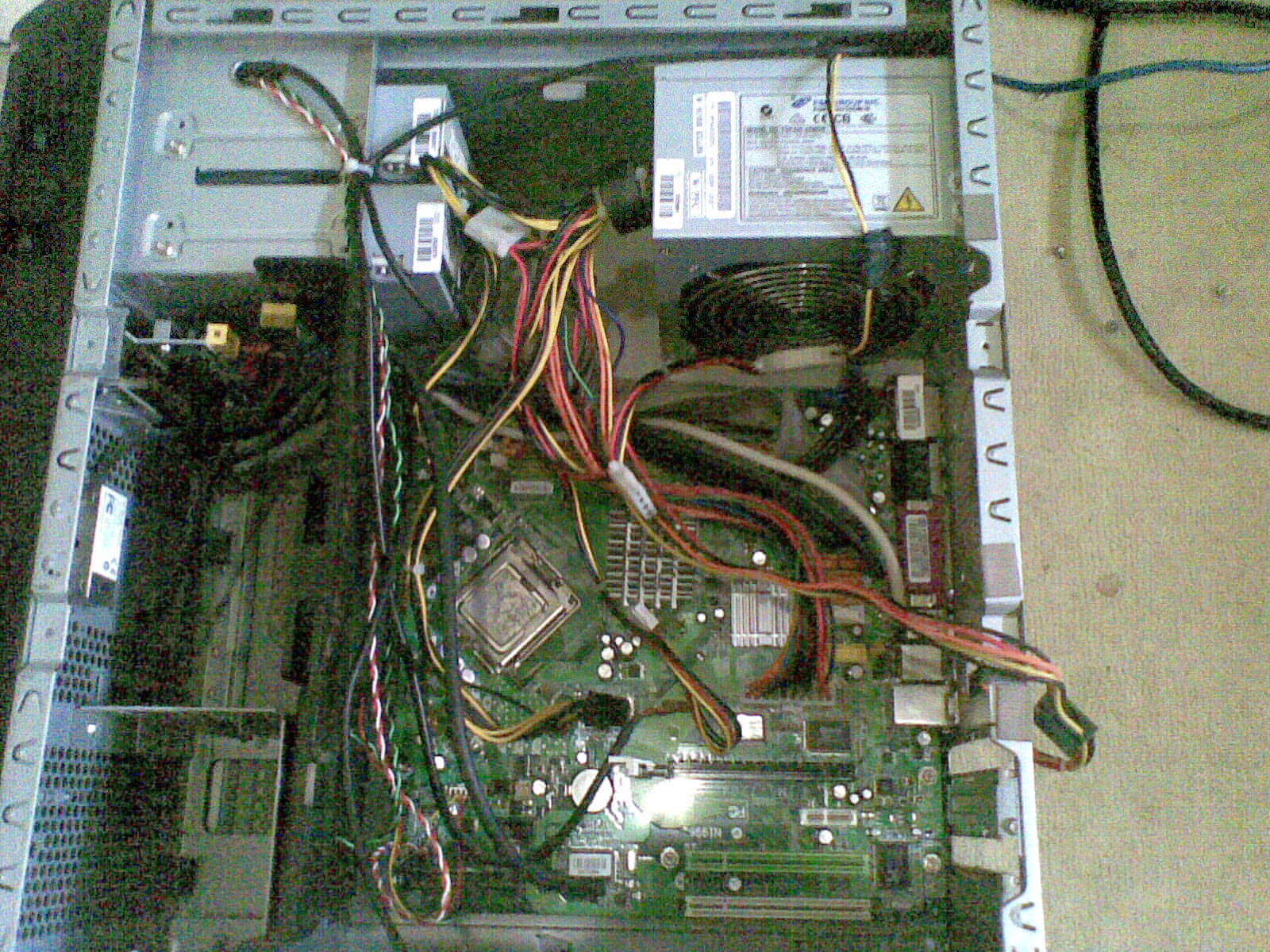

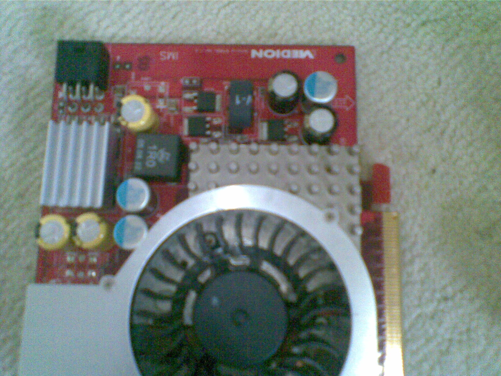

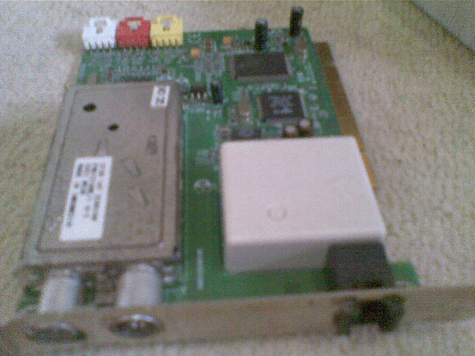

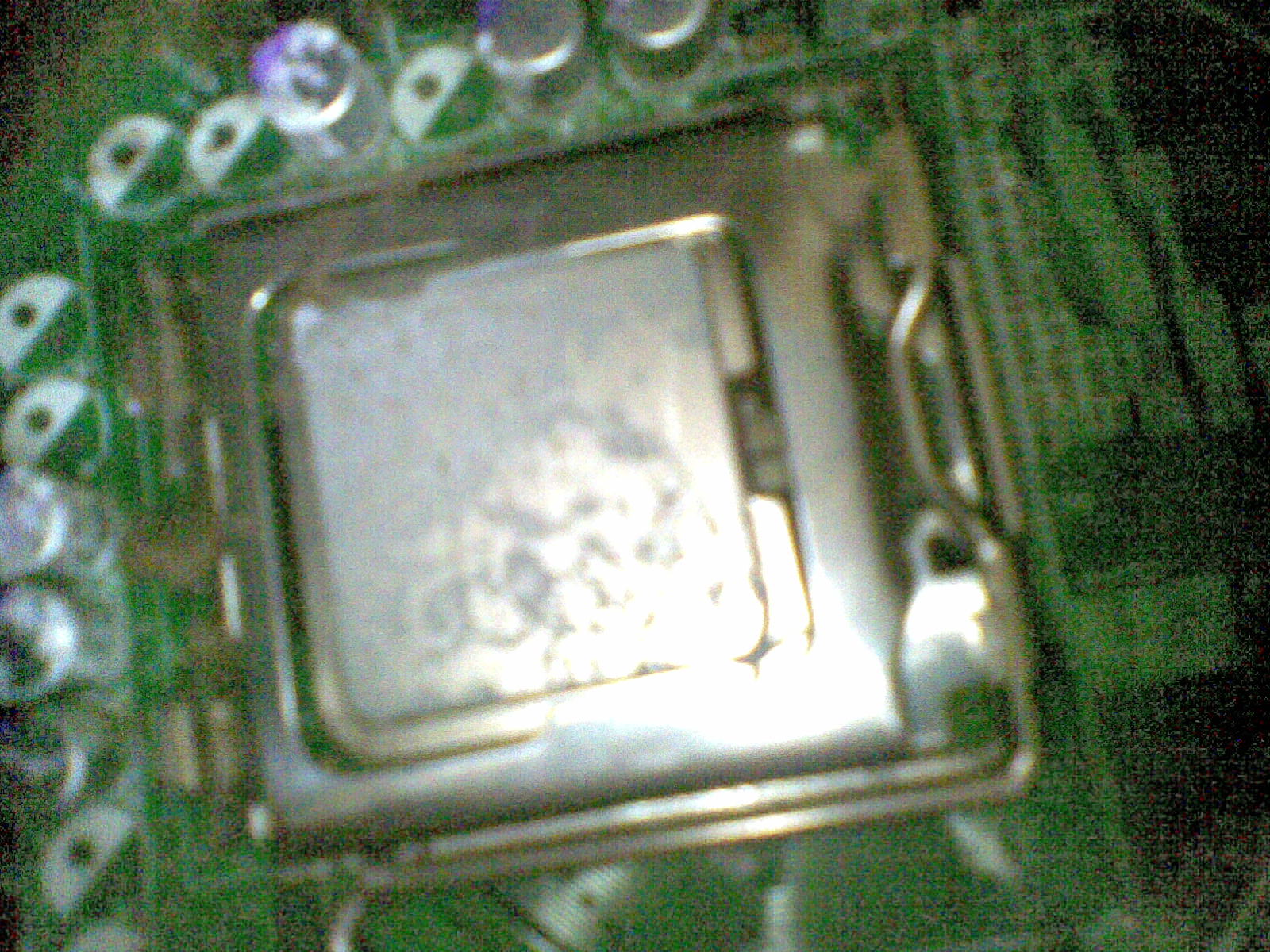

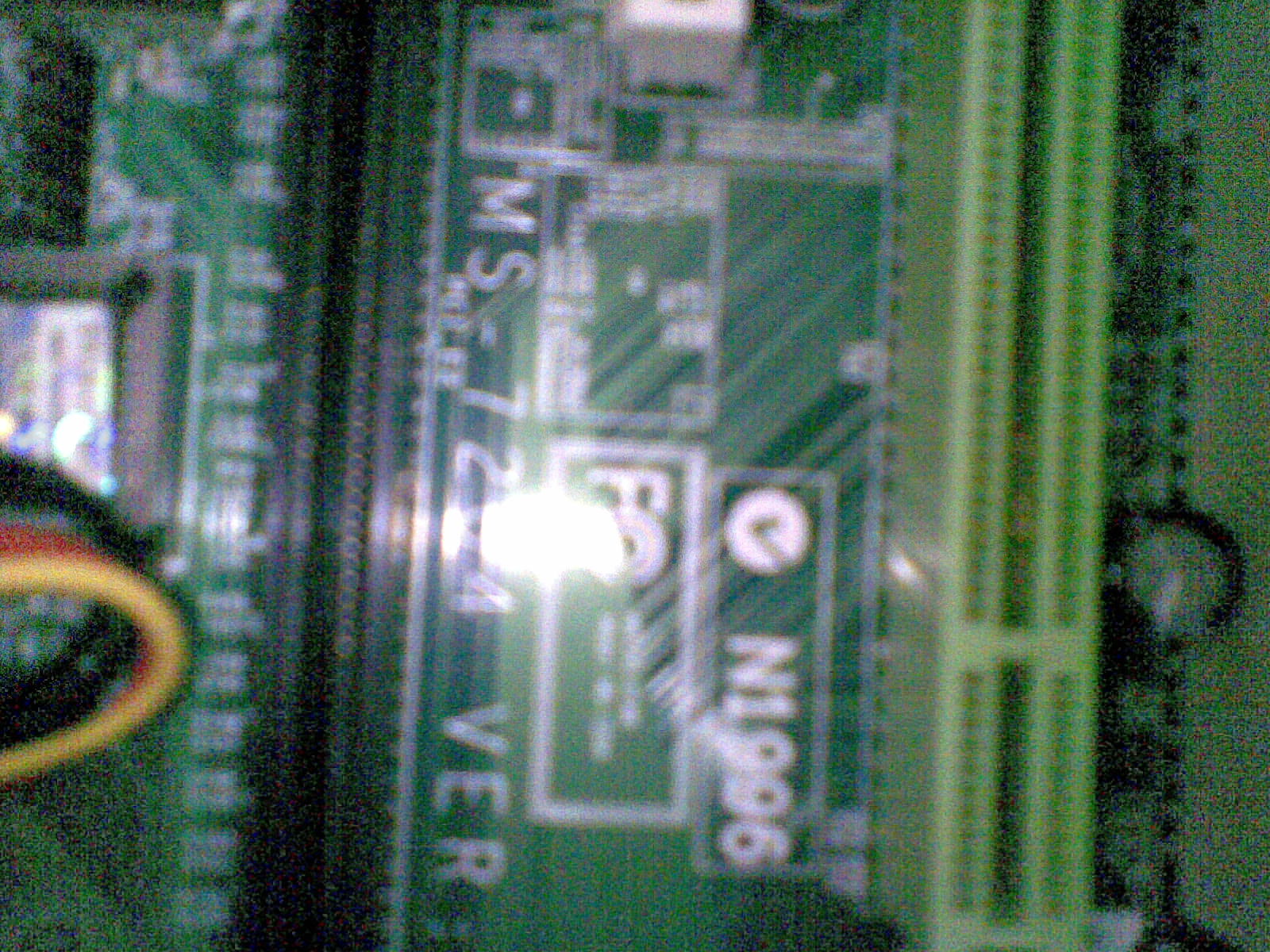

  11. Member SE14man's Avatar
    Jul 2005
    Queensland
    Thanks for all the replies guys.
    Have attached a number of images i have just taken with a camera.
    It is a Medion PC MT 8
    Thanks again for your replies.

    Is there something you can check to make sure that you have a Core 2 Duo? Is there legible printing on the CPU under the thermal paste?
    Going by the the specs listed in the motherboard manual you linked to, a Core 2 Duo might not work with that motherboard. The manual says it supports "Intel® Pentium 4/ Celeron D Prescott LGA775 processors (Prescott and Smithfield) in LGA775 package". While a Core 2 Duo CPU uses socket LGA775, the BIOS and other components on an OEM motherboard built for the other processors might not allow one to be installed.
    Judging by what turned up in some of my searches, it seems like there may be more than one version of the Medion MT8. Are there any other numbers following "MT8".

    old oem motherboard, msi doesn't support it. from the manual - "Supports Intel® Pentium 4/ Celeron D Prescott LGA775 processors (Prescott and Smithfield) in LGA775 package." the chipset should support any 775 dual or quad core, but the bios may not and you won't find any updates at msi.
    shouldn't even have a c2d in it. may be why it won't boot.

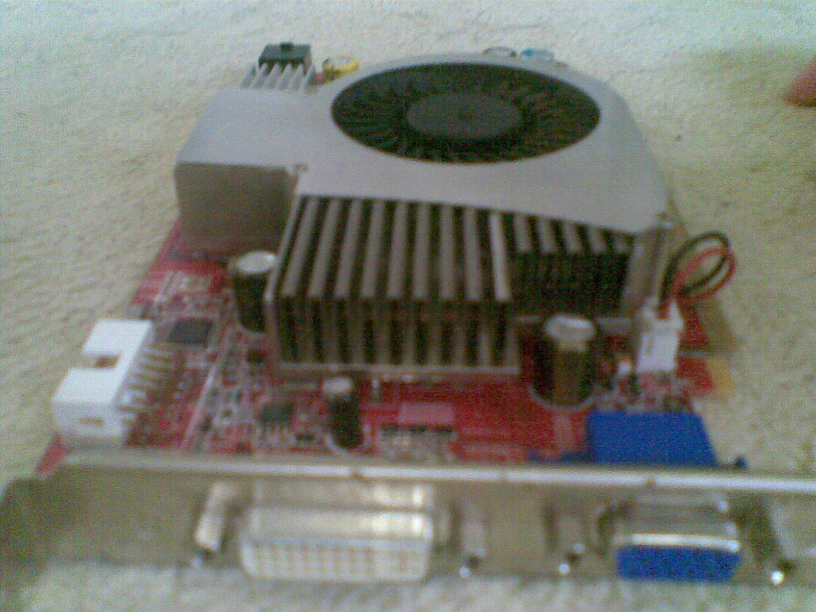

    and where is the hard drive? nothing in the h.d. cage. don't see any ram in the memory slots either? it certainly won't even attempt to boot with no working memory.

    tried a different video card?

    I think I would wash off the CPU and heatsink, though I normally use 99% isopropyl or denatured alcohol and a couple of paper towels and some Q-tips. Then put on a thin layer of thermal compound and give it one more try. But even with worn out and powdery thermal compound, a CPU should run for a few minutes. I've only had rapid shutdown when the heatsink was so loose that it was just hanging there.
    I have seen working CPUs with some blackening on the surface, but that's not good. Don't pull out the CPU unless you have to as they generally have many tiny pins that are easily bent and very difficult to straighten.

    It's kind to hard to tell, but on the close-up of the CPU with old, gray thermal grease on it... looks like the grease overflowed and ran down onto the mounting wafer (?). I can see the central part outlined where the heatsink was mounted, and a ridge buildup of grease around the outside perimiter. It may just be the photo, but it looks like way too much grease was used and overflowed. If this is the case, that will cause what you are experiencing also.

  18. That heat sink looks like it may have been part of a liquid cooling system. If it was liquid cooled you are missing many components. Also, if it was liquid cooled there is a good chance the BIOS has been tweaked to boost the clock speed and voltage of teh CPU.
