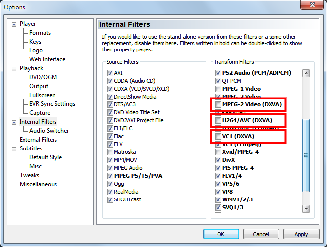

  6. Be sure you have the DXVA decoders enabled in MPCHC.
  7. should check or uncheck it?
  8. Put checkmarks in them. I don't use them because some files don't play properly via DXVA and my CPU is fast enough. You have to exit MPCHC and restart it for the change to take effect.

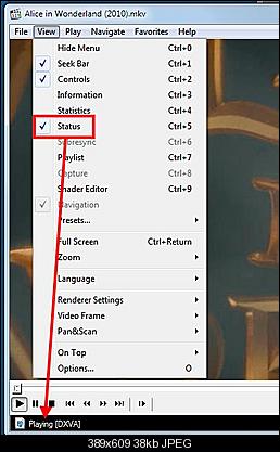

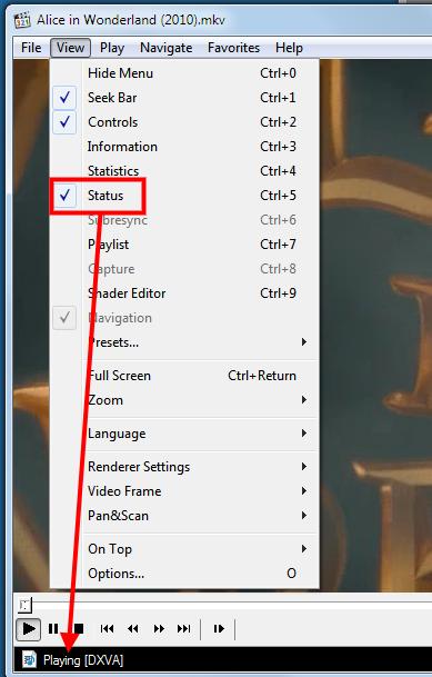

    When it's working you should be able to see DXVA on the status line:
