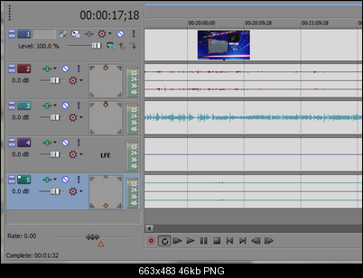

    When you import raw PCM files into a project you have all positioned in the center and it is your job to place the tracks in the sound field.
    But if you import an existing AC3 5.1 file (e.g. this TV commercial) the front LR and Center track will be positioned to the front and the surrounds in the back. The LR and surrounds load as stereo pairs.
