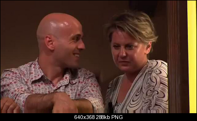

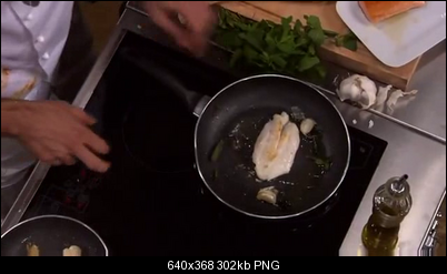

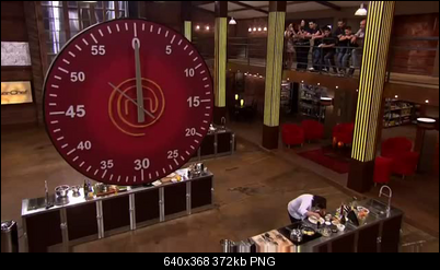

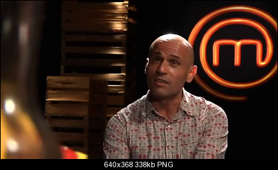

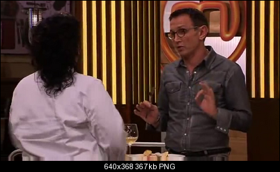

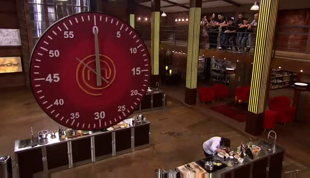

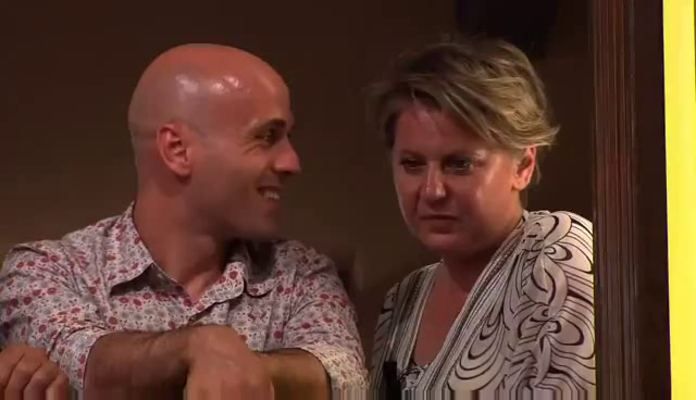

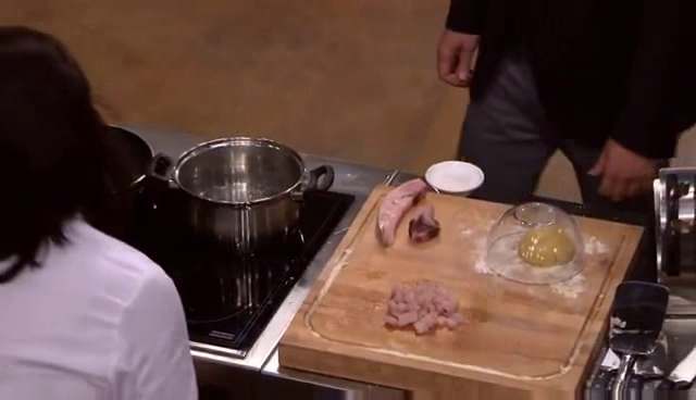

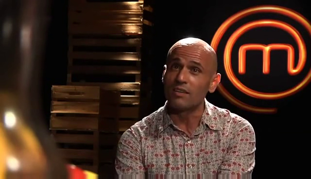

    Hello everybody.
    The videos I'm encoding in XVID present a distorted area at the bottom:
ID:	10007Click image for larger version
ID:	10008Click image for larger version
ID:	10009Click image for larger version
ID:	10010Click image for larger version
ID:	10011Click image for larger version
    Suggestions on how to troubleshoot this?
    Davide
  2. What software or player are you using to take screenshots?
    If you open the xvid encoded video in vdub, are the distortions still there?
    What about another player like VLC ?
    What is the source, and how are you encoding to xvid?
    Feb 2011
    Italy
    -Screeshots taken using VLC
    -If I open encoded videos in VDub the distortions are still there
    -Source files are .FLV files off Youtube. Source files are ok, they present no distortion at the bottom
    -I'm encoding with VirtualDub and XviD codec "XviD Home" Profile
  4. I think the 8 pixels are normally not seen by some decoders (some codecs internally pad to mod16 dimensions) , so it depends how you are opening them in vdub, and what decoder you are using
    You can probably crop them out for 640x360 instead of 640x368
    Feb 2011
    Italy
    Oh, yep, they do present the distortion when opened in VDub, so it is not an encoding problem, it is a VDub importing one I guess there's no way to fix this since it's FLV import pluging related
    Davide
  6. Because VLC might be using a different decoder than whatever you are using in vdub.
    Those 8 pixels are not normally displayed . Another example is often HD footage is 1920x1080 , but actually internally padded to 1920x1088. On display, most decoder will crop the 8 pixels on display, so you only see 1920x1080
    What does mediainfo (view=>text) say about the flv ?
    How are you opening flv in vdub ? what decoder ?

  8. Not sure of better import plugin, but it's a simple fix, just add the crop filter
    Or load it another way, maybe through avisynth, or try playing with different decoder

  10. Hello,
    I face the same problem while playing the converted m4v file in PotPlayer v.1.6.53254 but not in VLC.
    Has it something to do with settings in PotPlayer?
    I don't mess with default settings except for speaker configuration or Subtitle font.
    Please help and share.
    Thanks.
    Aug 2013
    Central Germany
    The reason is probably that your height is not macroblock aligned, means, not a multiple of 16. Decoders should have cropped off this part, poisondeathray already mentioned the quite notorious similarity for 1080 HD resolution.
