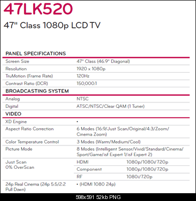

    The TV seems to be capable of the following input on HDMI
    1280x720p/59.94 implied
    1920x1080i/29.97 implied
    1920x1080p/24p (24p "real Cinema" 5-5)
    1920x1080p/frame rate spec missing
    While the TV specs were sketchy, I suspect the issues are with the computers.

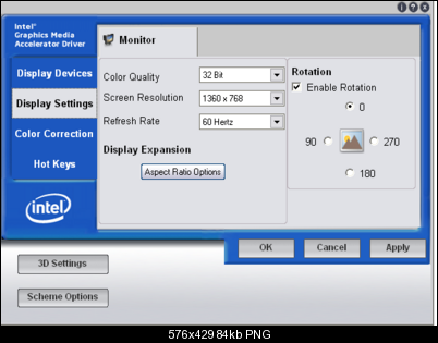

    Try to find a link to the manual for your specific computer model. The manual should explain display settings. In most cases, a right click on the desktop brings up the display menu as an option. You can also find it in Start-Control Panel-Hardware and Sound.
    The exact menu differs by display chipset. I've got an older XP computer with Intel GMA chipset. The Display Settings window looks like this

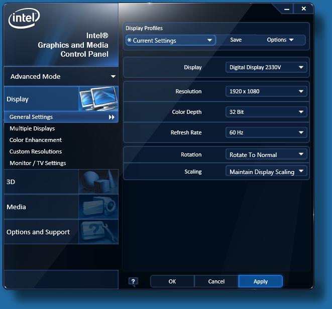

  12. Umm, it says "Intel HD Graphics", more specific than that I'm not sure. I can access the display settings; but once there, resolution seems to be the only thing it's allowing you to mess around with.

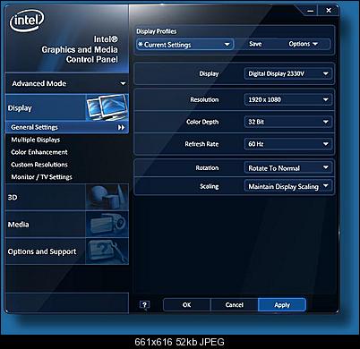

  13. Your i3 or i5 CPU has a built in graphics device. You probably see this config dialog (from my i5 2500K system):
    But unlike on my Nvidia system which is hooked to an HDTV, there are no interlaced settings.
  14. Yeah, that's what I see. So there's nothing I can do?
  15. As noted earlier, I don't know if the lack of interlaced options is because the driver doesn't support interlaced output, or if it's because the applet is hiding them because I don't have a TV hooked up. Look for interlace, 30i, 60i, HDTV, or similar settings.

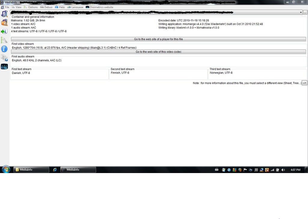

  18. jagabo: The jerkiness is not nearly as bad as it is in the video with the circles. The jerkiness I'm referring to occurs mostly with medium shots; i.e. with the camera 10-15 feet away. When the person makes quick movements, for instance with their head or their hands, slow motion takes over for a split second, producing an effect of jerkiness. Something similar does occasionally also occur to the whole shot during long distance panning shots. When the camera is mostly stable, however, there is no jerkiness in long distance shots, even when there is a great deal movement as in a car chase etc. Closeups are also perfect most of time.
    poisondeathray: Even with the tru-motion disabled, there remains a major difference between what's on the laptop screen and what's on the TV screen.
    edDV:
    Laptop model #: Toshia Satellite L755 PSK1WC - 06MO1S
    Quickly, I can tell you that videos shot on a digital camera have no motion problems. Neither do AVIs.

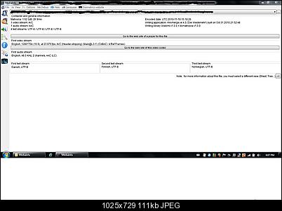

    I'm not sure this is what you're looking for, but here's basic mediainfo information for an mkv file. For what it's worth, all mkv files have the same motion problems, not just this one. (I have no idea if I uploaded that screenshot properly)
