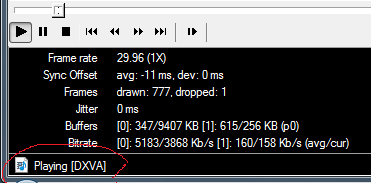

    Try MPCHC player with DXVA enabled*. This will apply hardware deinterlacing from your display card. Alternative software only deinterlace uses Yadif. These look much better than blend deinterlace to me.
    * Experiment with Playback - Output set to EVR modes.

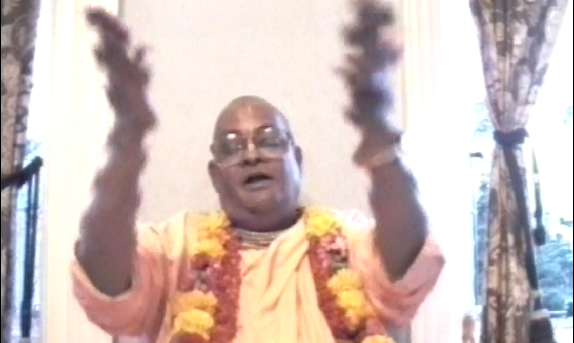

    So I'm rendering on a laptop Samsung RF711, i72820QM processor, 8gb mem. NVidia GeForce GT 540M graphics. Software Vegas Pro 11. Input material AVI, lower field first, 25fps PAL. Rendering DVD Architect PAL video stream, constant bitrate 6000, other settings unchanged.
    Here is the example of the rendered file.
Name:	Lff render.png

    That would be the result for noisy un-timebase corrected source in high motion. TBC needed.

    No, that is improper resizing of interlaced video.
    Srivas, post a short sample of your video.

    Jagabo, you're right!
    I did some cropping to make it look nice. When I switched back to original size, rendered it as it is, no problem! But there IS a problem, because I still want to resize it. Why can't Vegas handle the resizing? What to do next?
    I added the clip, same avi, no re-encoding.
  17. Your video is interlaced, bottom field first, DV AVI. If you're making a DVD, mask instead of resizing, leave it as interlaced. Make sure Vegas recognizes the file is interlaced and BFF. I don't use Vegas but I think you can right click on the video in the timeline to get a source properties dialog. If you're making a video for online distribution you probably want to deinterlace and crop the borders. I recommend you leave at least mod 8 frame dimensions, even better, mod 16.

  19. Well, the wavy arms on a normal background were a dead giveaway.
