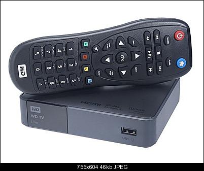

  5. Is it this unit ? This is WDTV Live with latest firmware that has more problems with playback of different formats. That needs to be addressed.

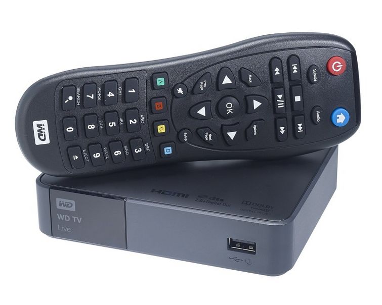

    This is older WDTV Live and WDTV Live Plus (+ Netflix feature):
    WD is not making it easy, they give a new product the same name as the old one.
