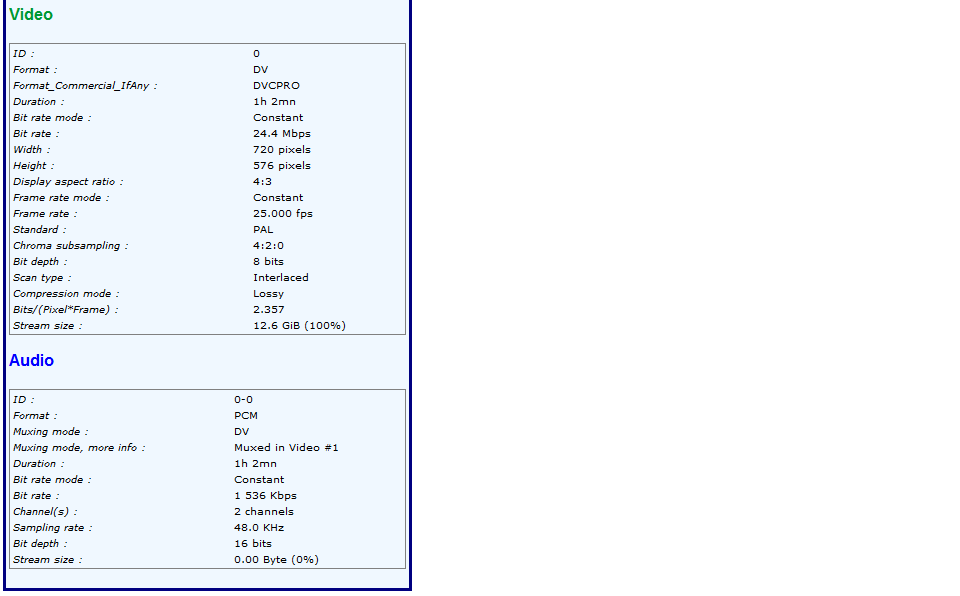

    thanks for the reply, I tried AoA and it really extracted fast, but same problem remains. Video is 1:02 but extracted audio is 0:41 minutes. Here are my audio settings from Super, maybe it helps.

  5. The picture provided shows them both to be the same length, so that's from the source file? If so, I don't know why you'd have trouble extracting that, but then I've never really worked with DV files. Next, as jman98 also suggested, I'd try VDub.
