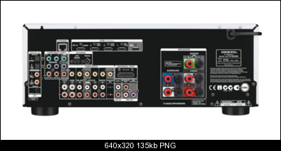

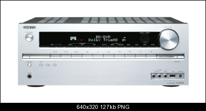

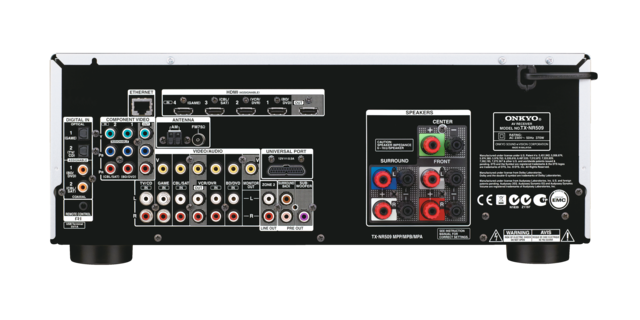

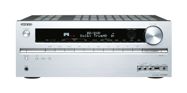

    I'm looking at an Onkyo TX-NR509. But can i use some old speakers i got from a sony HiFi that had some nude wires on the end as connectors?

  9. Most AV receivers have binding post for bare wires. In addition to 5.1 receivers you'll see 6.1, and 7.1. Many will have A/B switching to allow connecting alternate speakers. The more expensive receivers will have more sound effect options, more power, and less distortion.

  10. I see, and if they don't have these connectors, is there a way to connect the bare wires to connectors such as the ones found on nr-509 i posted above?
    They often have hybrid connectors for other types of plugs but they always have connectors for bare speaker wire.
