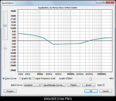

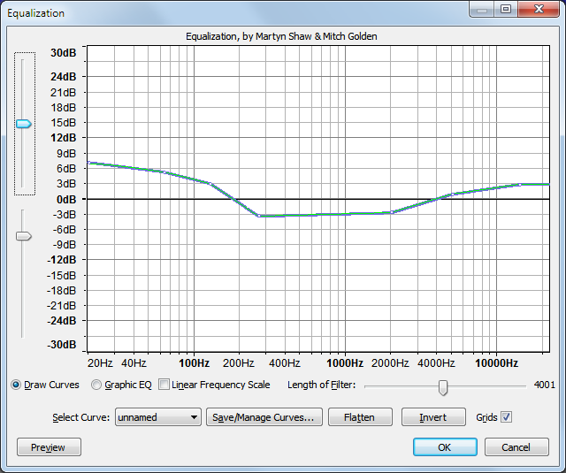

  5. I think what you're really looking for is a bass and trebble boost on sample 1 (always start with the higher qulaity source). I assume you don't want to duplicate the high frequency cuttoff. The computer I'm on right now has crappy speakers but try this in audacity. Then use the equalizer with a U shaped curve to boost frequencies below about 400 Hz, decrease the mid range, and boost above about 4000 Hz:
    and adjust the bass boost to your liking. You can use the Analyze -> Plot Spectrum tool to compare spectrums.
