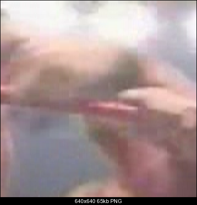

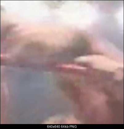

    The blocking isn't there after the script. It isn't caused by the script. It's caused by your MPEG encoder. For example, from field 101 (bob()):
    After the script, before encoding (4x nearest neighbor enlargement):
    After MPEG encoding (4x nearest neighbor enlargement):

  28. The more noise and motion (the more pixels change from frame to frame) you have in a video the more macroblock artifacts you will get in MPEG encoding.
    Even with your updated script I see very little blocking after filtering, before encoding. Post a sample PNG frame that shows the blocking (before encoding) you are talking about. At least give a frame number.

    I don't see any significant blocking after the script.
