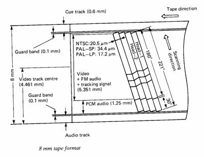

    I have successfully trimmed 8 mm tape. All it takes is magnification and a steady hand. You have a whole 0.6 mm to play with; as you can see, two bands are reserved for cues and linear audio, although neither were implemented in consumer devices.
