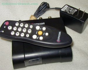

    Most cable companies will give you or rent you a DTA that outputs NTSC Ch 3/4.
