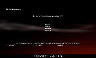

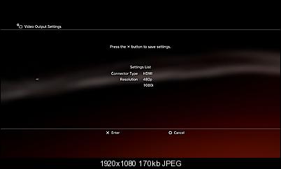

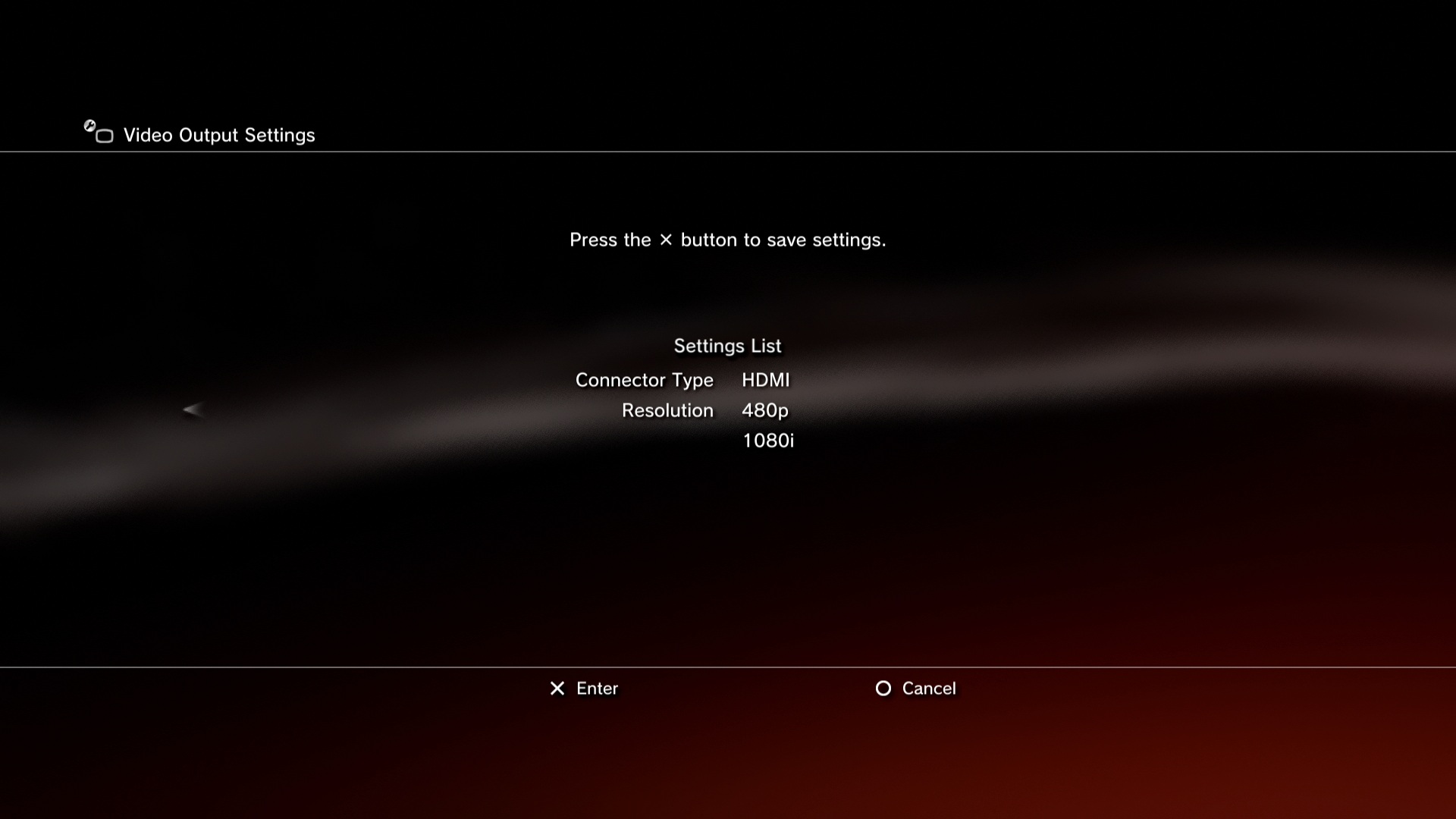

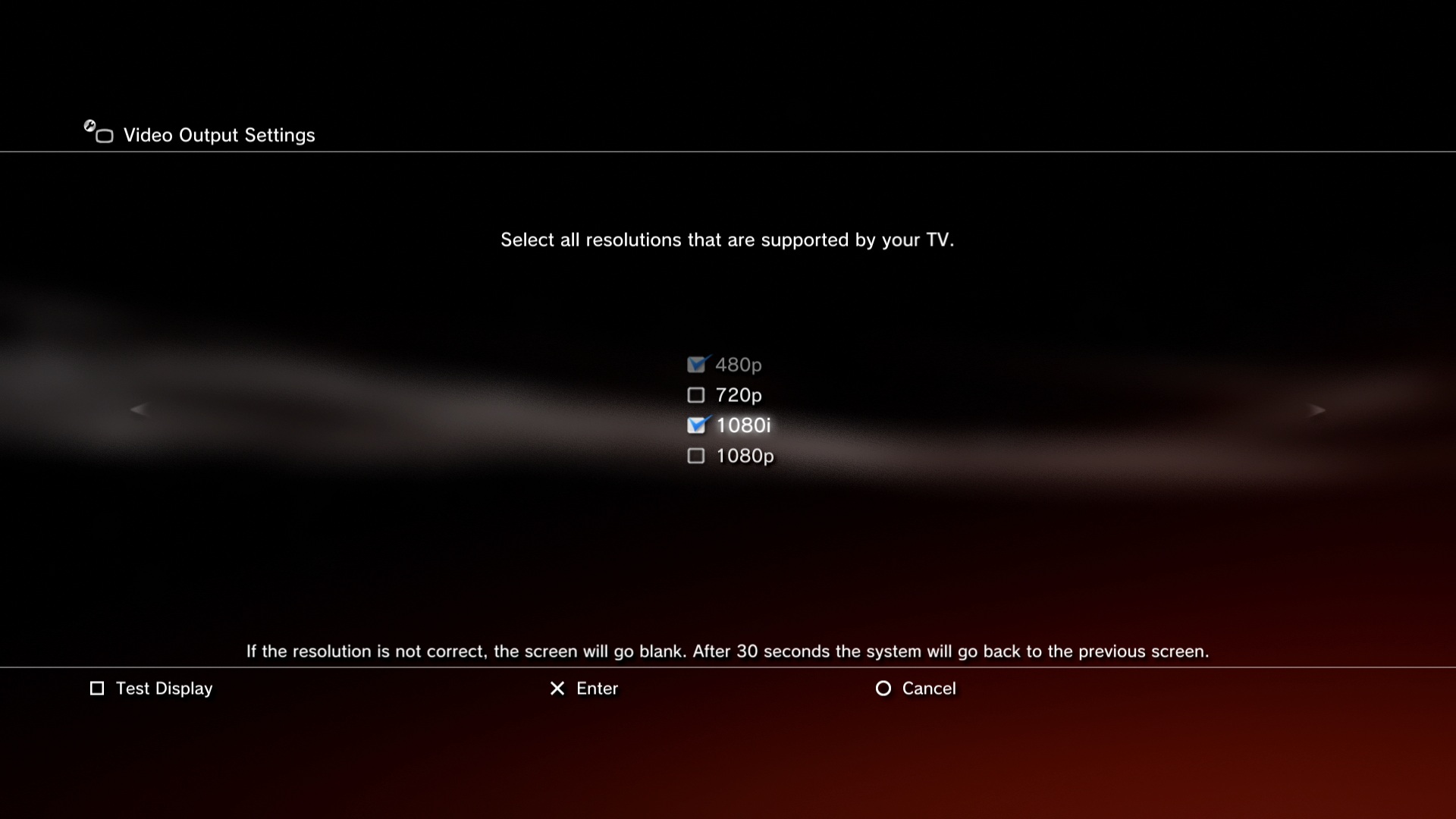

  15. Formerly 'vaporeon800' Brad's Avatar
    Apr 2001
    Vancouver, Canada
    Originally Posted by Lotus Prince View Post
    I have the PS3 set to 1080i (the maximum that my HD PVR will allow).
    My point is that most games run at 720p. If you only have 480i/p and 1080i checkmarked in the PS3's output settings, any game that doesn't offer 1080 output is going to scale itself down to 480 not scale itself up to 1080i.
    Like this...
    PS3 menus at 1080i

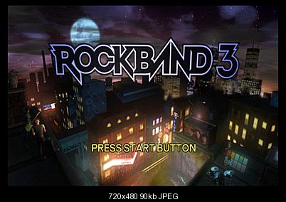

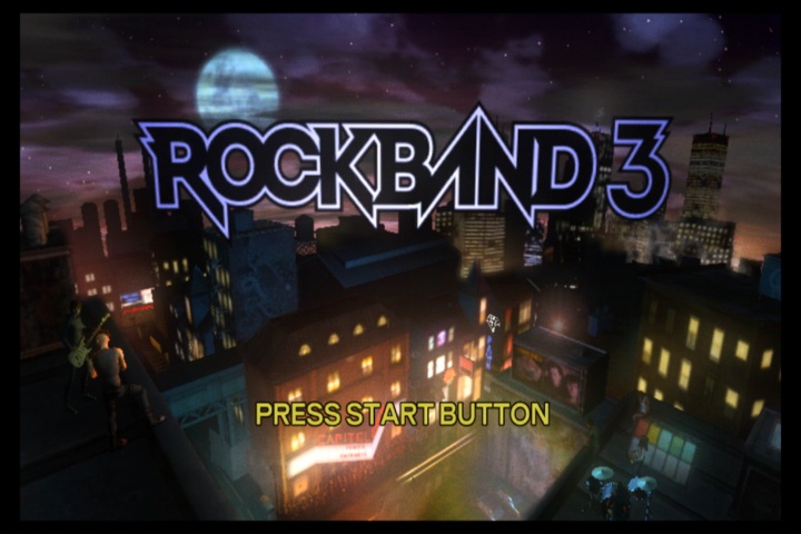

    As soon as I load my 480p/720p game (the resolutions are listed on the back of the box), the connection resyncs and the PS3 outputs at 480p.
    This is by design. Change your workflow to 720p and see what happens.
  16. Originally Posted by vaporeon800 View Post
    No WAY. I never even thought of that! For some reason, I assumed that by setting it to 1080i, it'd include everything lower. I actually had not set it to 720p, and guess what - it works!
    Thank you so much; you just saved me one hundred dollars.
    Also, thank you to everyone on this thread for your prompt and polite responses. Also, I feel like a total goofball now. Still, all's well that ends well!
